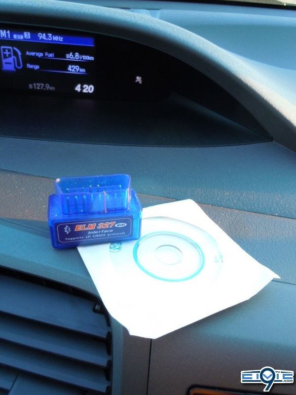

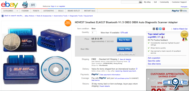

Have an Android smartphone, mp3 player or tablet with Android? Check your trouble codes, temperature, throttle angle, engine load, road speed, and many other things with a Bluetooth adapter. First step, purchase an adapter from eBay, and wait a month for it to ship on the slow boat.

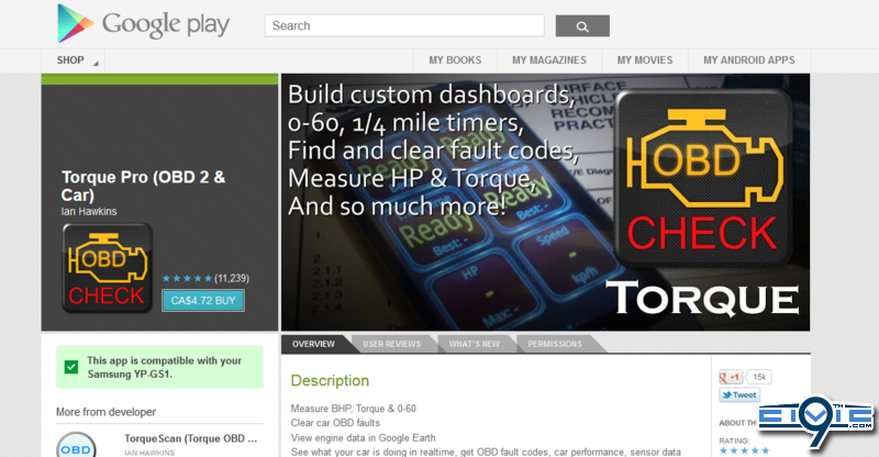

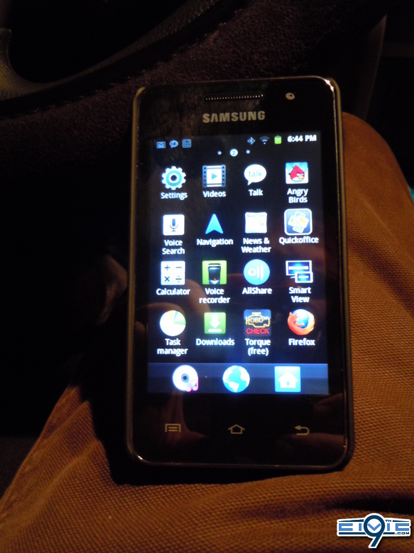

Download "Torque" from Google Play. I installed the free app, there is also a paid "Torque Pro" as well with more functions.

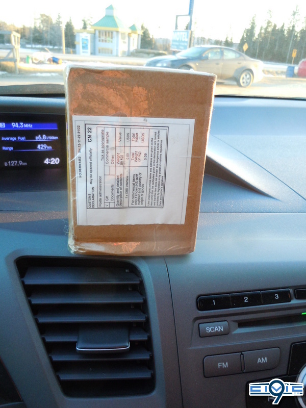

Open box.

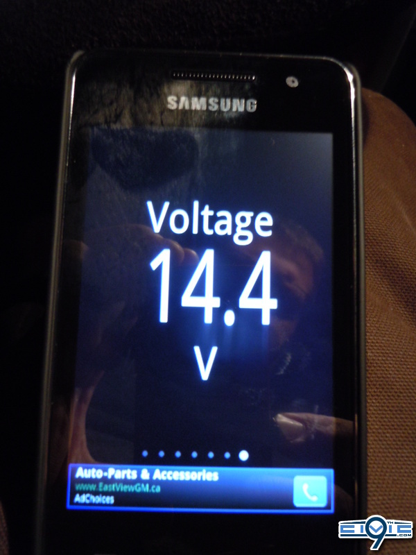

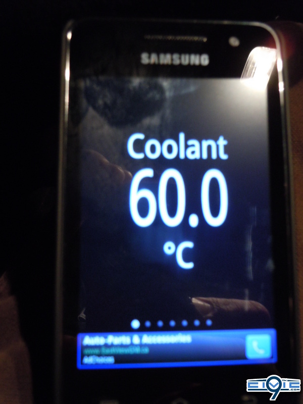

Choose what format you want to display ( graph, dial, or display ) and what sensors to show data from.

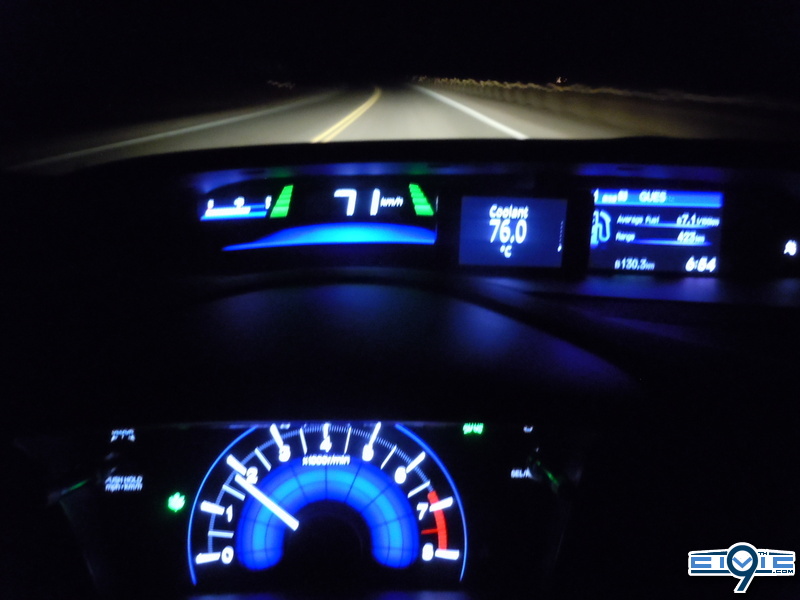

Note: it's dangerous to take photos while driving, so make sure you have an assistant to snap pictures for you.

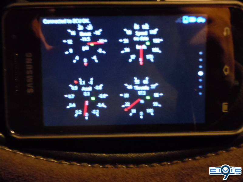

Pretty cool! Is it limited to one sensor reading at a time or can you set up a grid?
Yes, you can have a few at a time, but they are smaller. Sorry for the blurry pictures, it's hard to take pictures without a flash so they show up.
I did this along time ago. I actually got the 'Torque Pro' version with my elm327. Works great and i basically only bought it for the temperature readings, but it has a lot of other useful info.
