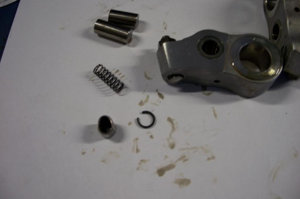

Here's the status report. Since the valve was not bent they were recommended to replace the rocker arm. It says they say a "Vtec piston" hanging out the far left rocker arm that wedged against the lower cam holder, holding the valve open.
The car has power through the entire power band now (doesn't lose power/stumble and then pick back up)
What I've really noticed was that the entire valve train is more quite. Before even when I bought the car brand new with 4 miles on it, I remember noticing a loud valve train. The 2 cars I had to choose from sounded exactly the same along with a few k20 8th gens I've heard so I thought nothing of it. But it is noticbly more quite. I'm heading home now from work to throw the intake back on and see how it does.

So yeah. The locking pin that locks the high lift lobe got wedged in a way to hold the valve open. This is a first for me but I'm glad they took care of ya.
So the intake rocker arm for cylinder 4 was replaced. You're the first user here who's posted about having this happen, but foobird says others have had this on the other forum

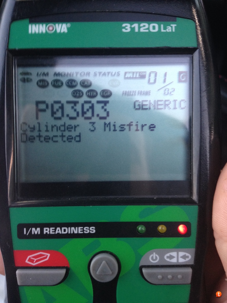

Wonder if I am having same issue!!! Just happened! Car got towed there yeaterday. Car was dying sounded like Subaru and kept dieing on me! So they replaced battery said that was issue 30 minutes drive as same **** read code a local oreilys and this is what it said. My luck it's Friday! No mechanics till Monday! FML!!!! Gonna have to talk to the dealer about this bs!
Car going to dealer in 45 minutes keep you guys posted! Oh and all of m lights are on CEL power steering brake traction control
