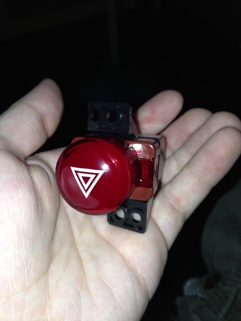

I dont remember the part# on the one I got from team3d but heres a picture..
I have a feeling that you got the one that I got. it's hard to see from your pic, but it looks like it. I will post a pic of mine installed inna few minutes. I just got done installing my ambient lighting kit. PM Team3D and ask where they sourced it from?

WP_20130707_004.jpgWP_20130707_005.jpgWP_20130707_006.jpgWP_20130707_007.jpgWP_20130707_008.jpgWP_20130707_010.jpg Bitter, the switch is definately a right hand drive specific switch. even just changeing the switch cap, the hazard triangle is still up side down. The cap can only install one way. I will post up pics in a minute. Check the switch you buy, the Thai one DOES NOT FIT our cars. I'd be willing to bet that this is the problem HFPSI13 had.

This is what mine looks like in the same orientation of the mounting brackets: (so upside-down from what yours is it looks like?)
Dang I will try to find my bag when I get home but I just installed mine last weekend, and I ordered it from the guy on eBay and it fits perfect. I have a 12 non navi.IMAG0143.jpg
Yup, that's what I am seeing. hopefully we can get a list of the good and bad part numbers. That will make it easier for a vendor like CHH to source, as well as prevent any issues like what has happened to me and others on here.
