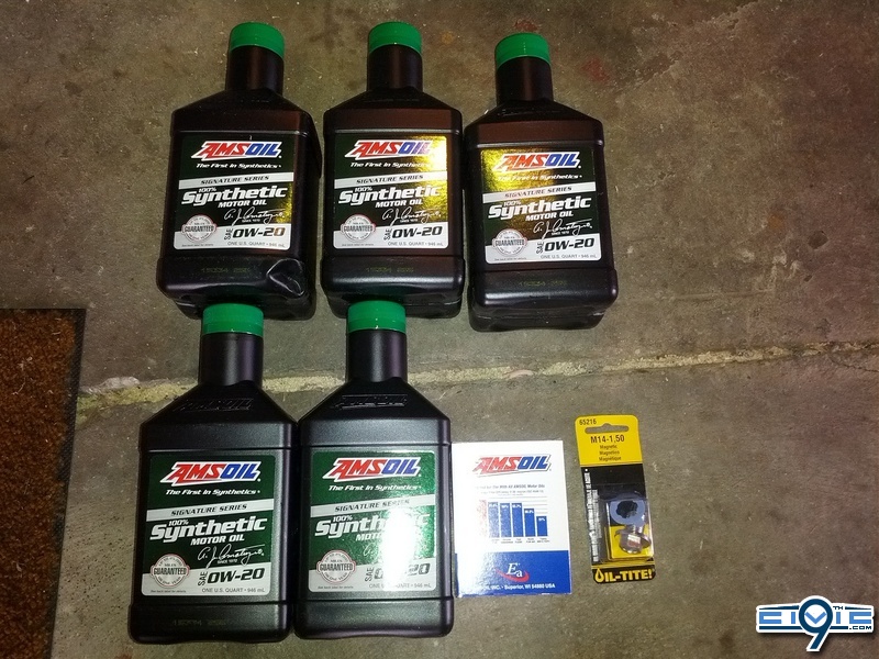

Tools Needed:
Oil filter wrench/remover of your choice
Jack and jack stands or ramps
Oil drain pan
Funnel
17mm socket
Torque wrench
Supplies Needed:
4.4 quarts of 0W-20 oil
Oil filter (part number/size will depend on brand you choose)
Rag
New crush type washer for oil drain pan bolt
Optional:
14x1.5 Magnetic drain bolt/14mm socket (if putting a magnetic drain bolt in)

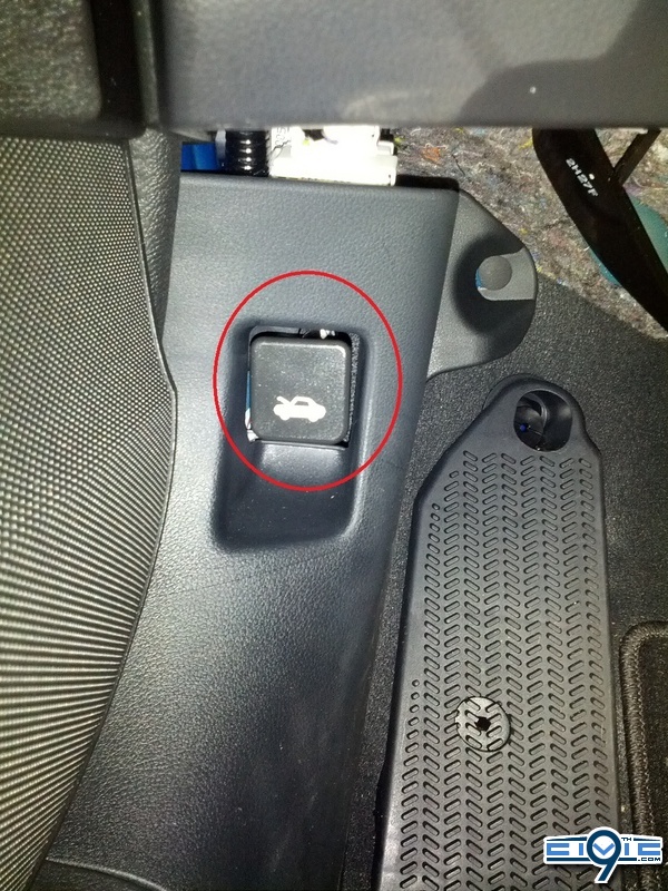

2. Release hood by pulling latch inside the driver’s side door under the dash.

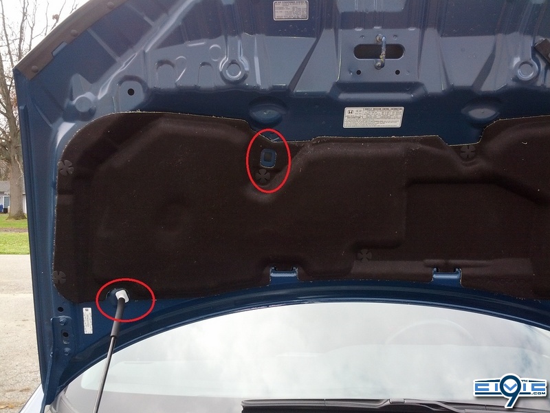

3. Prop up hood by using one of the two locations as shown below.

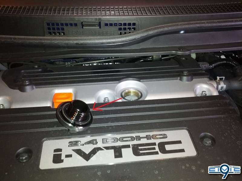

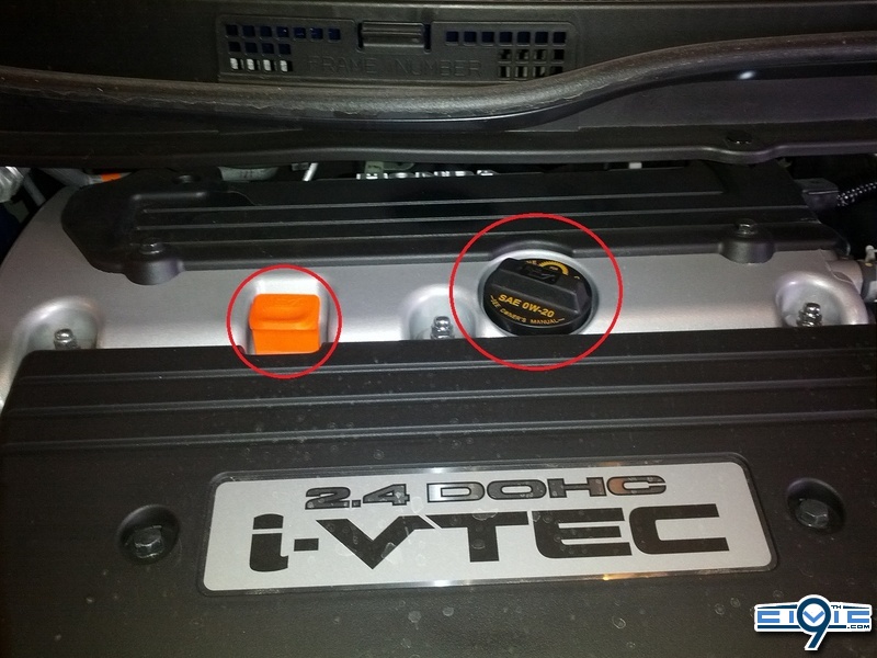

4. Locate oil dipstick (left) and oil filler cap (right).
Remove oil filler cap and set it off to the side.

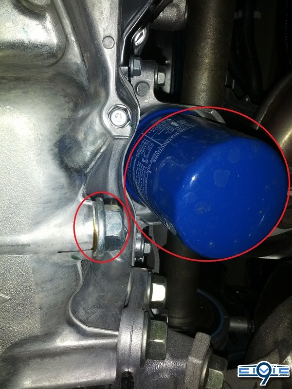

5. Locate the oil drain pan bolt and oil filter.
Place oil drain pan under both the drain plug and filter. Make sure you allot for how far out the oil will arc at first.
6. Loosen (only) the oil drain pan bolt with the 17mm socket. Finish removing the bolt with your fingers. Due to the placement of the oil filter on this engine you will need to wait for the oil to drain first and then put the drain pan bolt back in with a new washer. Do not tighten it all the way right now.

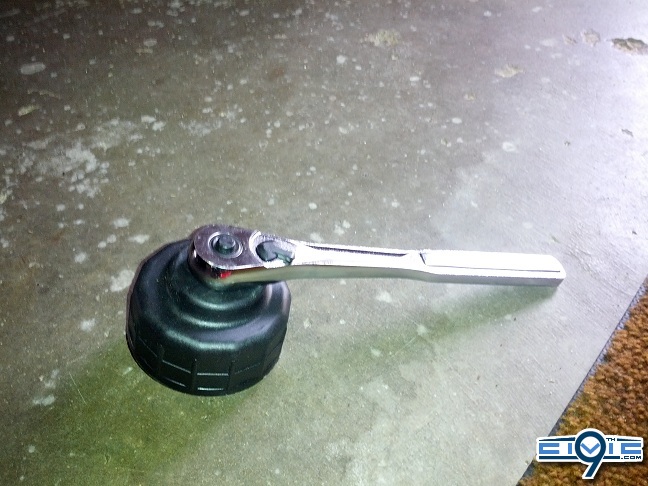

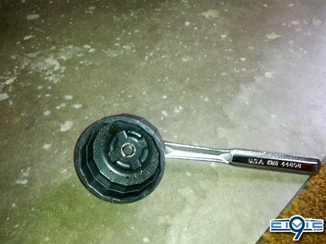

7. Remove the oil filter with the wrench/remover of your choice. Make sure the drain pan is underneath the filter as oil will come out. See pics below for my preference of remover. I find that most traditional wrenches are too small to really grip the small filters used on Civics.

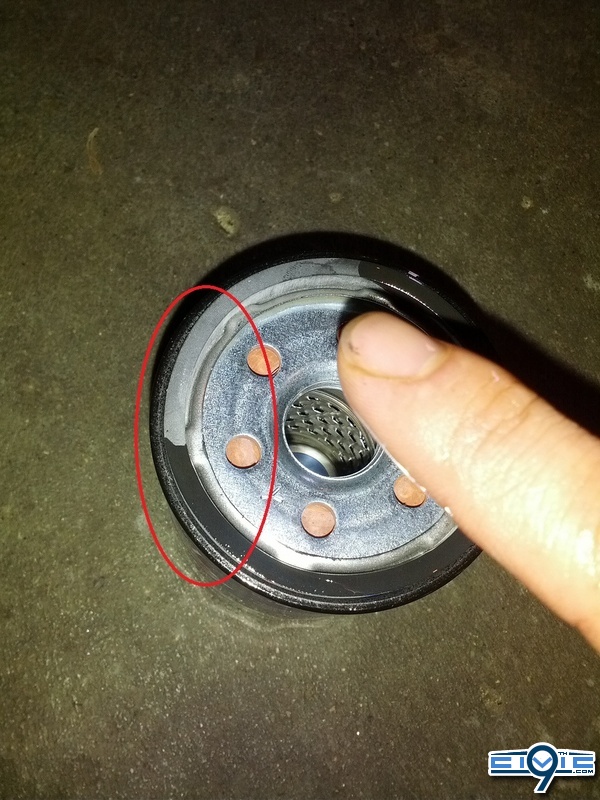

8. Before putting the new oil filter on, make sure you dip your finger in some of the new oil and lube up the ring seal on the filter. I have marked a little section to show the difference with and without oil on the seal. Screw on and tighten by hand.

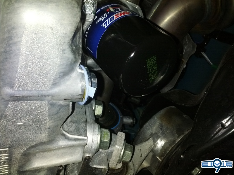

9. Torque the drain pan bolt to 29ft-lbs and the oil filter to 9ft-lbs. (installed parts seen in pic below)

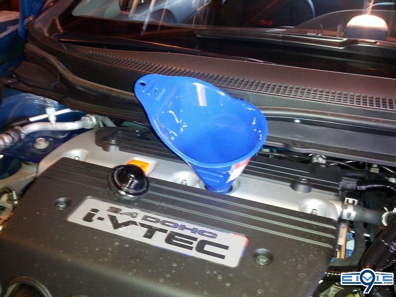

10. Using the funnel, put 4.4 quarts of oil in slowly and put oil filler cap back on when done.

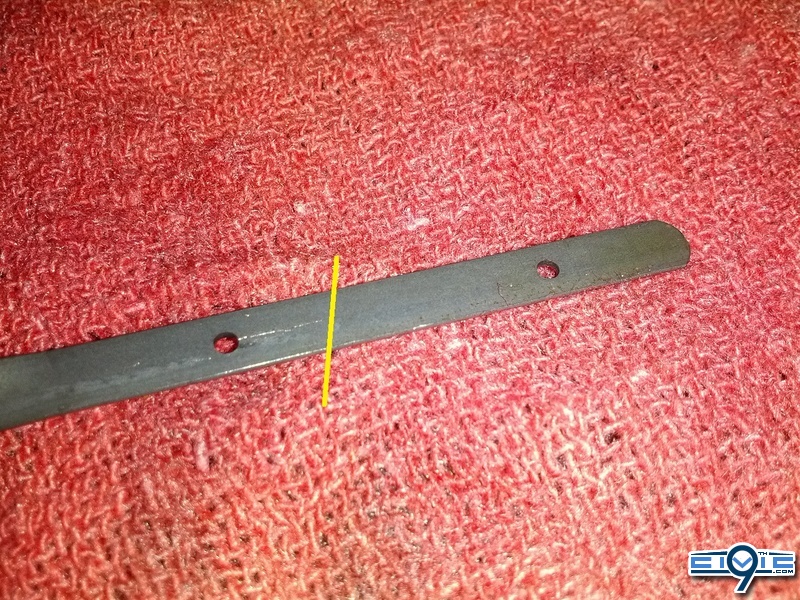

12. Remove the oil dipstick and wipe it off with a rag. Put it back in and take it out again. Now make sure that the level falls between both dots. If not add half a quart or so and check again. When reading the dipstick, make sure that you do not turn it upside down as it will skew the reading. Due to the nature of how thin 0W-20 oil is, it is actually quite hard to see exactly where the level is unless you are in a well lit area. The yellow line shows where my level was.

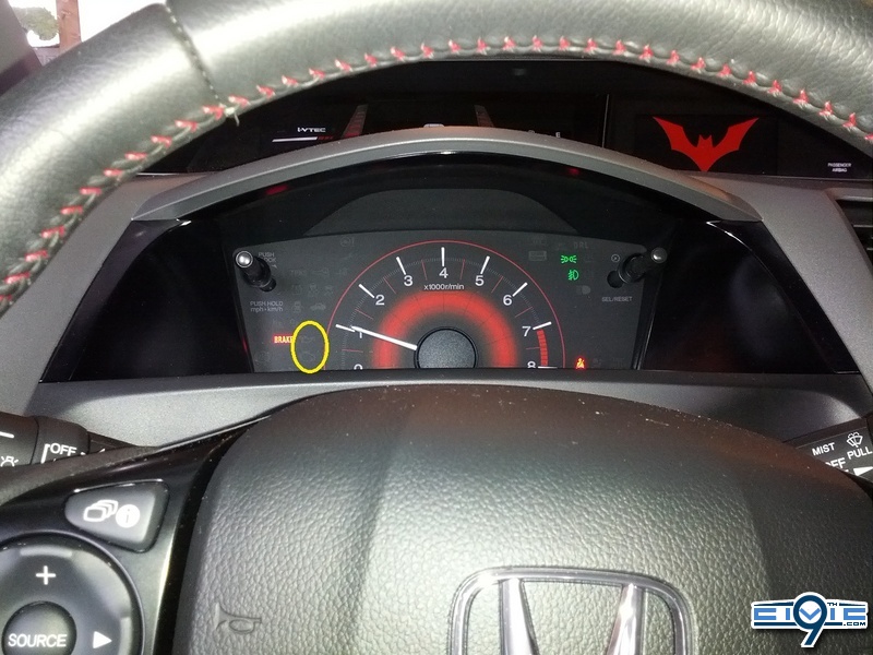

13. Start the car again and check to make sure the oil light does not come on. If they do come on, they would be inside the yellow circle.

I put in a magnetic oil drain pan bolt as a precaution to catch any potential metal shavings that the filter may not catch. You may notice that the washer is also not a crush type as the magnetic drain bolt comes with a plastic type washer. I have never had any problems with the plastic style washer as I have used them in the past. I will change it out with a crush style after the initial change to the magnetic drain bolt, though. The size of the bolt is 14x1.5. The head of the bolt is 14mm and not 17mm like the stock bolt, but the thread size is what is important and does match up.

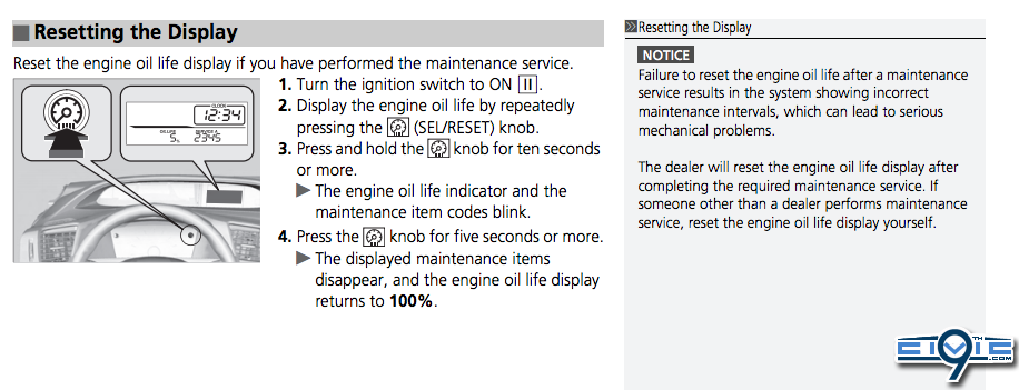

To reset your oil life display :

also, added instructions for resetting the oil life meter at the end of your post.
Good thinking. As I did not have to do that, I didn't even think of it.
SQUIGGY! Im sorry but Im a noob here, I reset my oil life display thru "i-MID" and not SEL/RESET knob is there a difference? Also I used 5w-30 instead 0w-20 because of harsh environment here in vegas! Please reply thanks
If there is another way to reset it, that is news to me. Check it in a few weeks to see if it drops below 100%. If that is the case, you will be fine and have discovered an alternate way of resetting the meter.

Awesome thank you for the link! yeah i guess it's the same
http://oilreset.com/blog/?p=230
Some models might be equipped with a multi information display (MID) in which case the following procedure should be followed:
1) Turn the ignition switch to position II (do not start the engine).
2) Bring up the Vehicle Menu screen by pressing Menu located on the left side of steering wheel.
3) Select Vehicle Information with the (+) button followed by pressing the Source button.
4) Press the Source button again to go to the Maintenance Info screen.
5) Press the Source button to display the Oil Life % Indicator.
6) Select Yes with the (-) button then press the Source button. The indicator will reset to 100%
7) Turn the vehicle off.
