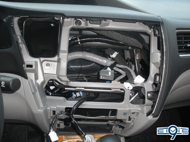

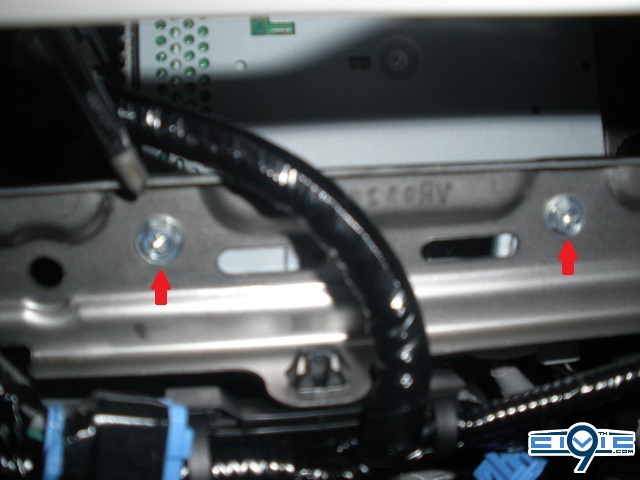

Just took some pictures to guide removal of the 2013 one piece head unit.

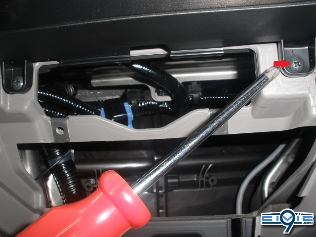

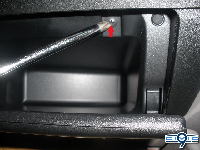

There are 6 screws total. The first two can be found when you open the center compartment. Remove these and pull out the compartment that is being held by clips.
2nd set can be found right behind the compartment that you just pulled out. Unscrew them.

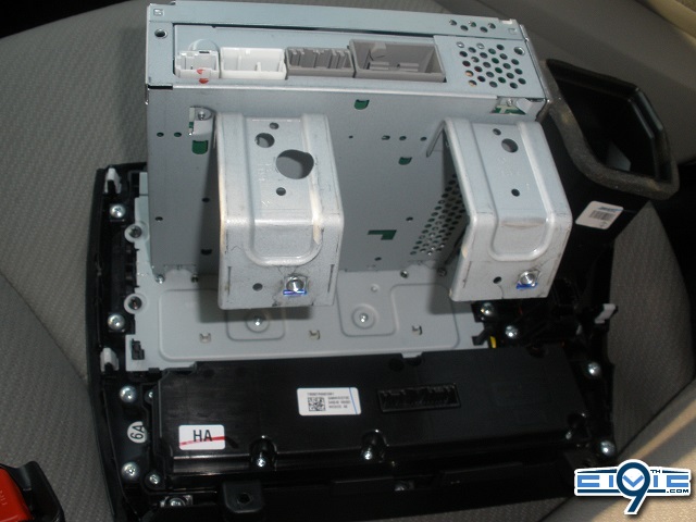

3rd set can be a little difficult to reach as it is inside the compartment that was just removed and located right underneath the HU. These are 8mm scew/bolts and much easier to remove using the 8mm. After you get these off, the HU is held by clips as well and just pulls out.

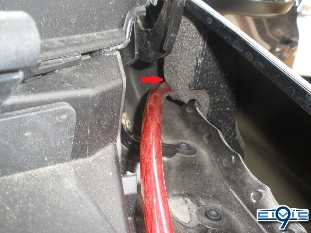

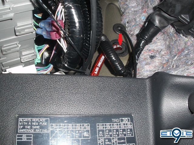

Other pictures shows how I ran the power line from under hood to under dash side panel right above the left foot rest instead of what I've seen others have been running from under hood to side mirror/door.
