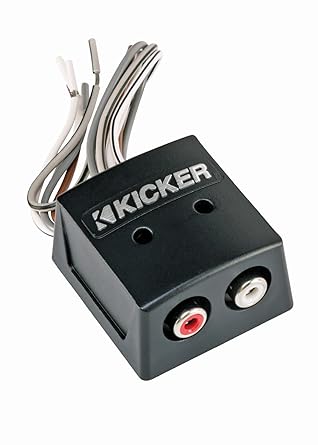

update: Did a dry test run, everything seemed to work ok.
used a kicker line out converter to take the stock subwoofer's signal and put it thru the RCA input on my amplifier.
using the same 'posi' connectors as OP I tied the left & right positive to Green wire and left & right negative to the Red wire. From there it is plug and play, and you can still maintain subwoofer control through the sound settings in the Head Unit.
From there everything else was done as OP directed.
