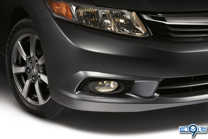

9thcivic 2012+ Civic Sedan Fog Lights Installation DIY
Part# 08V31-TR0-XXX
Application: 2012 Civic 4dr except Si
View: http://youtu.be/S45O8Lu9ao4
2012 Civic 4-Door Fog Lights
Full PDF Installation Document Below:
http://9thcivic.com/forum/pages/2012-Civic-4-Door-Fog-Lights/
My car's an LX and doesn't have the actual fog light activation switch. Can that switch that's part of the headlight be purchased?

So I saw a thread where someone said you could cut the LX bumper on the 12 civic instead of purchasing a new bumper. Apparently there are lines on the inside of the bumper that show where the fogs go. Anyone know if this true?
  • Thread starter
  • #8
did you watch the video? At like 1:18 into the video it shows them taking the blanks out
Yes, you have to cut the LX bumper and yes, the lines are marked on the inside of the bumper. The College Hills Honda video is not an LX and that's why there are blanks and no cutting. Pauly's DIY is for the LX.
Thanks for the info. I'll definitely be looking at pauly's diy when I decide to get some fogs for my car.
