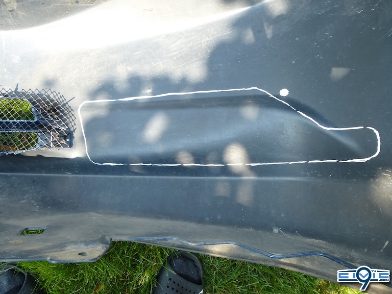

    Step 2: Find markings on inside of bumper. I used a White Out pen to trace lines so i could see them better. You need to cut between the two indicated lines, so I just put my white line between the two. There is also a circle outside of the lines which indicates where you will need to drill a hole.
