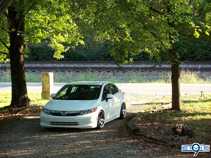

welcome to the site... here are some pics I dug up below -
17x9+35 on 8th gen skunk2 coils ^^

I had 17x9 +35 with road magnets...
if you have instagram you can see it user name is japspecjohn
The 1st pic- he sold his car...so I don't really know any other specifics besides him using 8th gen skunk2 coils. Sorry
JOhn That looks great! Did you experience any rubbing or did you have to mod the fenders? Lastly do you remember what size tire you were running and was there any specific camber settings needed?
webby Thanks for all the help man!
Welcome to the best site ever!! And the best and most helpful moderator Webby! And to answer your questions depends what tire size your going with because I'm running the same drop as in my build list which is about a 3 in drop and at the time I was running 205-40 series tires so no rubbing or modding the fenders, I switched it up and I'm using 215-45 series at the same height and I'm rubbing just a little on turns. I also have skunk2 rear camber set to match the stock camber arms. Hope this helps ;)
