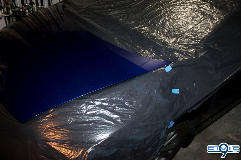

-When the car is nice and cool, cover up the exposed areas that you don't want to get sprayed on using the garbage bags. Keep the hood ajar. I cut the two bags so that they became large sheets. I then cut one bag into two equal sheets. Use the Painter's tape to hold the sheets in tact.
The large sheet was used to cover the entire top section above the hood.
And the two small sheets are used to cover the front end and the front fenders. The two sheets are sitting diagonally, like shown in the pic below.
Make sure the sheets tuck underneath and are barely touching the hood.

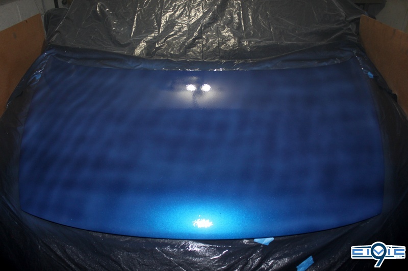

The sprayed surface should look like this:

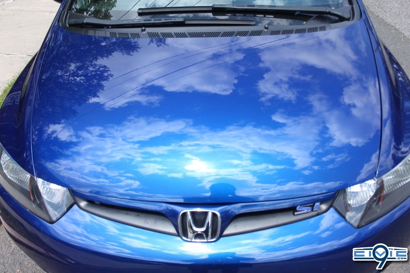

-Wax the treated area and your car's hood (Or whatever you spray) is now protected.
