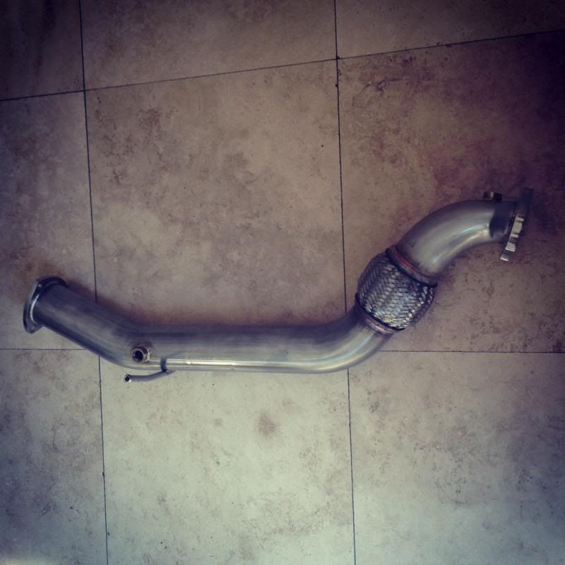

Full Race 3" downpipe

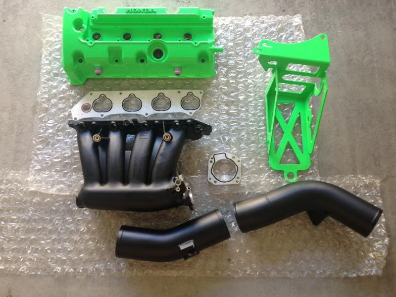

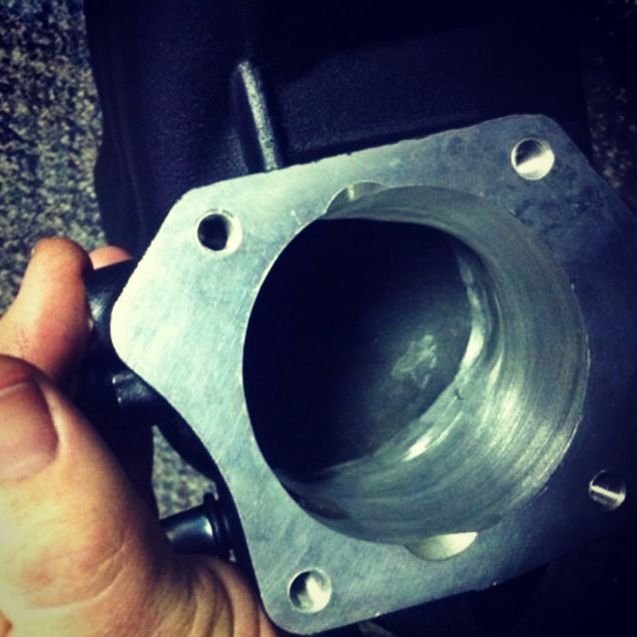

Ported 70mm for ZDX TB
All back from the powder coater

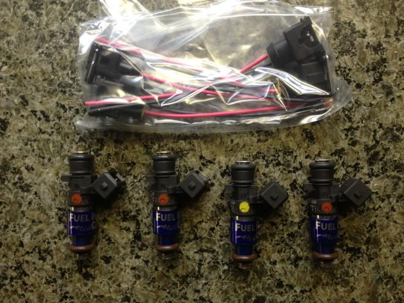

FIC 1100cc injectors perfect for E85

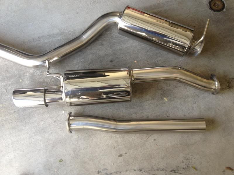

Full Race 3" cat back

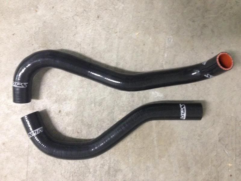

HPS Radiator hoses

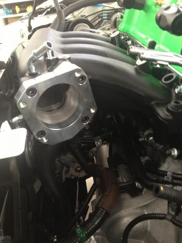

Mid install shot of the ported manifold

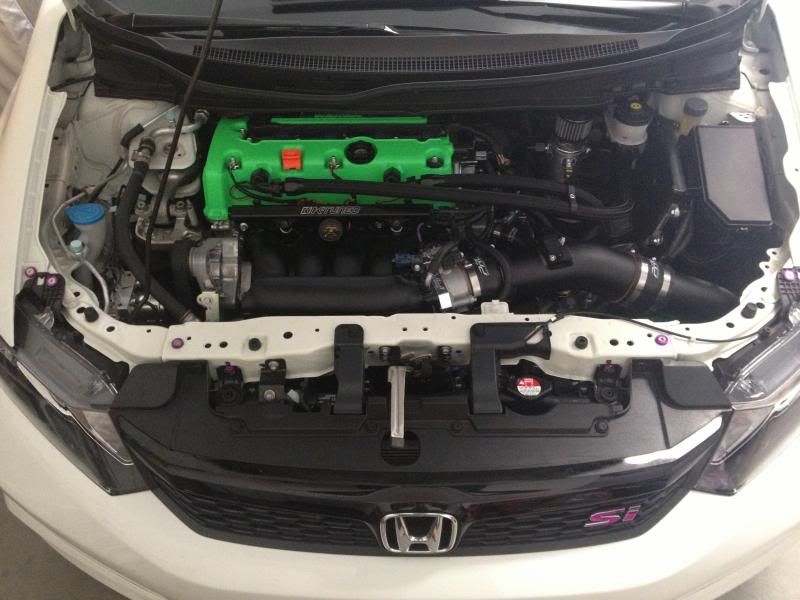

All installed and ready for some tuning

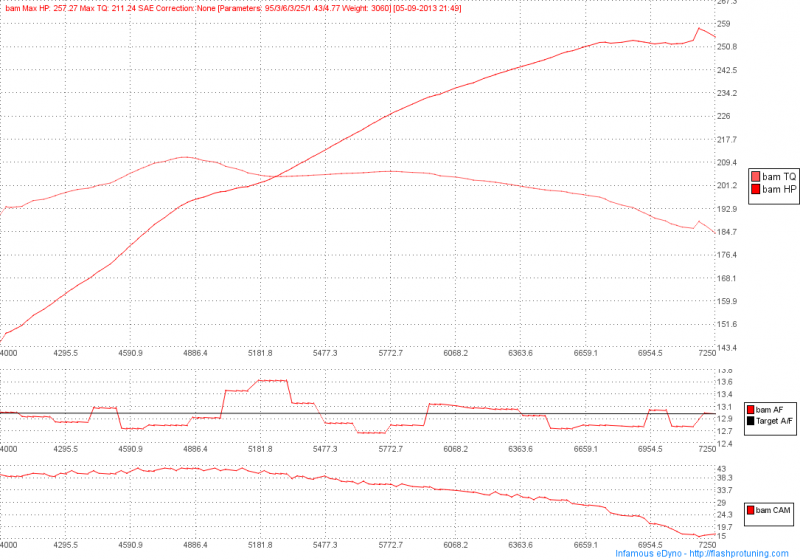

Vits edyno results 257whp 211tq on 91 octane

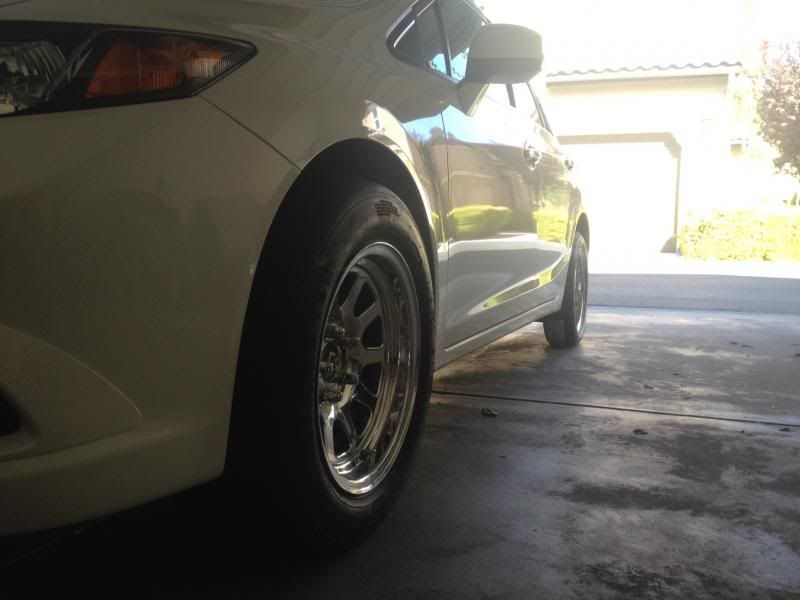

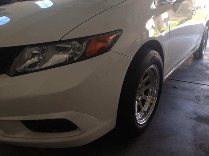

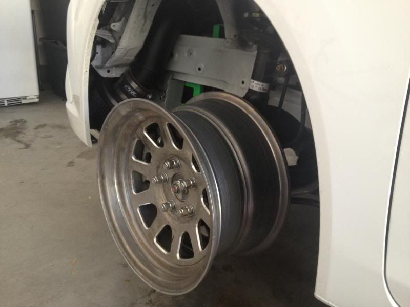

Test fitment for the 15" drag wheels, every bit counts

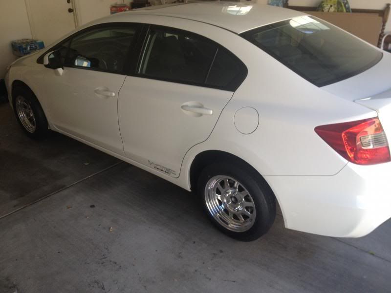

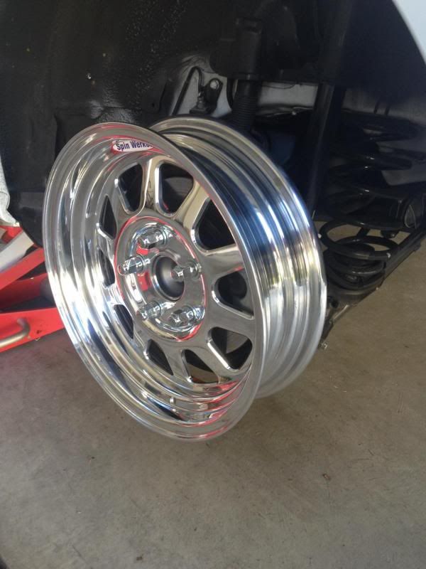

Back from Polish and all welded up, rear wheels fit great
Wow, that's a very nice power gain. I'm looking forward to this build. Are the IM runners ported too? It's amazing how a K24 can almost hit 260whp without aftermarket cams.
And welcome to the site.
I'm guessing the ported zdx made some gains, because others have basically identical...? setups and not seeing those numbers. Interesting

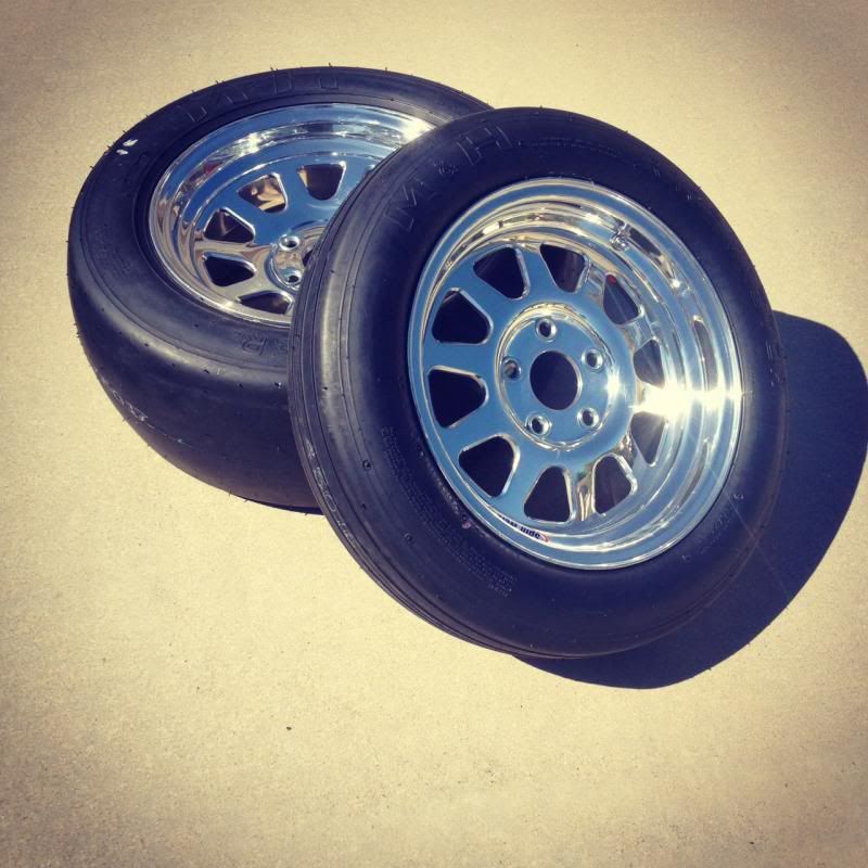

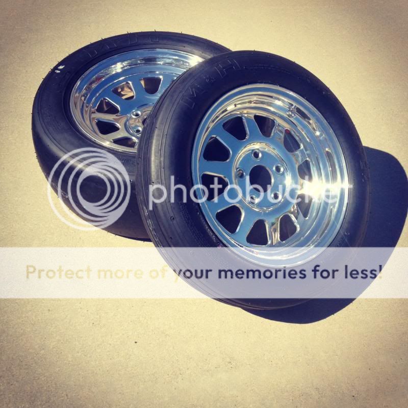

Just needs the suspension
Stock wheel with tire weighed in at 46.7 lbs x 4 = 186.8 lbs
Drag fronts with slick - 27.5 lbs x 2 = 55 lbs
Drag skinnie with tire - 19.8 lbs x 2 = 39.6 lbs
Total weight savings of 92.2 lbs off the car and its all rotating mass... one step closer to 12.9 all motor factory K24z7

What size rimes and offset r there and where did u buy it from? they looks very nice I want a set of those for the track too
Red13devil... We had these custom made with a local company to make them work for 8th and 9th gen civics... these are a 15"x8 fronts and the rear are 15"x4. The stock caliper needs slightly shaved to clear the wheels but we are also working on a slightly smaller Wilwood brake kit to get rid of more weight and make it perfect for 15"s.
