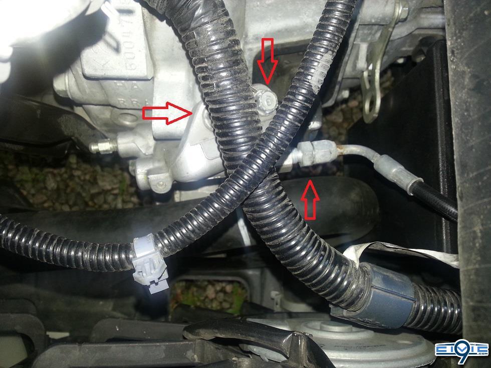

    First of all you need to take off your airbox/cai/sri in to be able to reach the slave cylinder and clutch hose easily!!
    Then you need to take off the slave cylinder on the transmission! There is two(2) 12mm bolt and you need a 10mm key for the clutch hose!!
    [​IMG]

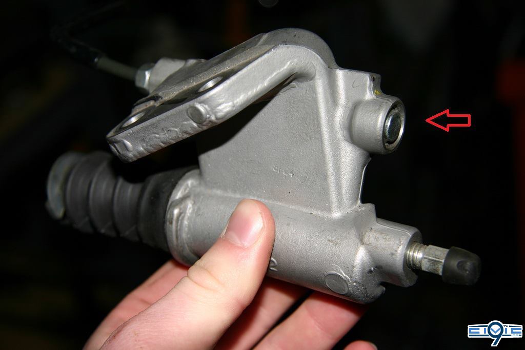

    Once the slave is off, the is a ''C'' clip to take off. This thing is a pain in the *** to take off. Most of the time, its stuck in corrosion!

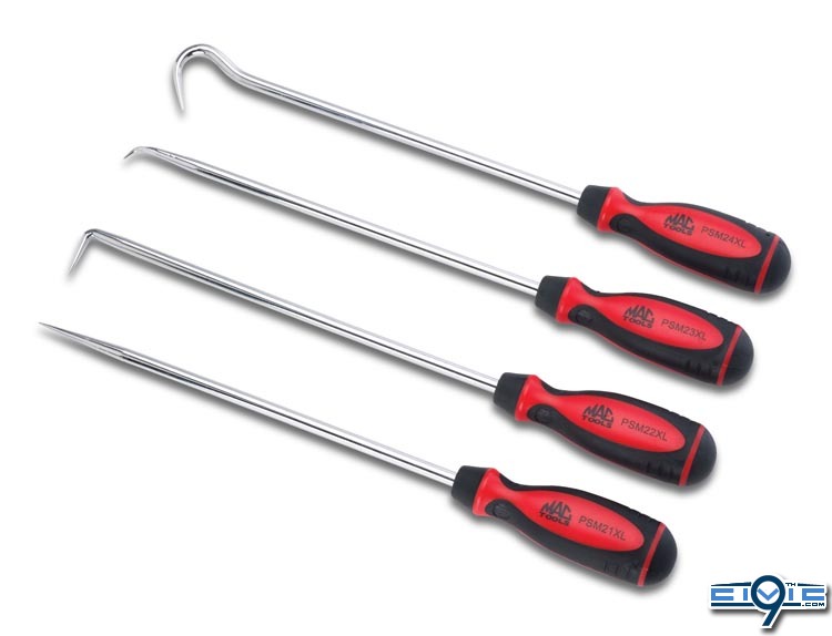

    You need some really sharp screwdriver like theses:
    **Be carefull with those picks, one of my finger didnt like when the pick went through it!!
    [​IMG]
    To make the ''C'' clip removal a bit easier, take a punch and a hammer and hit on the little cap to unstick iit from the corosion

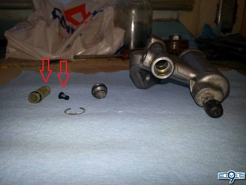

    With a set of long nose pliers, take the little cap off!!
    Once done, you will have a few parts in hand, the delay valve (little white thing), the filter (the little black thing, which is IN the delay valve by the way)
    You throw the white and black thing to the garbage!!
    [​IMG]
    Put back the cap, be carefull with the O-ring, and put back the ''C'' clip!!
    Re-install on the tranny with the 12mm bolt, reconnect the hose(10mm key)!
