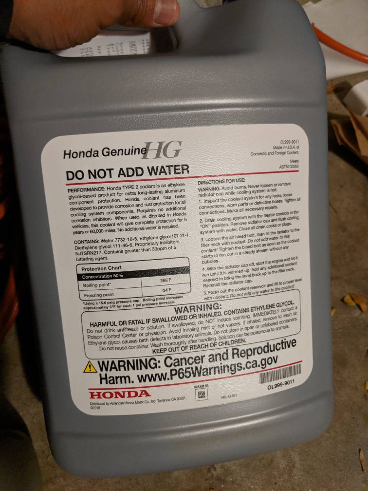

    Hey guys,
    I have a 2014 Civic EXL and currently at 80k miles. I was under the believe that the coolant is changed when the maintenance minder tells me or 100k. On forums most say we are good for 100k.
    Well since I went to buy coolant for my father in laws Accord I asked the Honda parts person when should I do a drain and fill. He said "we do 60k intervals for coolant". I was taken of guard as I'm at 80k already and always ahead of the game for maintenance. I then called another Honda and asked their service rep and they said "every 30k" I know that's def. Not necessary.
    So for peace of mind I purchased coolant for my car. Reading the back it says if used properly, that will protect my car for 60k or 5 years! So I revisited my cars owners manual and it does not say any specific miles. Just says to check every fuel up and too off when needed.
    Should we do our coolant change every 60k? [​IMG]

    I have been going though this, don't forget the 5yrs old req. My 2013 is six yrs old-needs to be changed, its at 19,000. I would not go above the recommendation. I would rather change early then late. this coolant stuff isn't easy to learn. I did notice the freezing point -34 :popcornbig:and boiling point 268 degrees looked perfect. Oh Yes to your question 60k or 5yrs. Forget the manual. What did you pay for the honda OEM coolant?

    aren't these stupid warning on labels from just one state California make them look like the nanny's they are :rotfl: California should just do what they want and start their own crazy country like they have proposed to do and stop bother everyone.

    First change is supposed to be 100k/10years, and subsequent changes 60k/5 years.
    Of course the maintenanceminder should throw a code when it’s time.
    Dealers are just trying to maximize their profits.
