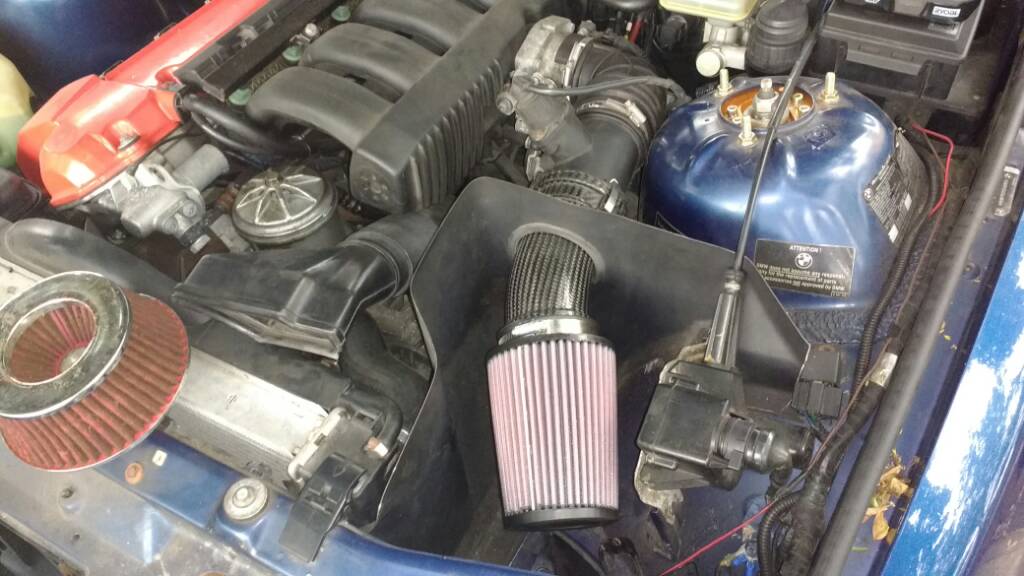

-Carbon Fiber Intake with K&N Air Filter

-Some sort of intake
