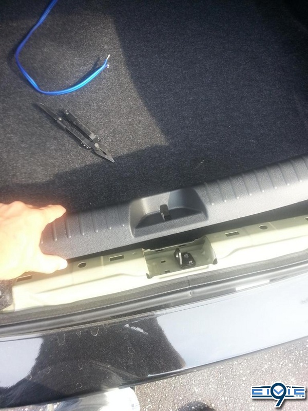

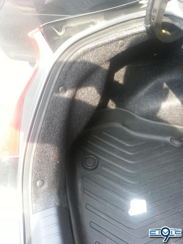

first open and empty your trunk completly and locate these 3 plastic clips
take them out using knife or plastic screwdriver NOTE there is a small space between the base and the part that pops up, stick the tool in the small space and carefully pry them up and pull them out there are three on each side
Pull off the trunk latch plastic cover piece to be able to fully pull back the carpet

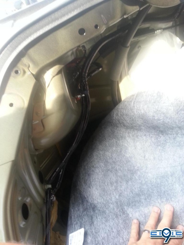

pull back the carpet exposing the back of the lights

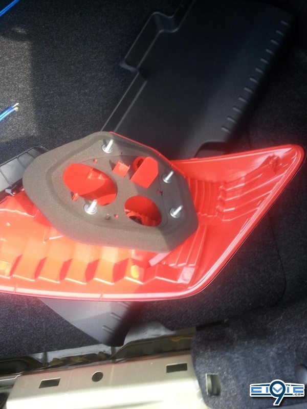

locate your bulbs and rotate them and remove them from the light. there is also a metal clip attatched to the light stick your screwdriver or knife between it and the plastic part its attatched to on the light to remove it. also you will need to remove the plug that goes into the reverse light, pull the light out after removing the 4 8MM nuts holding the light in and removing the light.
slowly remove the light from the car and be careful not to tear the gasket that keeps water out. carefully remove the gasket and set it aside you will need to reuse it.

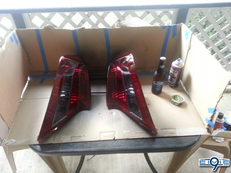

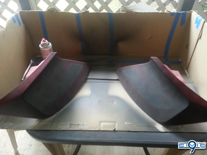

bring them to your enclosed painting area (i used an old box) and follow the directions on the can for applying the tint. I personaly hold the can 6 to 7 inches away to give a nice coat with out drips holding farther away will lead to a speckled coat and require more coats resulting in darker lights (cop magnet)
i used about three coats
let dry for 20 minutes between each coat on the last coat preheat your oven to 250 degrees and let bake for 5 minutes with the door open this hardens the paint and it lasts longer and will not fade over time
remove from the oven and let them cool off to room temp take them back outside and grab your clear coat
apply about 5-7 coats this ensures good thickness and protection and adds a glossy look to the finished product
