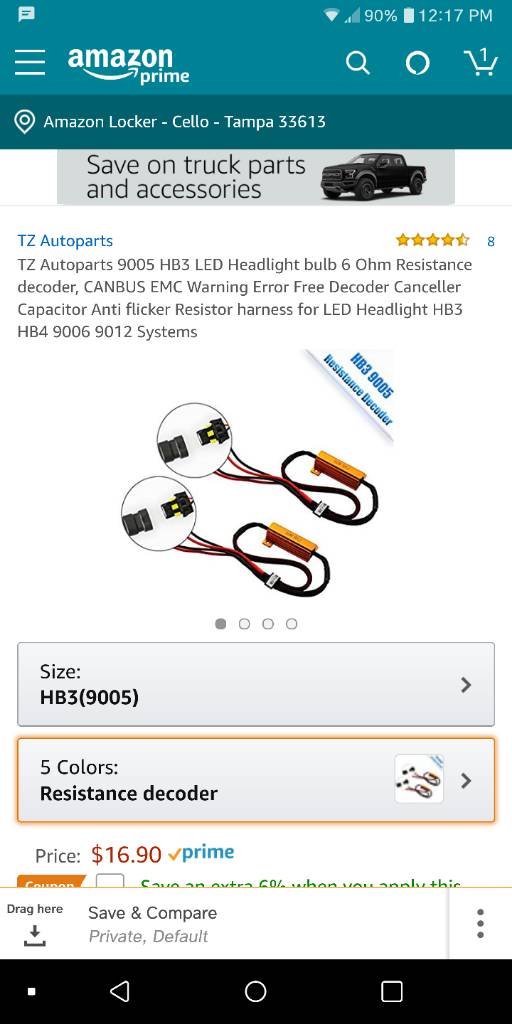

    Couple people I know personally have used these for their civics and haven't had any problems with them. I haven't tried any of this out though, I actually don't like the DRL, pulled the fuse for it a while ago [​IMG]
