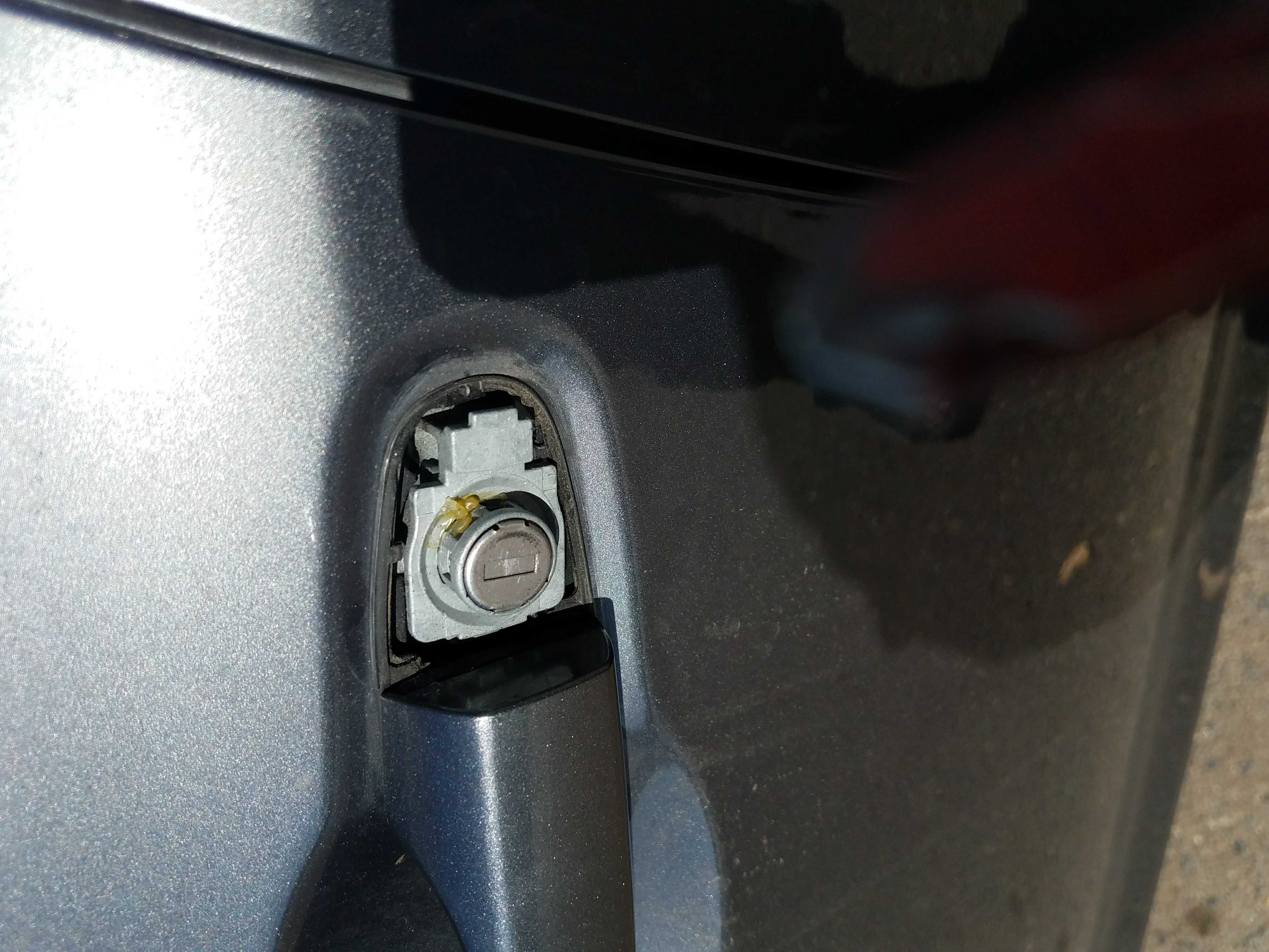

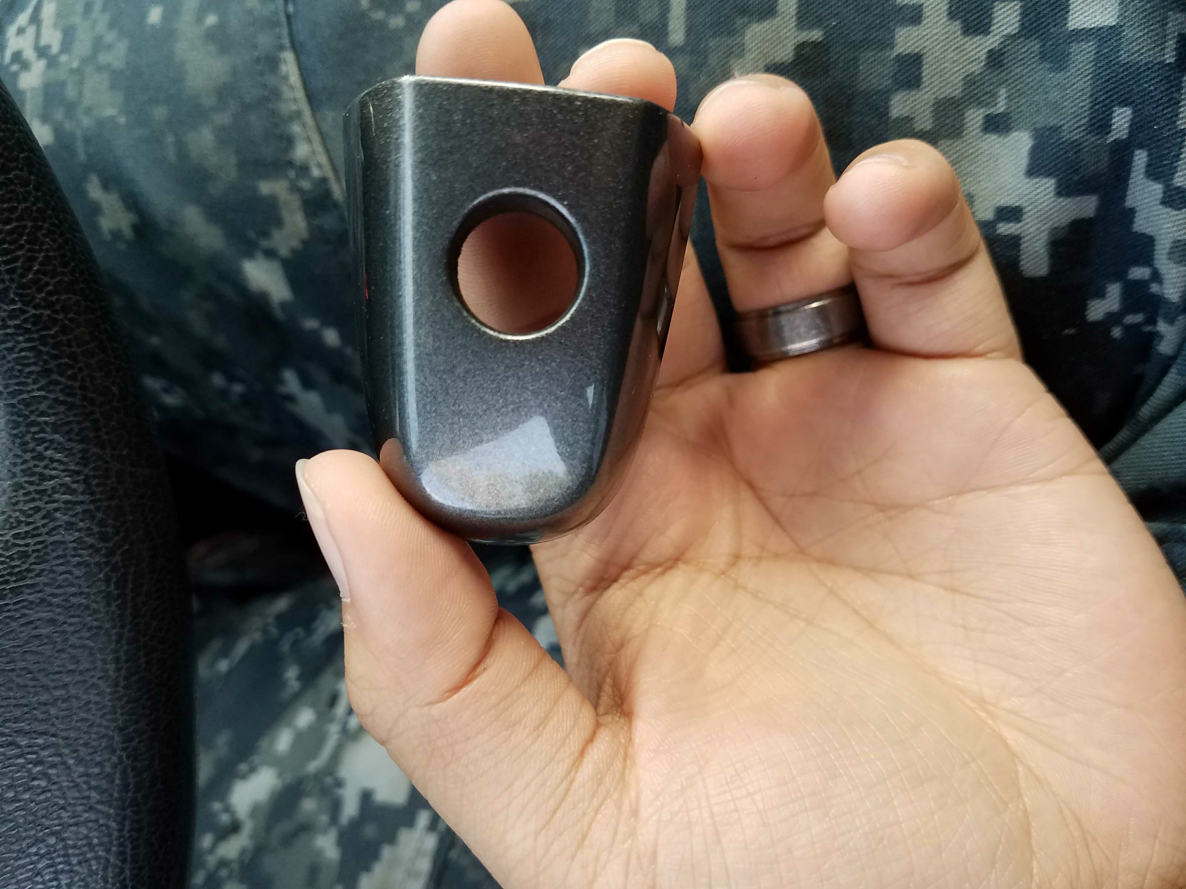

    I noticed there was a gap between the door handle and the lock cover, messed around and the lock cover came off. How do you fix this?[​IMG][​IMG]

  6. dpetro1
    dpetro1 Well-Known Member
    Messages:
    267
    What does the back of the cover look like. Are any plastic clips bent/broken?

  8. mazda_lexus
    mazda_lexus Well-Known Member
    Messages:
    183
    No it looks like it should clip on but it doesnt..

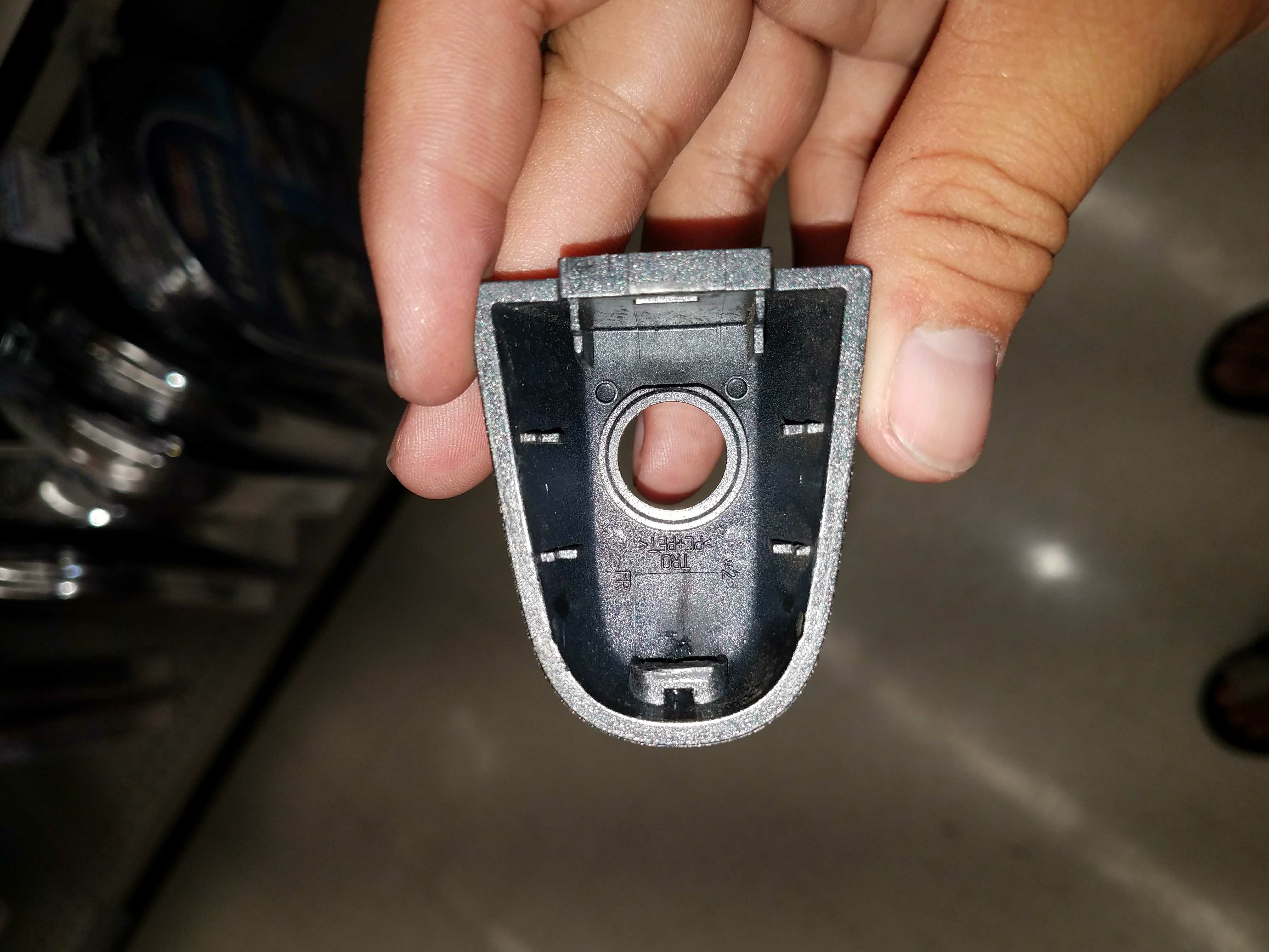

    Take a pic of the back side of the cover. I believe it slides in between the door and the metal piece surrounding the the key hole. Once it slides in, it might click into place.

    Here[​IMG]

    FB6
    From the pictures it does look like it just clicks in once the tabs catch. Maybe it just needs a little more pressure to click in to place.
    Edit: After doing a little research, the door handle cover coming off was apparently a common problem on some older civics. I am assuming this is a similar problem and most cases it was fixed with some plastic putty or epoxy on or around the tabs.
