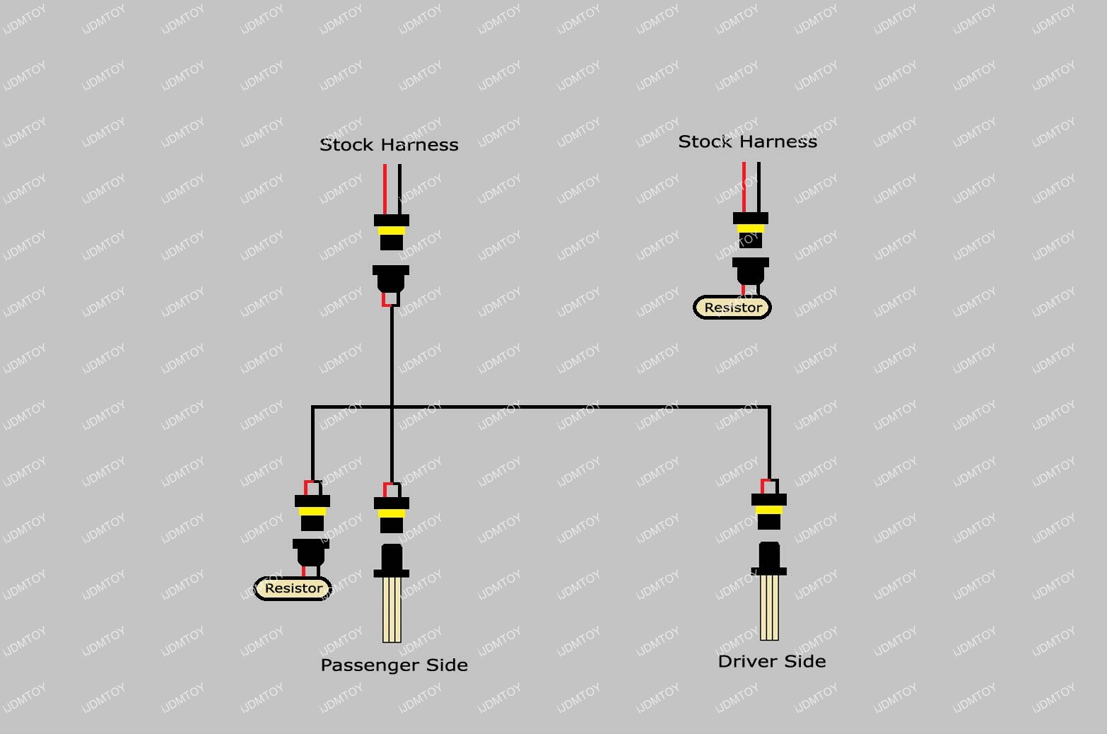

Here's my setup
Driver's side
IJDM Resistor:Plugged into the drivers side power harness
Passenger side
Wiring harness plugged into the IJDM harness
Small outputs: Resistor and LED
Long Harness across engine bay to Drivers side LED
This is exactly how I have it installed. Worked great the first night. Now DRL error with LED or Stock.
I have the same kit and I don't know if it would really make a difference, but I have it wired to the driver side harness, and just a resistor on the passenger side. It's worth a try to just switch around a couple wires and see if the error goes away
my whole thing is... When I took the harness out completely and went back to stock, why wouldn't the stock oem bulbs work and remove the error code?
Also are you using only one resistor? or both?

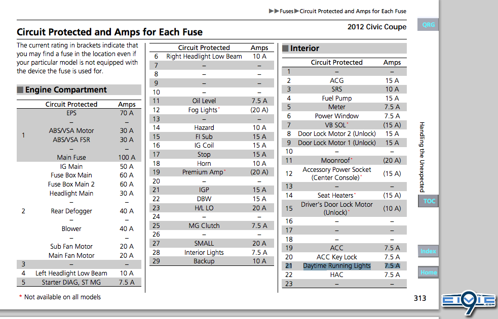

hey guys,
dealership said it was a fuse and replaced it. So I'll be putting the LEDs back in. I would like to know which fuse though
Fuse 21 is the daytime running light fuse.
#4 Low beam on left side
#5 Low beam on right side
#38 Left Headlight High Beam 10 A
#39 Right Headlight High Beam 10 A
