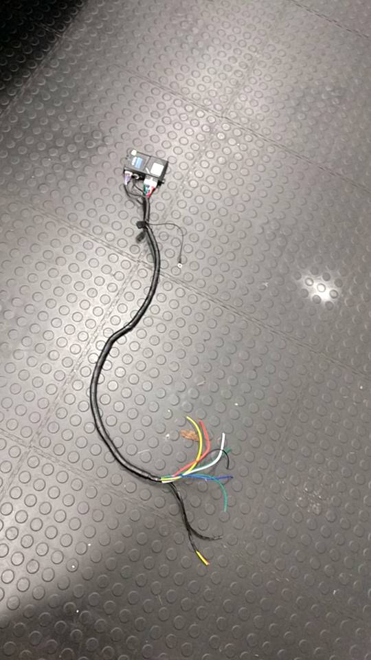

    Pm me if you need anything else. Btw they clean up nicely.. Here's the prewire for my civic. I had to take it into the dealership for service and they said they couldn't tell there was an aftermarket system on there
    [​IMG]
    Sent from my ONEPLUS A3000 using Tapatalk
