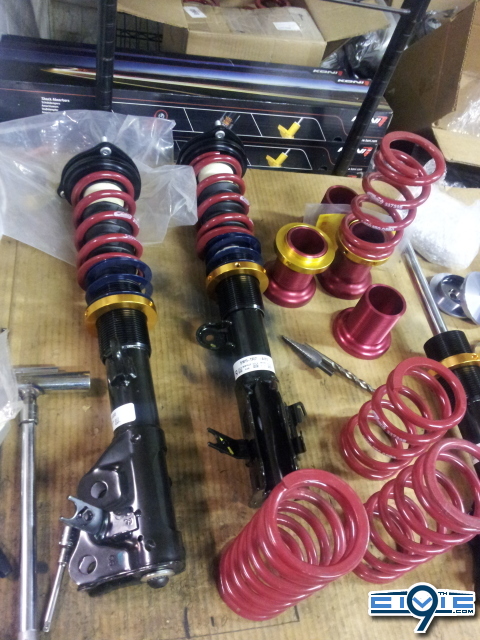

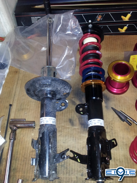

Comparison of the stock vs. Redshift Coils

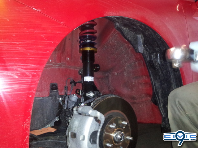

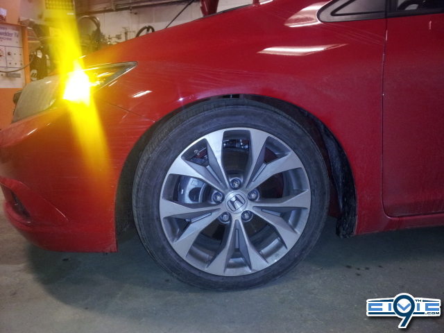

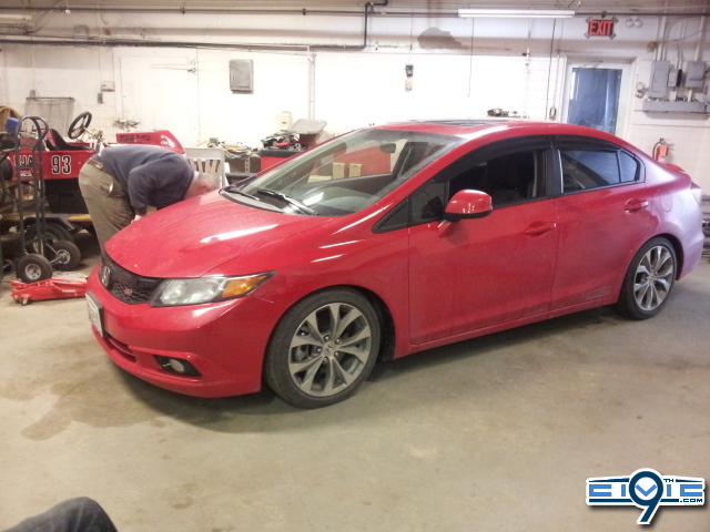

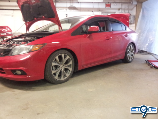

Installed on the car
Coils Installed.

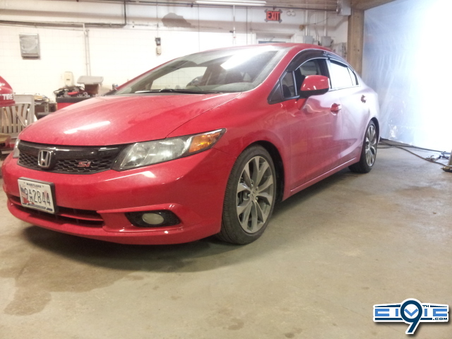

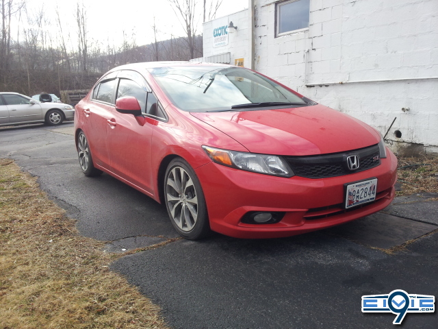

any idea on how much you're dropped in the pic, or how much lower you can go?

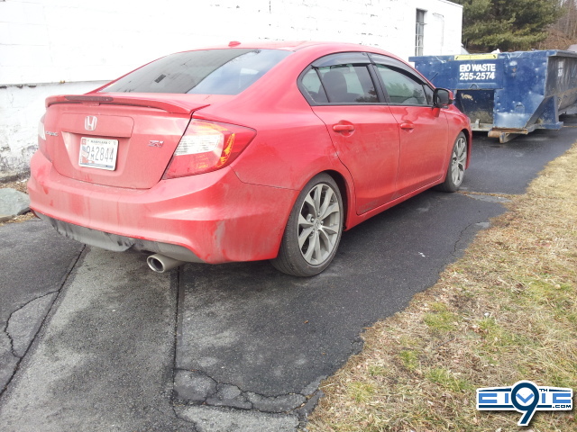

The front is dropped 1.5-1.7 in and the rear was 2in, I still have threads on the fronts to drop it more, the rears are almost maxed out and almost tucking tire :thumbsup:
my quick review: rides great even for how low the rear sits, handles awesome, pulls planted to the road on corners, a little bouncy at times but nothing that unbearable, going to try and adjust the height again since the front looks higher than the rear. Chris did a great good, worth the drive up there, in about a week or so i'll try and do a video review for you all.
Raise the rear a bit and then get a good alignment and it'll make a huge difference. -1.5F -1.0R with 0 toe all around should be a great starting point.
looking at the redshift website and im pretty confused. I'm not sure which one is the coilsovers for our car. It doesnt say 2012 civic on any of them. Do they have all those brands to fit in the stock housing when they custom them?

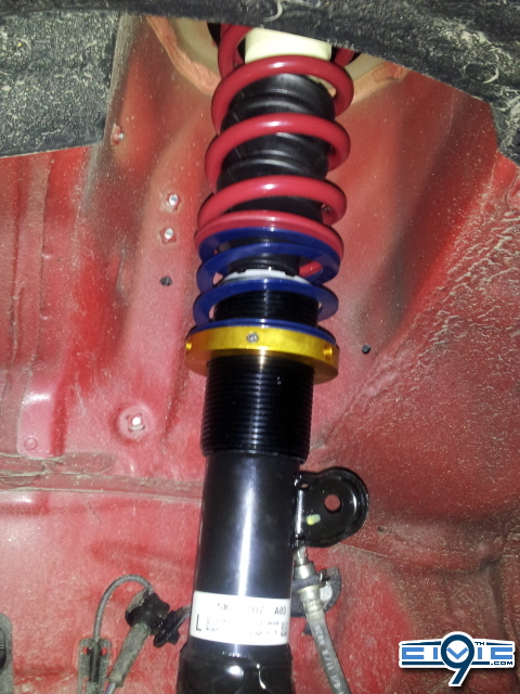

more pictures of the rear suspensions!
go to the link at the beginnning of the thread, theres some pics of the rear. I'll getting a small photoshoot this sunday maybe...BTW the fronts are production ready, the rears are still prototypes....
