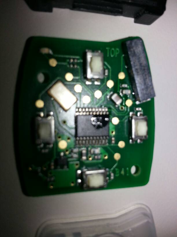

Do you know where in the 3button unit the transponder sits? I pulled it apart but couldn't tell. Probably the largest piece on the circuit board, the black rectangle at the top of the picture.
That's the one.

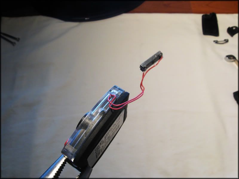

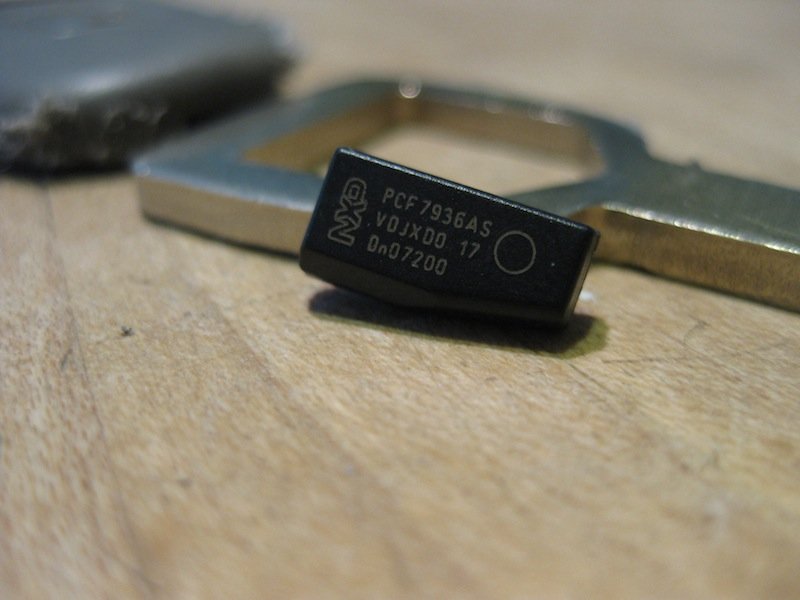

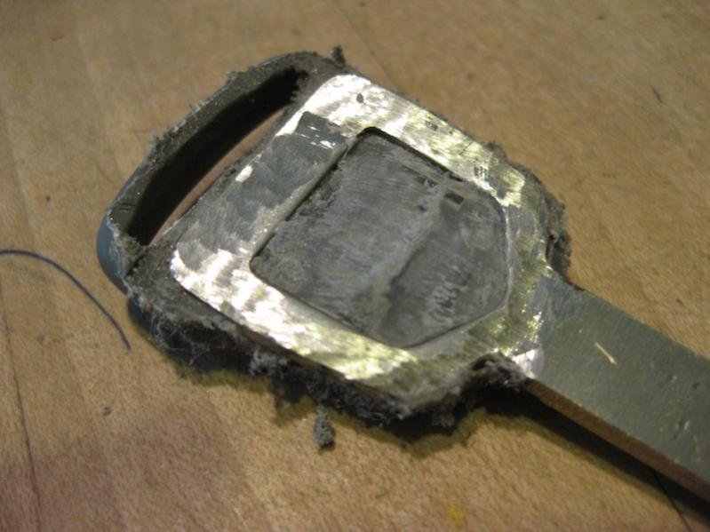

i take it you cant get your car to start or stay running, and have a blinking green key light on the dash? The issue is that the transponder chip is moved too far away in this ebay key, you have two options depending on how you want to fix it.
Option 1
Take a knife or saw to your valet key, cut the grey plastic off and find this thing in the middle
and put it up near the base of the new key
Option 2
Remove the transponder from the original key board with a soldering iron (black rectangle)
attach two wires to the ends of the transponder and the pads where it used to be connected and extend it out
and put it up near the base of the key

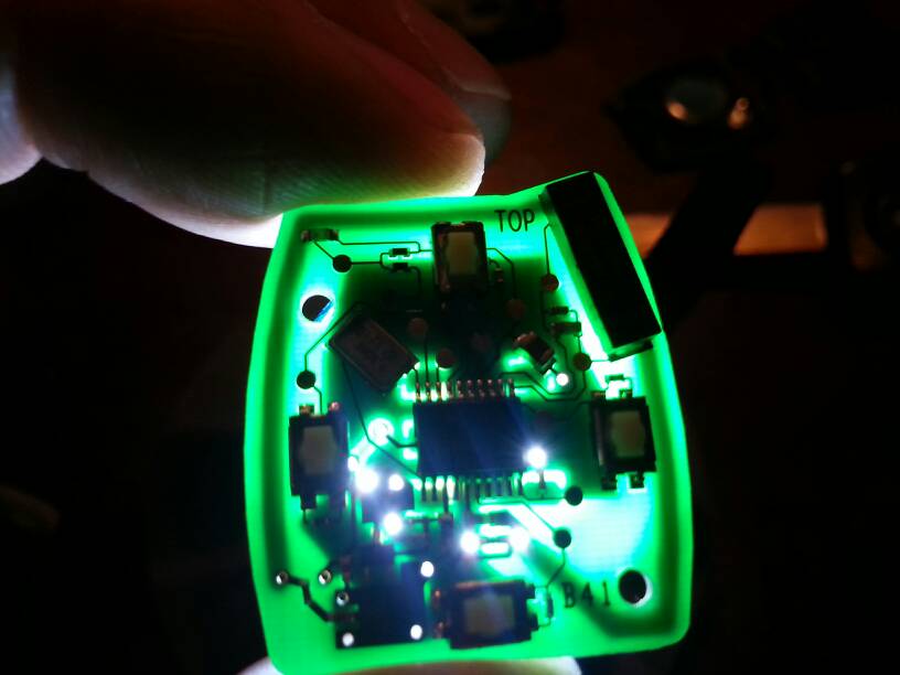

the car started with just a circuit board pressed up against the new Flipkey case where the oem transponder would ordinarily be. I gather from that that it does not need power. I also have taken a picture of the circuit board with some back lighting. Tell me what you think of it. It looks more like an antenna than a power supply, as it runs the periphery of the board.
The transponder can exist separate from the board but range for both the remote and transponder may suffer
hotdogjohnny it looks like its built into the ground trace for the remote, it's already a decent amount of copper present and they didn't have no add anymore
ethlar and ADExternal: So, since I have it all apart anyway . . . I might as well wire it to take advantage of whatever Honda had in mind. I'll post up the results.
