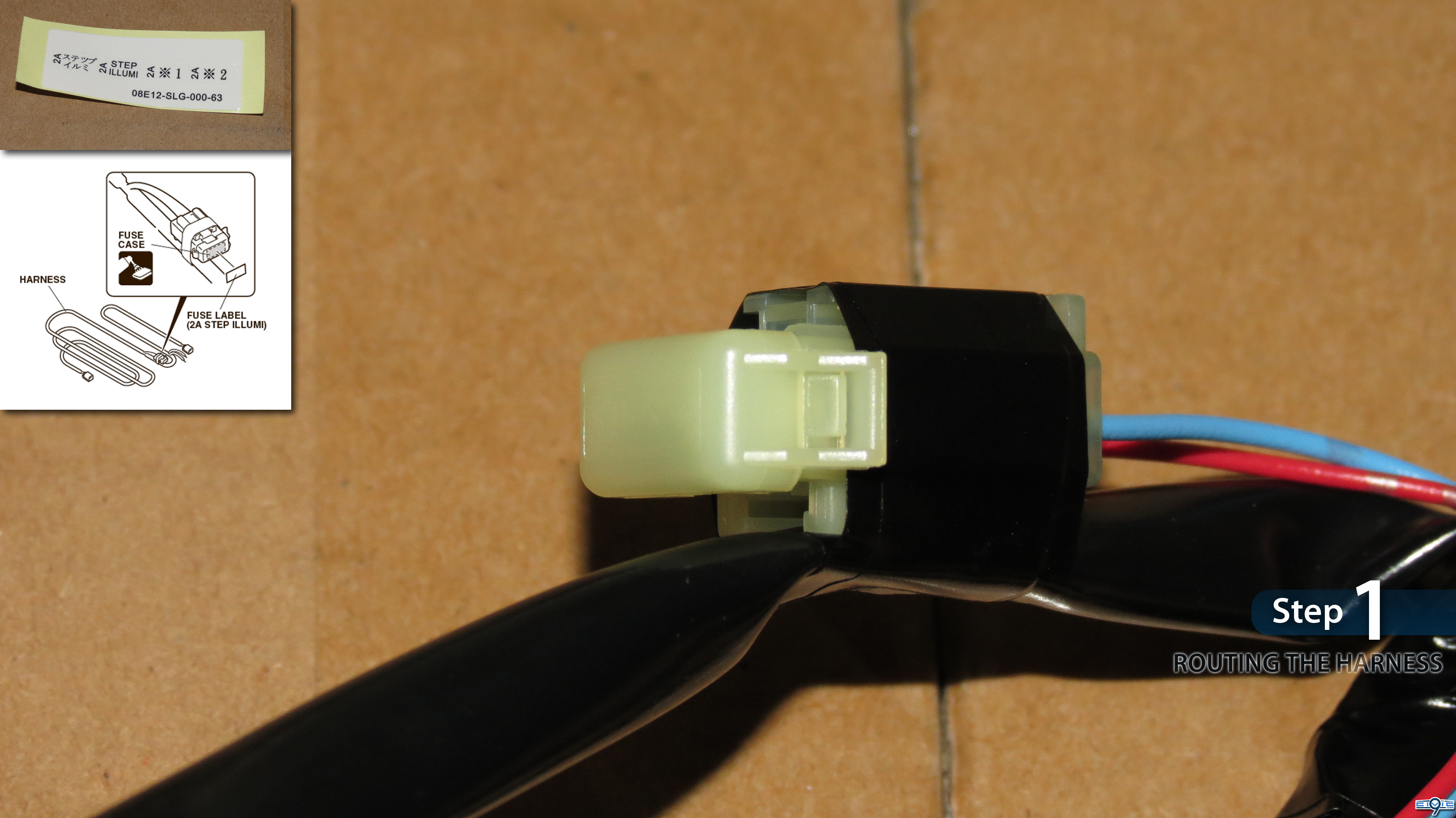

    All depends on how much power the items are using. Do you have a list of how many bulbs/wattage each one is rated for?

  19. S54flexin
    S54flexin Well-Known Member
    Messages:
    44
    That looks good! I'm guessing 5 amps would suffice since the 2 back sills would probably draw the same amount of power as the front 2 sills?
  20. webby
    • 2018 Toys For Tots
    webby Administrator
    Messages:
    50,132
    I would imagine yes
