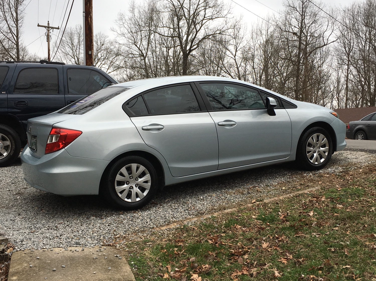

    Hey guys I have a 2012 civic lx with about 72k miles. I am getting a vibration and noise when ever I got over 60 mph. Let me tell you what’s going on so far.
    1st I got new tires in July. I went with cooper. Then I noticed the vibration and noise. Took them back to discount tire and they re balanced them and still not right.
    Next they suggested swapping to a different tire. hankook kinergy 90k warranty. Still the same issue. They checked for a bent rim. No issues there. And the tires balanced fine
    Took it to Honda since I have an extended warranty. They replaced the passenger motor mount. Still having the vibration. They drove it during rush hour last week and couldn’t get to speed.
    Took it back Saturday and had the tech ride with me and he was like dang this isn’t right. Any turn or vering over 60mph and it’s a vibration and propellor like sound.
    Never had any issues as this is my commuter car and I baby it. Average 42-45 mpg non hybrid.
    Any help or suggestions would be greatly appreciated!
    Thanks, Jeff
