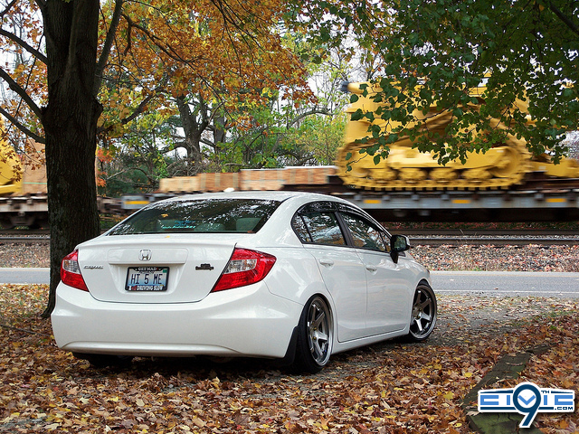

3" is significant. 2" should eliminate the entire wheel gap down to the tire. 3" you'd be tucking tire and you'd definitely have some ride change from stock. 2" should not be bad at all, and there are 36 levels of adjustment for ride quality with the d2's.
others have done it for looks. Example below on d2's.
