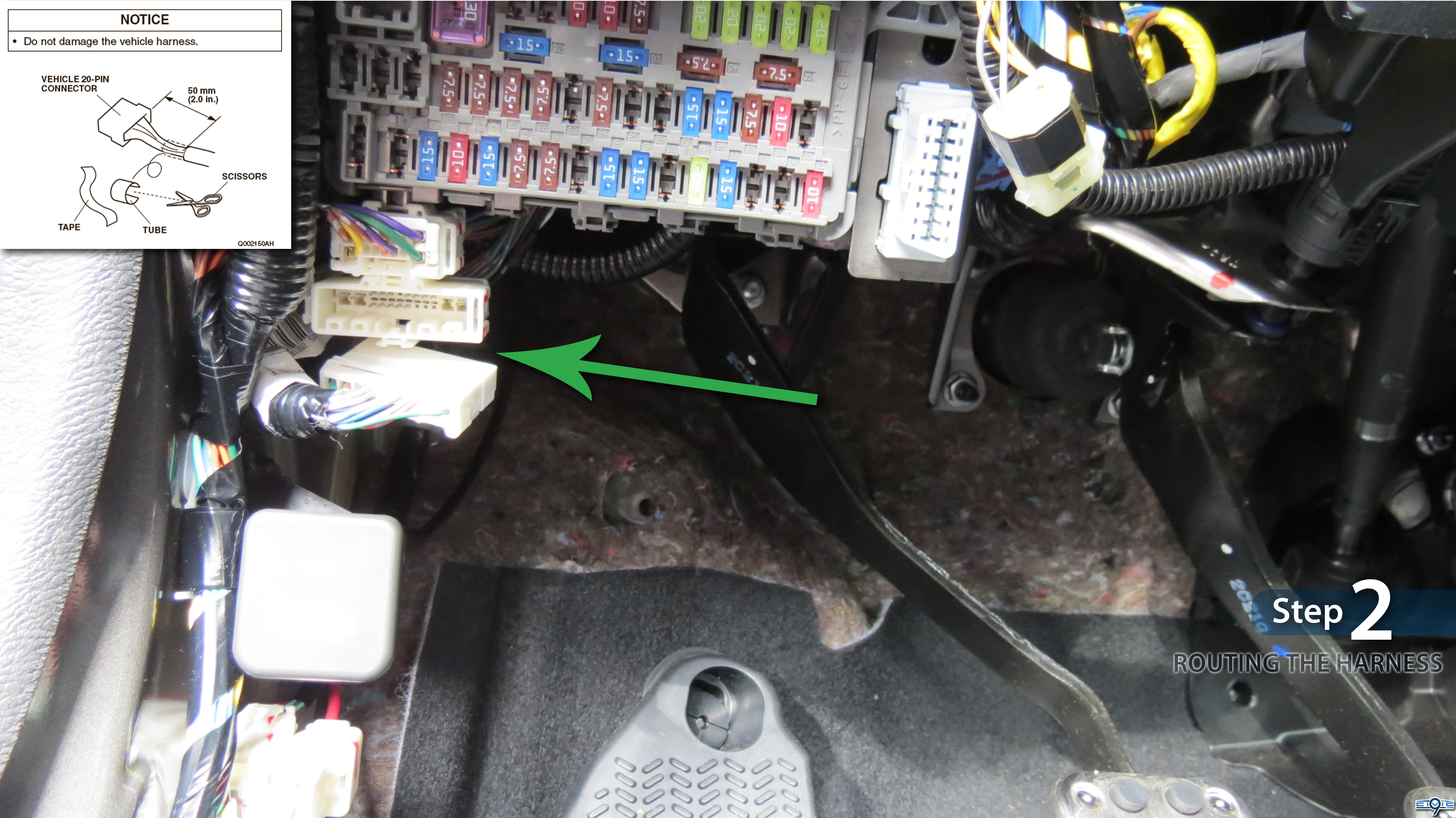

Good afternoon, I have a total noob issue with a remote start kit. The kit continually references tapping wires at a blue 23-pin connector by the driver's side kick panel, but I can't find any 23-pin connector! The wires it says should be present include the "OEM Arm (Pink)", "Lock (Blue)", "OEM Disarm (Brown)", and "Unlock (Gray)". The specific instructions reference "@ Driver Kick Door Harness, Blue 23-Pin Plug".
Does anyone have a picture or exact location?
Thanks!
likely this harness plug, but I've not seen a diy for a remote start to know.
http://9thcivic.com/forum/threads/2012-civic-illuminated-door-sills-side-steps-4-door.5775/
this is where that pic above came from. There are a bunch of additional pics on how he got to it from his door sill DIY.
Thanks Webby, that looks very similar to what I have, just a different color of connector. Can anyone confirm that's where the door lock inputs route?
