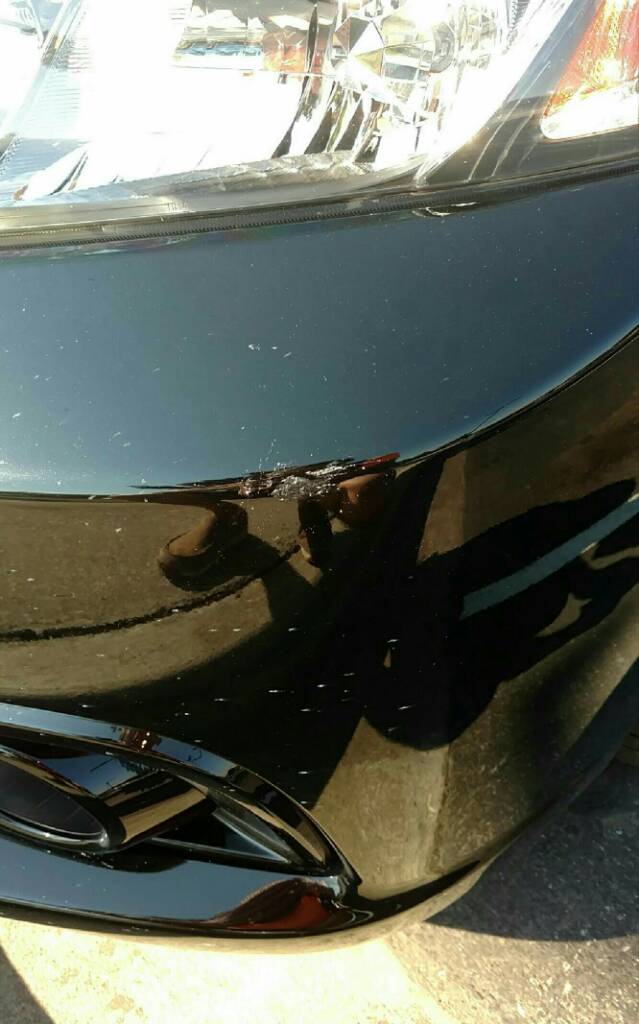

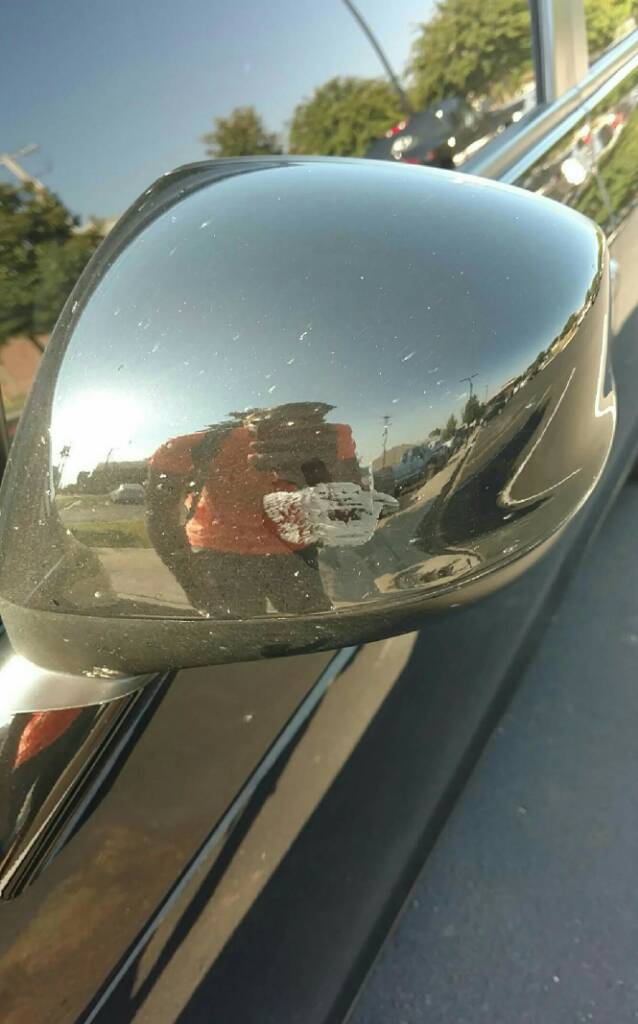

The damage isn't too bad, just paint, pretty lucky considering they almost forced me off a bridge which would've killed me.
But as someone who spends 3+ hours every car wash meticulously detailing/polishing/sealing/waxing on my almost completely untouched paint this has me ****** up.
Yea yea it's not a big deal and I might even be able to repair it to a much better level but dammit if it isn't a huge inconvenience.

Sucks.....did the two cars just rub mirrors?
The mirror should buff out but you could just buy a mirror cover if it doesn't turn out to your standards. The front looks like a bug splat. Not sure how you don't have any other damage on the bumper if the 2 cars actually touched.

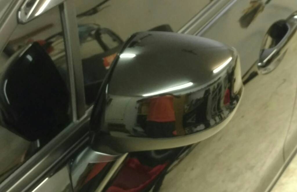

Yea the bumper was a bug splat lol, it looked similar at first glance but it's fine now
What products did you end up using. Looks good
Meguiars ultimate compound + meguiars ultimate polish
Did it by hand, it doesn't look perfect but the untrained eye can't tell.
Basically you clay it, then apply the compound, do 6 passes, spray with detailer then wipe it off with a microfiber, then apply polish 6 passes, rinse, wipe, then seal/wax
