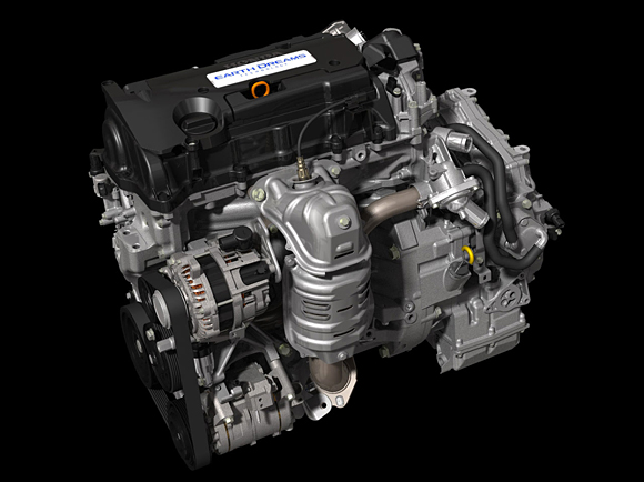

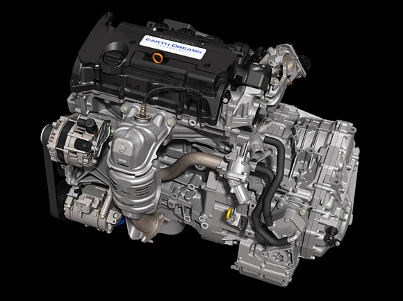

1. Gasoline engine which achieves top-of-industry driving performance and fuel efficiency

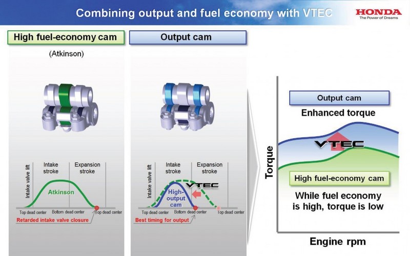

  • By enhancing Honda's original VTEC (Variable Valve Timing and Lift Electronic Control System) technology to thoroughly improve thermal efficiency and minimize friction, a combination of high output and fuel efficiency was achieved. Further, a new engine series employing a new structure for higher expandability was developed.
  • By gradually renewing the engine starting with the mini-vehicle N BOX, Honda aims to utilize this technology to achieve top-of-industry output and fuel efficiency in every vehicle class within three years.
  • A wide range of engine classes including the 660cc, 1.3L, 1.5L, 1.8L, 2.0L, 2.4L, and 3.5L classes will feature the technology.
  • [ 660cc class engine ]
  • Employs DOHC and VTC (Variable Timing Control) to improve intake efficiency. Further, the compact combustion chamber realizes high thermal efficiency.
  • By shortening the bore pitch compared to the present engine models and reducing the thickness of the cylinder block and camshaft, engine weight is reduced by 15%*3 and fuel efficiency is improved by 10%*3.
  • [ 1.3 to 1.5L class engine ]
  • Employs VTC, direct injection technology and the Atkinson cycle using the DOHC, VTEC technologies as the base.
  • Extensive friction reduction measures are implemented.
  • [ 1.8 to 2.0L class engine ]
  • Employs direct injection technology and the Atkinson cycle using the DOHC, VTEC technologies as the base. Further, implementation of VTC and high-capacity EGR (Exhaust Gas Recirculation) to both the intake and exhaust ports realizes significantly reduced friction.
  • For the 2.0L class hybrid vehicle engines, use of an electric water pump eliminates the need for a belt in the auxiliary device and contributes to a reduction in friction. The VTC system allows fuel-efficient driving in various driving styles.
  • [ 2.4L class engine ]
  • Based on the DOHC and VTEC technologies, it employs VTC and direct injection technology and implements extensive friction reduction measures.
  • Standalone engine features 5%*3 improvements in fuel efficiency and output as well as a 10%*3 improvement in maximum torque compared to the previous engine.
  • [ 3.5L class engine ]
  • Employs new valve train mechanisms and direct injection technology in the SOHC, VTEC, VMC systems to improve by over 10%*3 of fuel efficiency and 5%*3 of output, relative to the present standalone engine model.

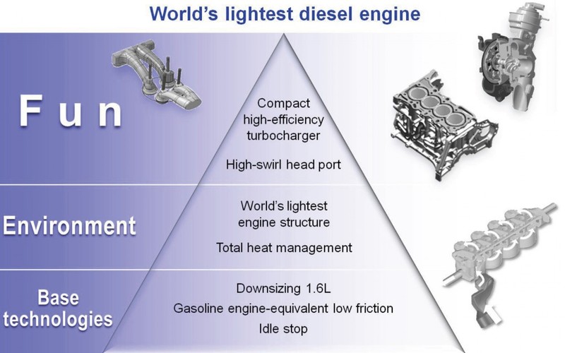

2. A compact diesel engine which realizes the world's lightest body*1, top-of-class*1 acceleration performance and fuel efficiency.
  • Through optimizing engine rigidity and combustion pressure, an aluminum open deck for the cylinder block was enabled in this top-of-industry lightweight*1 1.6L class diesel engine.
  • By downsizing from the present 2.2L engine and extensively reducing mechanical friction in each section, a friction level equivalent to present gasoline engine models was achieved.
  • Optimized thermal management system thanks to improvements in the cooling system reduces CO2 output by over 15%*3.
  • Employment of a compact, high-efficiency turbocharger and weight reduction in the reciprocating sliding section realizes a sporty and nimble ride.

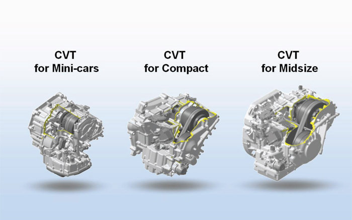

3. CVT which combines at a high level the fun of driving and fuel efficiency.
  • Three CVT structures for mini, compact, and mid-size vehicle classes are newly developed to be adopted for a variety of engine models.
  • Reinforced belt is used to realize a structure for which a wide ratio range can be set.
  • Implementation of analysis technology over the contact behavior between the belt and pulley, and a high-precision hydraulic control system allows for continual optimization of hydraulic pressure to the pulley under a variety of driving conditions, contributing to improved fuel efficiency.
  • Use of an electronic oil pump to realize an idle stop system with high response contributes significantly to improved usability and fuel efficiency.
  • "G-Design Shift", a new coordinated control system for shift transmission, throttle, and hydraulic control responds quickly to driver demands and realizes an exhilarating, sporty drive with superior acceleration.
  • In the mini-vehicle class, a control mechanism and innovations in axle placement to reduce the engine size lengthwise, while a reduction in parts by simplifying the transmission casing structure helps realize a lightweight and compact body.
  • For the compact and mid-size classes, in addition to the reductions in size and weight, transmission efficiency was greatly improved by expanding the ratio range to achieve fuel efficiency improvements of 5%*3 and 10%*3 compared to the conventional CVT and comparable 5ATs, respectively.
