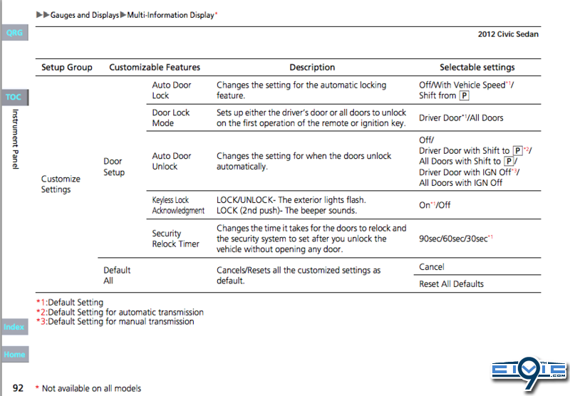

Hello somebody knows how to reprogram the remote control of the key to unlock only the door of driver side when press only once on the unlock button?

on the steering wheel -
hit MENU >> CUSTOMIZE SETTINGS >>>DOOR SETUP>>>>
below shows the options for locking
