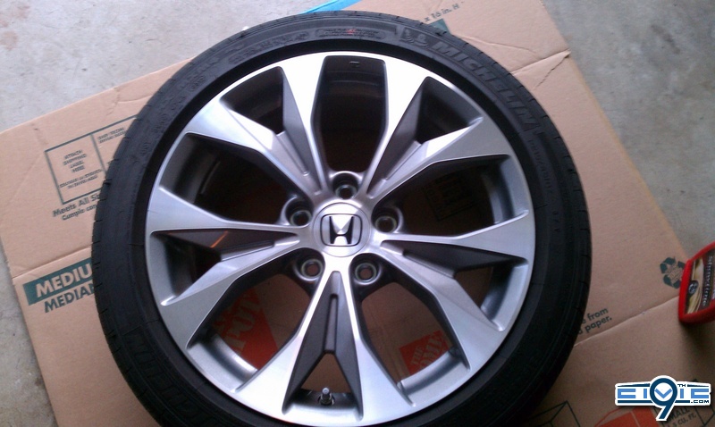

My suggestion is taking the tires off your car, clean your wheels with a damp rag:

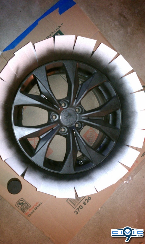

Next you may use a deck of cards, or flash cards, and place them round the edges of the rim, so the plastic dip won't get on your tire. If it does no worries, you can just peel it off.

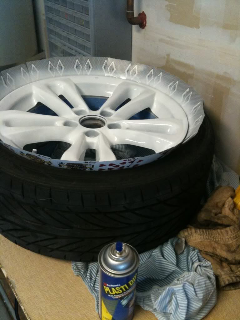

Apply 4 to 5 coats of Plasti Dip on your wheel, wait bout 10-15 min in between coats:

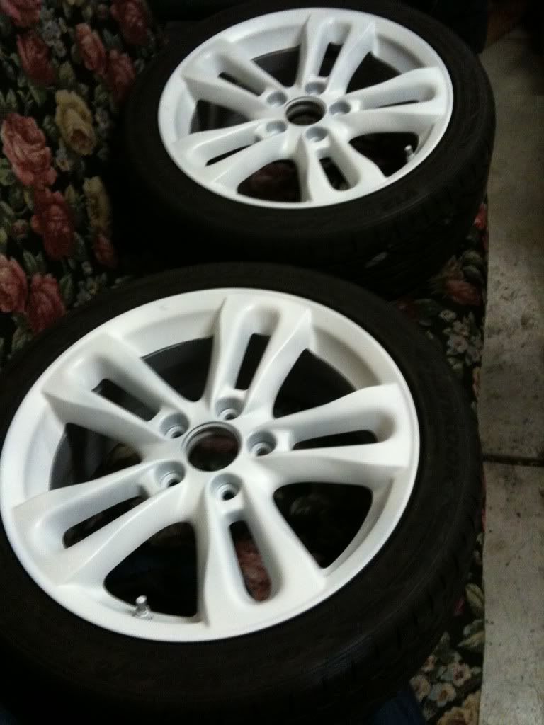

Items needed: 2 to three cans of platic dip, you can buy it at Home Depot, it cost bout $6 per can.
![plast1.sized.jpg](/forum/proxy.php?image=http%3A%2F%2F9thcivic.com%2Fgallery%2Falbums%2FExterior-Style%2Fplast1.sized.jpg&hash=a78f77c8b7e6cf5d822ad68116ccbc42)
![plast2.sized.jpg](/forum/proxy.php?image=http%3A%2F%2F9thcivic.com%2Fgallery%2Falbums%2FExterior-Style%2Fplast2.sized.jpg&hash=3431973265d3245ad5eadbc64d71e2d0)

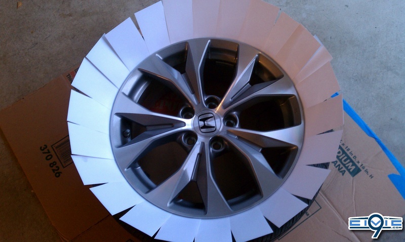

![plast3.sized.jpg](/forum/proxy.php?image=http%3A%2F%2F9thcivic.com%2Fgallery%2Falbums%2FExterior-Style%2Fplast3.sized.jpg&hash=7551bacece631c25b7a492463dcceb46)

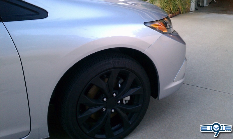

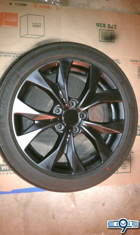

![plast4.sized.jpg](/forum/proxy.php?image=http%3A%2F%2F9thcivic.com%2Fgallery%2Falbums%2FExterior-Style%2Fplast4.sized.jpg&hash=7d283b3ff22c6d090e3992bcdaef4858)
![plast5.sized.jpg](/forum/proxy.php?image=http%3A%2F%2F9thcivic.com%2Fgallery%2Falbums%2FExterior-Style%2Fplast5.sized.jpg&hash=e160a1f2adbb75c3821dfe3e4ff30806)

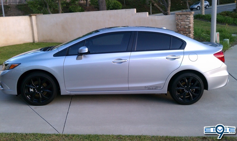

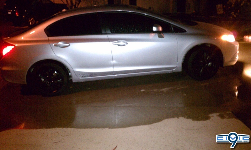

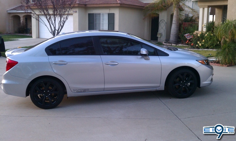

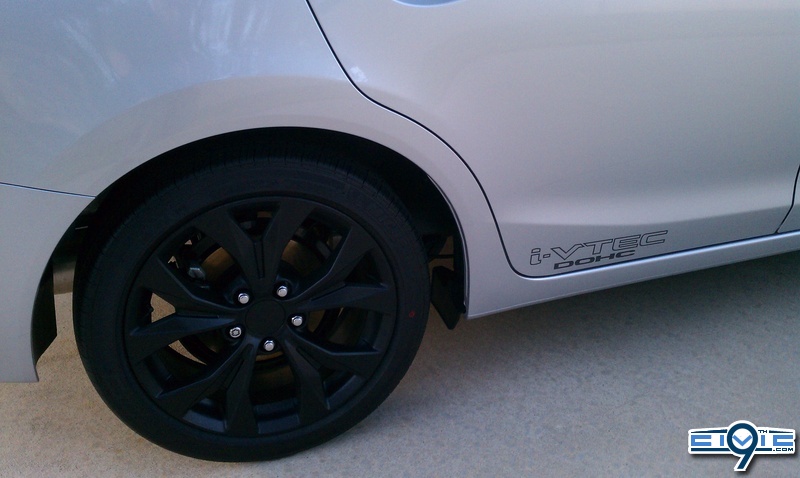

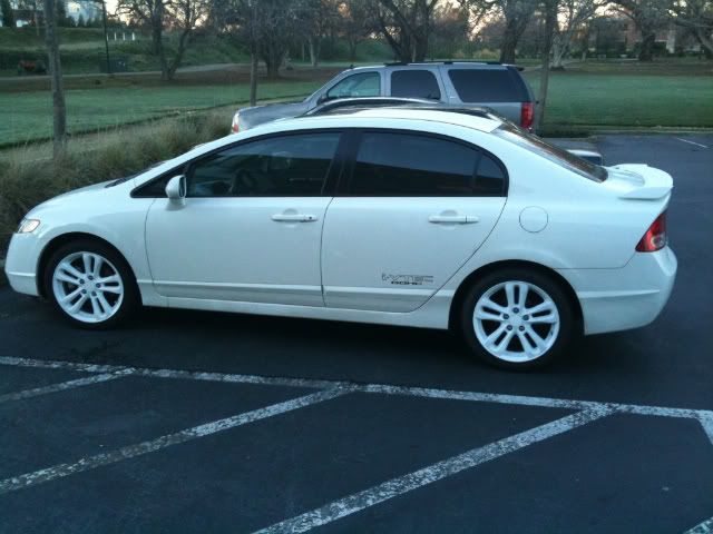

Here are a couple of pictures afterwards (Night time and Day Time):
![plasti11.sized.jpg](/forum/proxy.php?image=http%3A%2F%2F9thcivic.com%2Fgallery%2Falbums%2FExterior-Style%2Fplasti11.sized.jpg&hash=d286ab4028a6e232200e0f4339b2d8bc)
![plast7.sized.jpg](/forum/proxy.php?image=http%3A%2F%2F9thcivic.com%2Fgallery%2Falbums%2FExterior-Style%2Fplast7.sized.jpg&hash=c031e91e6913f8ab3c652c4ef7a47a17)

![plast9.sized.jpg](/forum/proxy.php?image=http%3A%2F%2F9thcivic.com%2Fgallery%2Falbums%2FExterior-Style%2Fplast9.sized.jpg&hash=053aa8a93be4a60ab6b991681250df2a)
![plast10.sized.jpg](/forum/proxy.php?image=http%3A%2F%2F9thcivic.com%2Fgallery%2Falbums%2FExterior-Style%2Fplast10.sized.jpg&hash=8d6003128252e62969cad86e40df3b4f)
