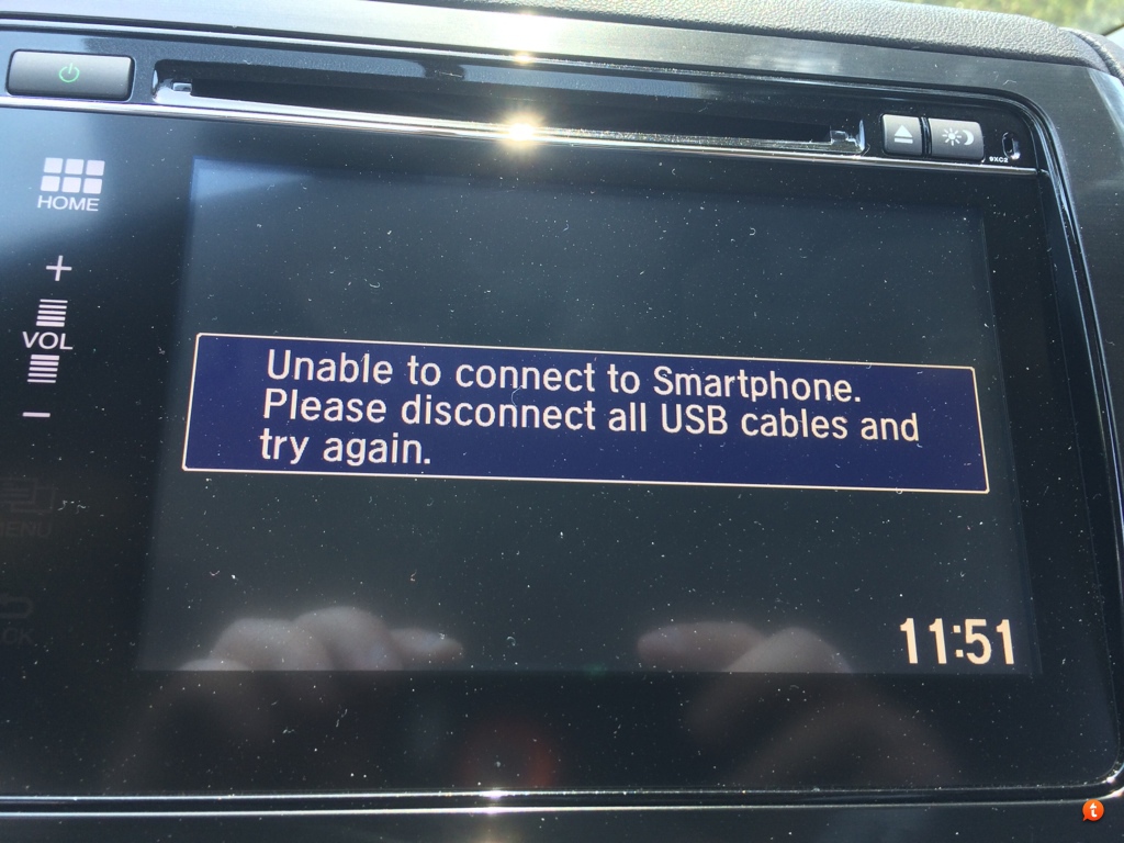

Ever since iOS 7.1.1 came out I can no longer get any of the honda link apps to link to my 14 civic 7" display audio system. I was wondering if anyone else had this problem.

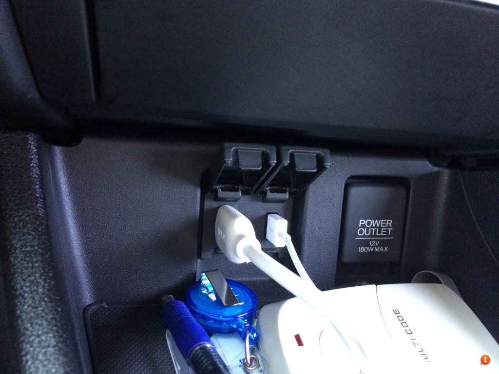

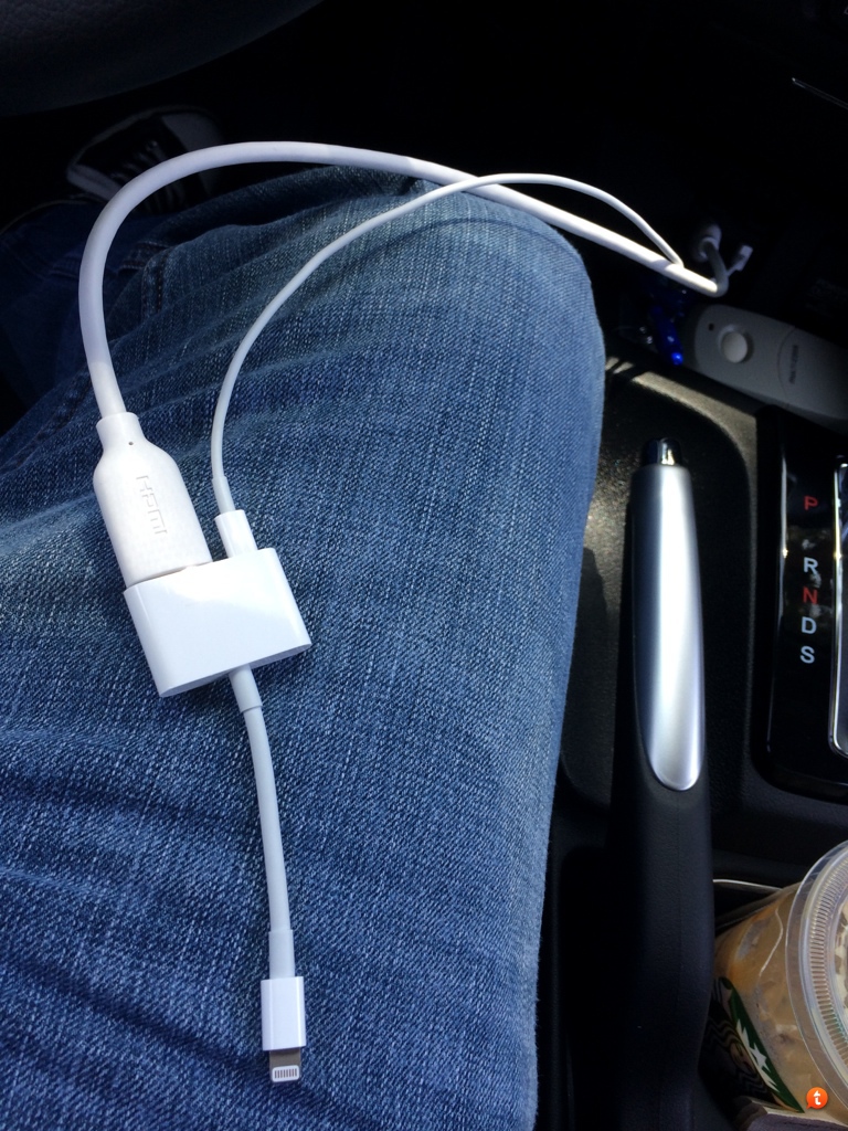

I have the $100.00 of cables from honda (yes I got ripped off)
iPhone 5s with iOS 7.1.1
All cables connected successfully.
I get the following error (please see photos)
Any advice or suggestions would be appreciated :)

Sorry I took so long to update to my post, but here is the update so far.... I have tried to following troubleshooting steps:
I have uninstalled & reinstalled all the Honda Link Apps on my phone (Launcher, Connect, Aha, Navigation) - Did not work
I have Shut down the phone & started it back up (holding the power button and sliding to power down) - Did not work
I did a hard reboot (Hold the Power Button & Home button for 15~ seconds) - Did not work
I did a wipe & restore from a backup - Did not work
I did a wipe & setup as a new phone. Only installed the Honda apps (Launcher, Connect, Aha, Navigation) - Did not work
I unpaired & re-paired my Bluetooth device - Did not work
I re-seated all cables - Did not work
I will try another phone here in the near future & report back on my results. Obviously I would like to get it back up & working otherwise its a good waste of $160.00~. Thanks for all the help & suggestions so far guys.

Update: I called Hondas support line this week @ followed all troubleshooting steps with 0 success. They said the next step is to go to the dealers & have them work on it. The appointment is for this coming Monday. I'll do my best to update you after this step.
Side note: I did test with a different iPhone & the problem continued.
Update:
I took my car into my Local Dealer. I had an appointment at 7:00AM and their systems were having issues, but they were able to resolve it with in a few minutes. I get checked in & I explain to the guy what the problem is. He is super confident that this issue should be an easy fix. I get the car dropped off & wait an hour for the Shuttle Service to take me to work (So I was a tad be late to work... 45 Minutes). While at work 3-4 hours later I got a few calls:
1st Call (10:23AM): Tech advises that the problem is fixed. I then asked him which app he used to test it. He then had an awkward pause saying that it plays music via the stereo. I had to then explain that that was never a problem. I explained he will need to download one of the 3 free apps for the Honda Link system. He said he would ask his tech to do it & give me a call back.
2nd Call (11:23AM): Tech advises that they "Cannot do it" because it requires a HondaLink username & password. He went on to explain none of them own Honda's so that will not be an option. He then asks if I can come back into the dealership. I explained I do not have a spare care & that they would have to pick me up. He ends the call saying someone will call me back.
3rd Call (11:31AM): A different person calls to arrange the shuttle pickup. I make arrangements to be picked up.
I get to the dealer (12:00PM) and am greeted by the same guy who checked me in this morning. He says show us what the problem is. I connect the phone up to the stereo & show him the same error message I explained to him was happening before. (Unable to connect to smartphone. Please disconnect all USB cables & try again). He then calls another guy to try & explain that the system works fine if I just use "HDMI" mode. I had to then explain to him as soon as I put the car in Park HDMI feature gets disabled for safety reasons & that we should test the cables & phone in a different civic or fit. He explains that that shouldn't be necessary. The tech then says let me take the care back to the service bay (12:20 Ish). This time he wants to take my phone with him. I lent him my phone & gave him my passcode & had to play the waiting game. About 30-45 minutes later (I have no watch so this may have been an hour) the tech calls me back to the mechanics bay. I go back & have to explain to the mechanic that it is not working. He explains to me that it is working because music is currently playing via my stereo system & Bluetooth. I explained that Bluetooth was not the problem from the beginning. I then showed him how they system is supposed to work & he explained that he needed more time. I went back and sat down for another 30-45 minutes still without my phone. The first tech comes in & explains that they want to test it on another car which was one of my suggestions from the get go. We go and sit down in a 2015 Honda Fit & test it. Immediately it works. The service tech explains it to the mechanic & I go back to sit down. Another 15-30 minutes later the mechanic comes back & says "We have to test it on an identical car". So we go back out to the lot and find a 2014 Civic. The mechanic took me to an LX model. I had to explain that that will not work because it doesn't have the same stereo system. We find a EX model & jump in and test it. The HondaLink works perfectly in the 2014 Civic. He finally gives up and says it must be the head unit. He went on to explain that he will have to order a replacement Head Unit & that I would have to come back to have it installed....
Long story short.... Its not fixed & I am waiting on a replacement stereo to be ordered / installed in my car.
