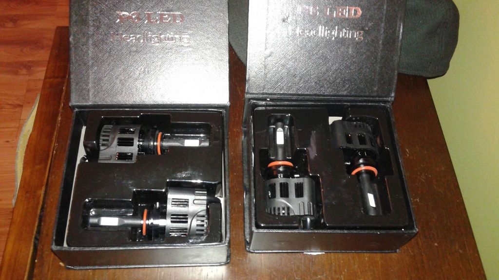

Ok so I got my order in the mail today:
Amazon product
View: https://www.amazon.ca/gp/product/B019MKOAWC/ref=oh_aui_detailpage_o03_s00?ie=UTF8&psc=1
Amazon product
View: https://www.amazon.ca/gp/product/B019MKOA0E/ref=oh_aui_detailpage_o04_s00?ie=UTF8&psc=1

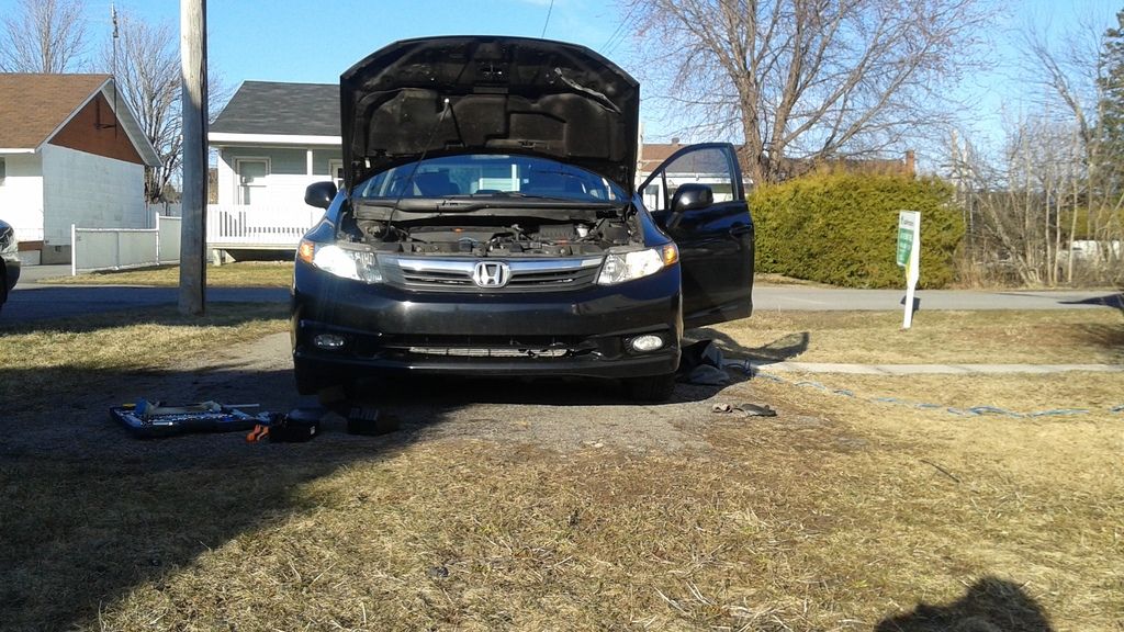

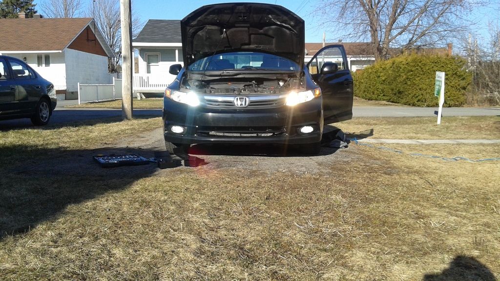

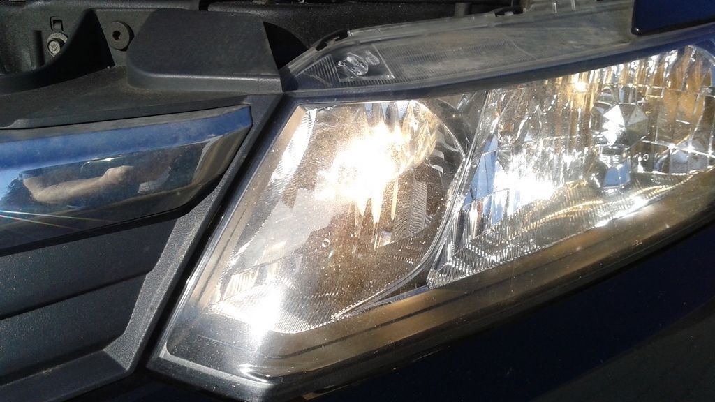

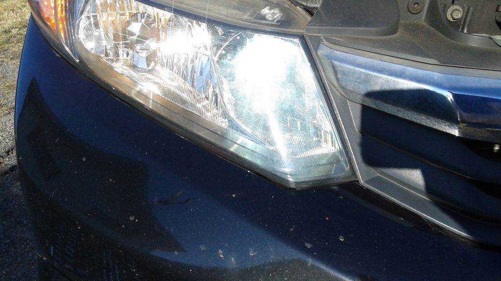

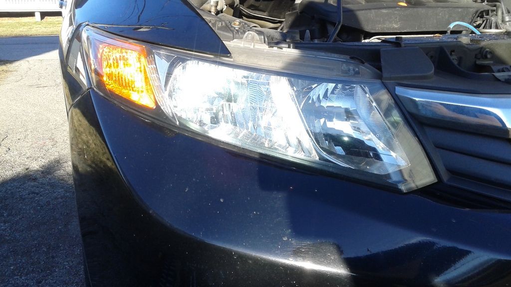

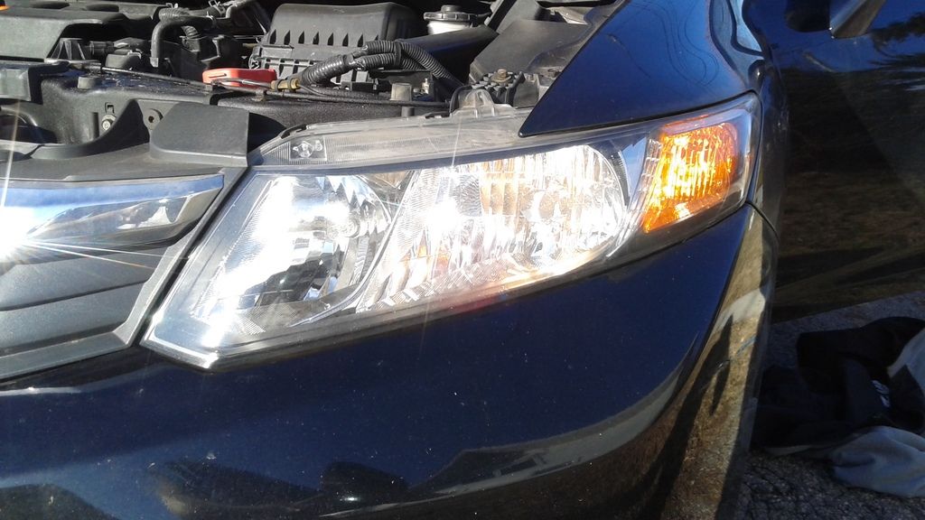

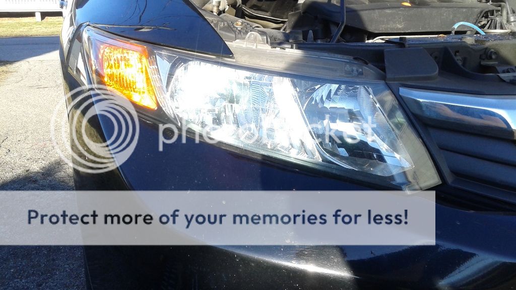

I did the installation, which took about 20 minutes, here are some pics:
(the DRL does not really flickers, the camera made that up...)
Nothing to complain right now, these are bright and have a nice beam pattern (not like projectors though...).
Nice. I will be upgrading my high beam lights soon to LED, really don't like the yellowish glow of conventional 9005s when DRL are on. I will be getting them with resistors so that DRL doesn't trip.
