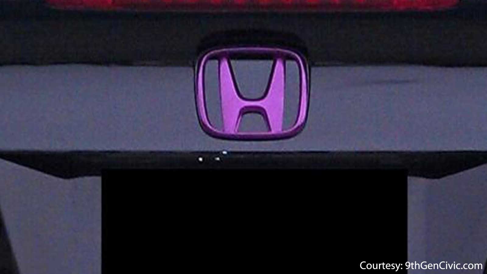

I like this purple . i guess this is a custom pained one? my hands are too big to apply an overlay and i know i will mess it up and on the si part lol
thank you how long did it take to mask it?
Buy a new emblem and spray it off the car. I wouldn't recommend masking off and spraying on the car.
You might be able to remove the emblem with out breaking the pins that hold it in place but it's kinda hard to remove without breaking the pins.
i can just spray them? i don't have to prepare them?
Anytime you paint something you have to prep it. If you want the paint last and even stick, you have to rough it up with something. Then make sure it completely clean before you spray it.
Get some fine steel wool or some 3m scotchbrite pads to scuff it up a little before painting. It'll give the paint something to grab on to.
i will look for all 3 and get them pained and get that light up SI logo for the front ;)
