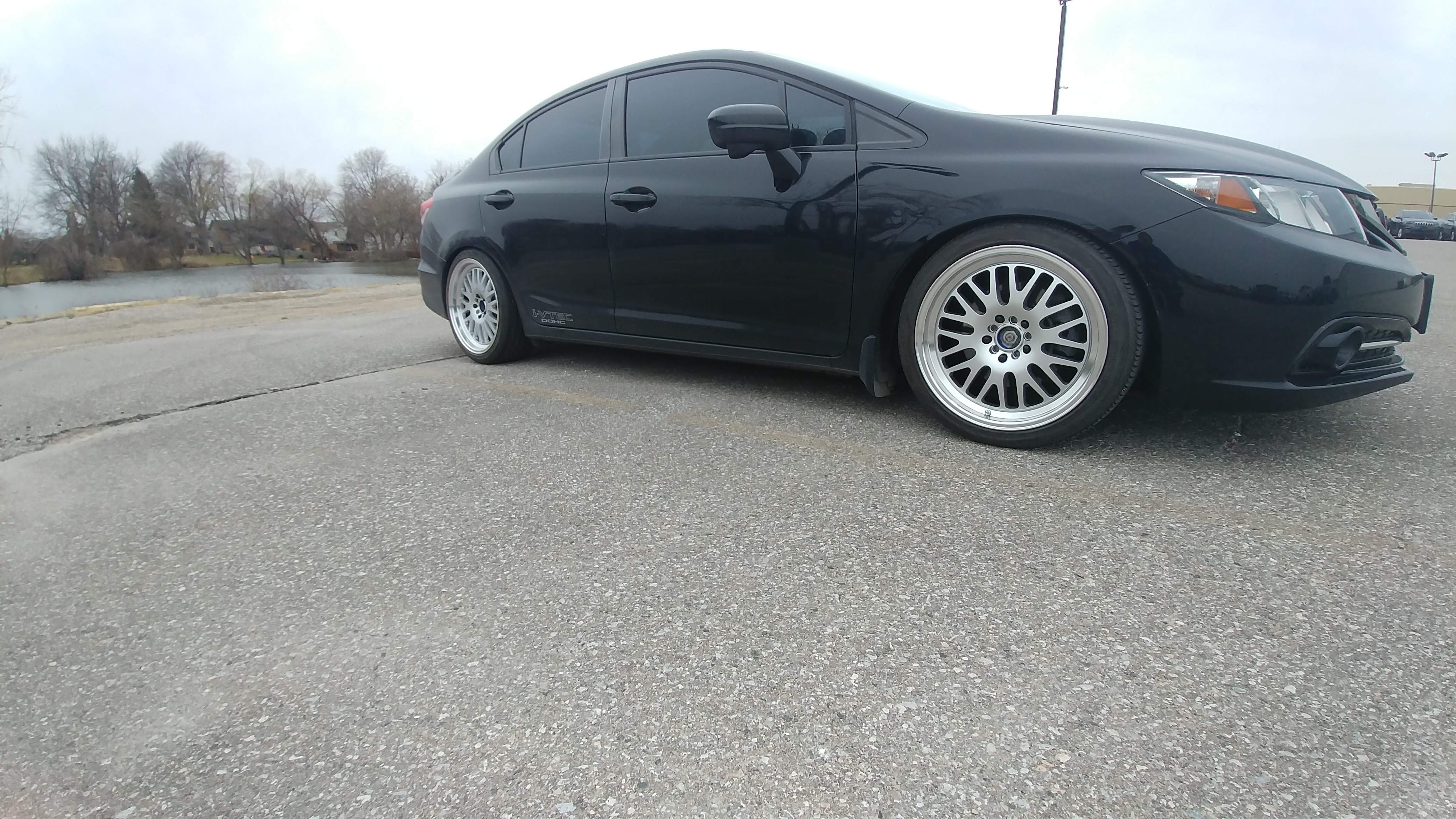

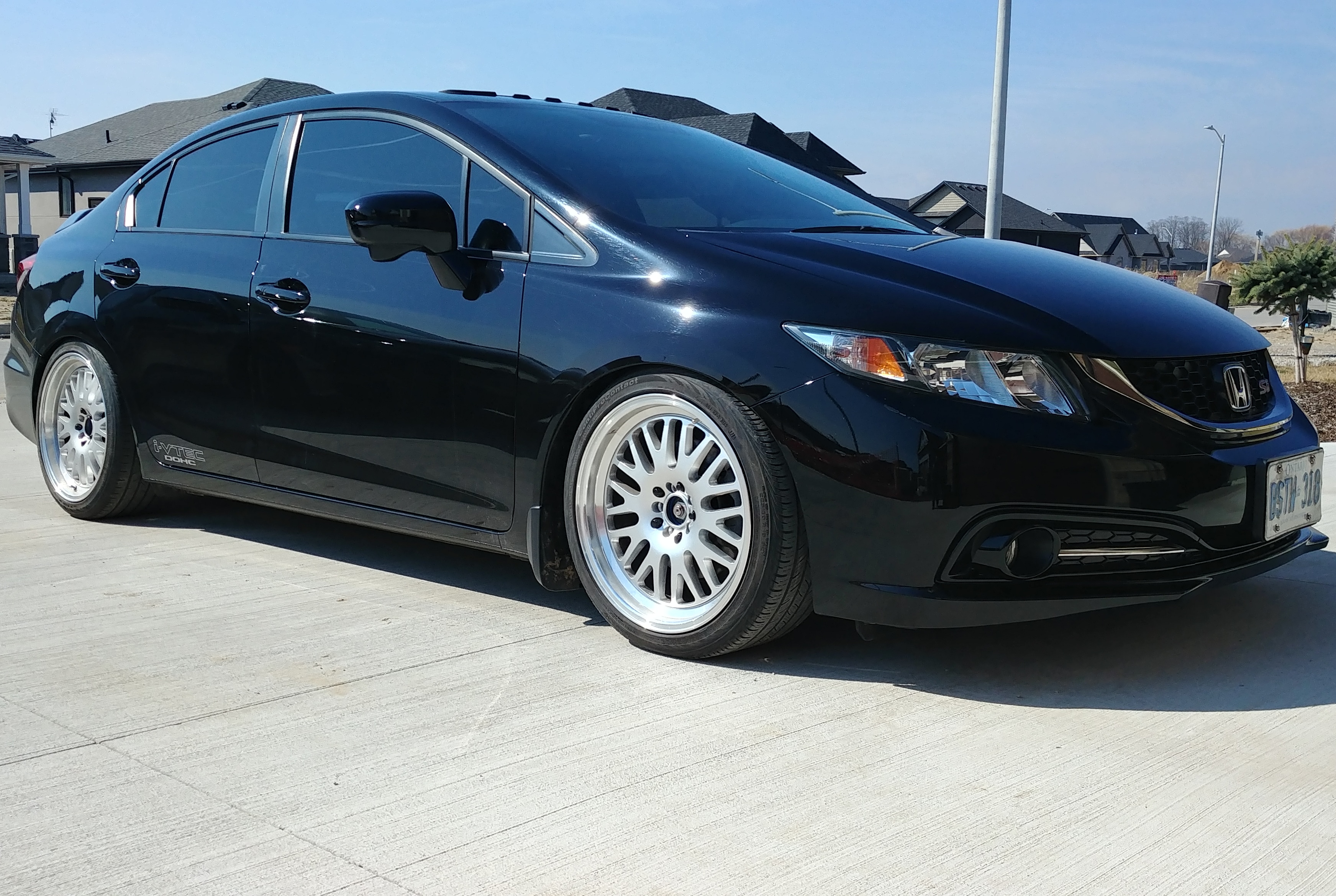

Went with xxr 531 18x8.5 +35. Found them for cheaper than any other rims I liked.
Does anyone use forums anymore? Needs more camber and a little more low .
What tire size? Any rubbing?

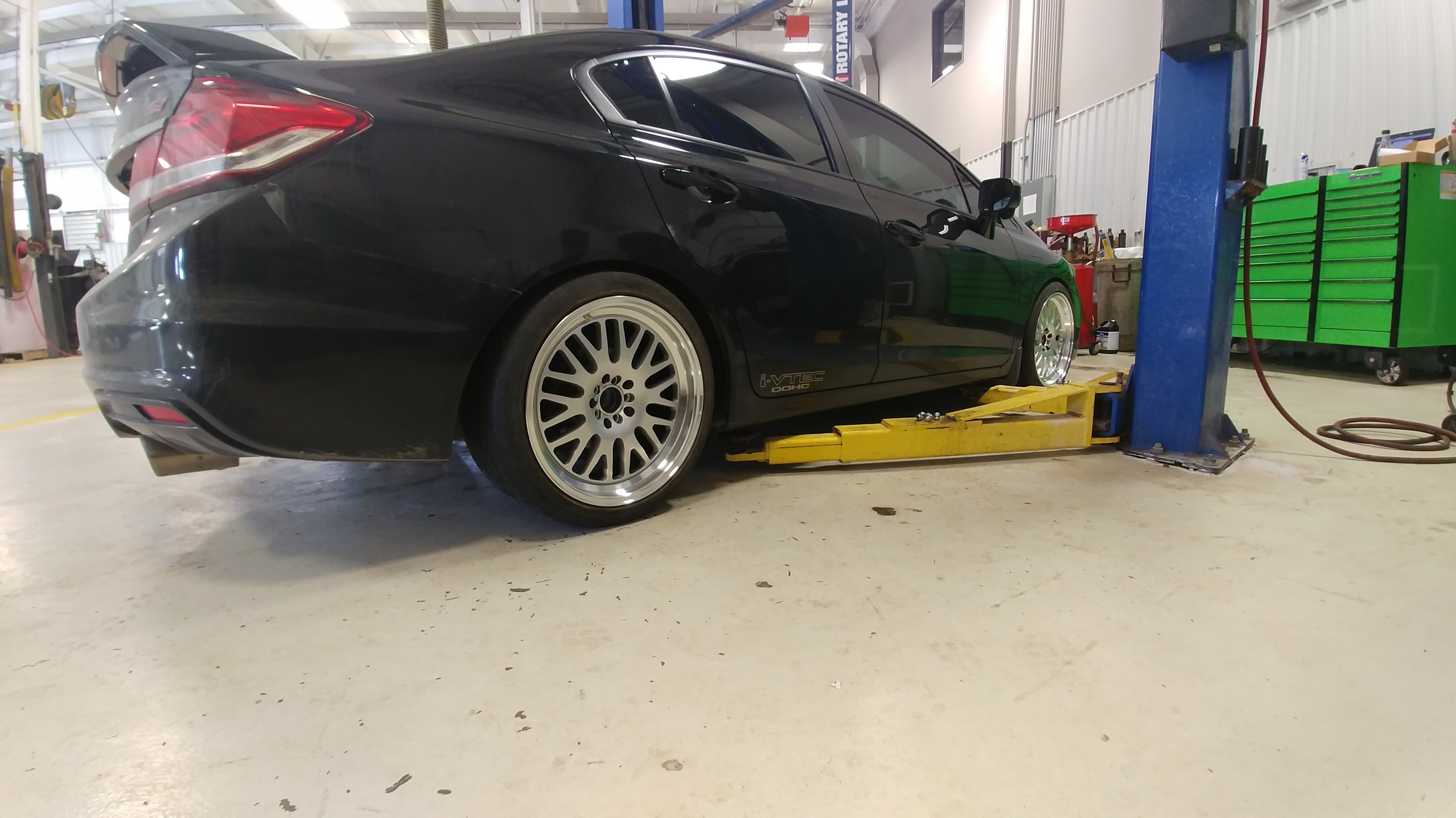

Adjusted front camber all the way with one camber bolt per side. Adjusted rear by eye ( 3 turns from stock specs. Looks around -2 maybe). Hammered front fender liner tabs ( put a dent in one side and I'm a little pissed at myself .) .Drove around my work parking lot doing fast turns and didn't rub. Not sure if I'll have time to set the toe today .tires size is stock 225/40 .

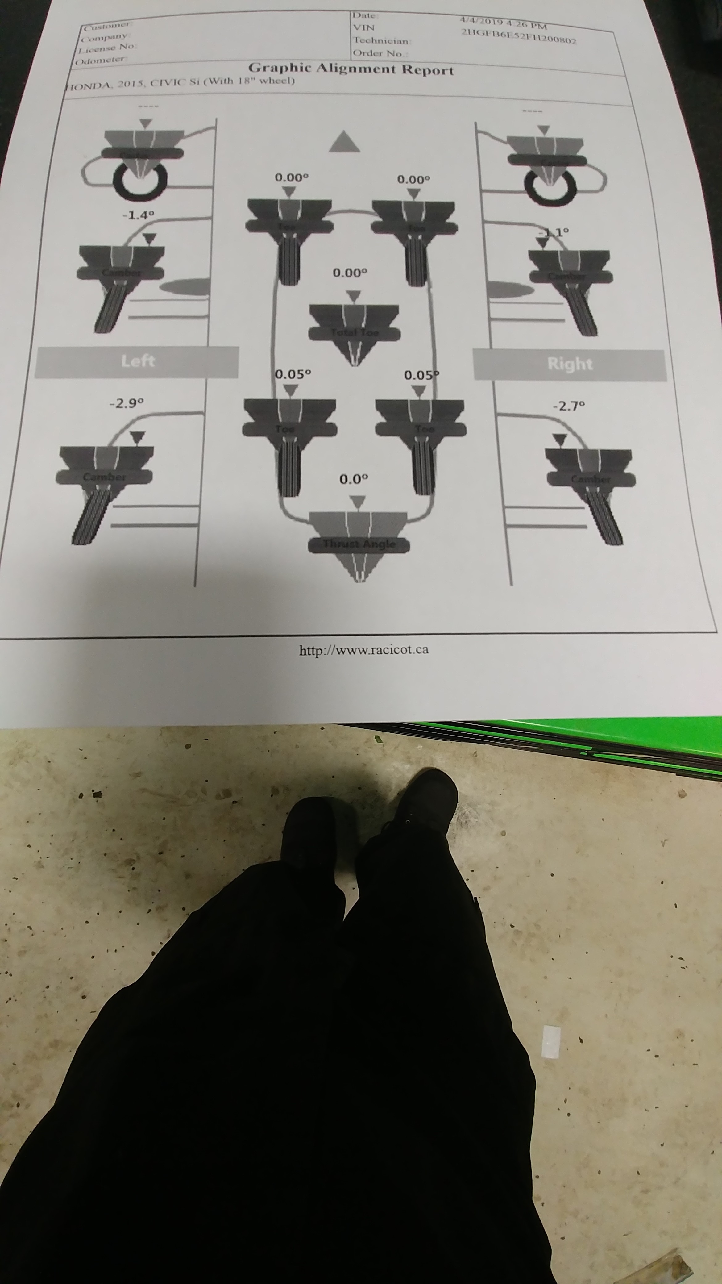

Do u plan on hitting an alignment rack? Also were you rubbing before u worked your fenders?
Yes. I'm a mechanic .just need to find the time to do an alignment, probably end up doing one tomorrow at lunch.
Never tried to drive it before hitting the front fender tabs in.
Did a quick 20 minute alignment. I've got the new style heads that secure to the tires instead of the rims which made it hard to put them on being lowered. Only adjusted the right read camber to make it close to even with the left .Didn't have enough time for the front camber. It was good enough.
Took the bumpier way home and no rubbing .
