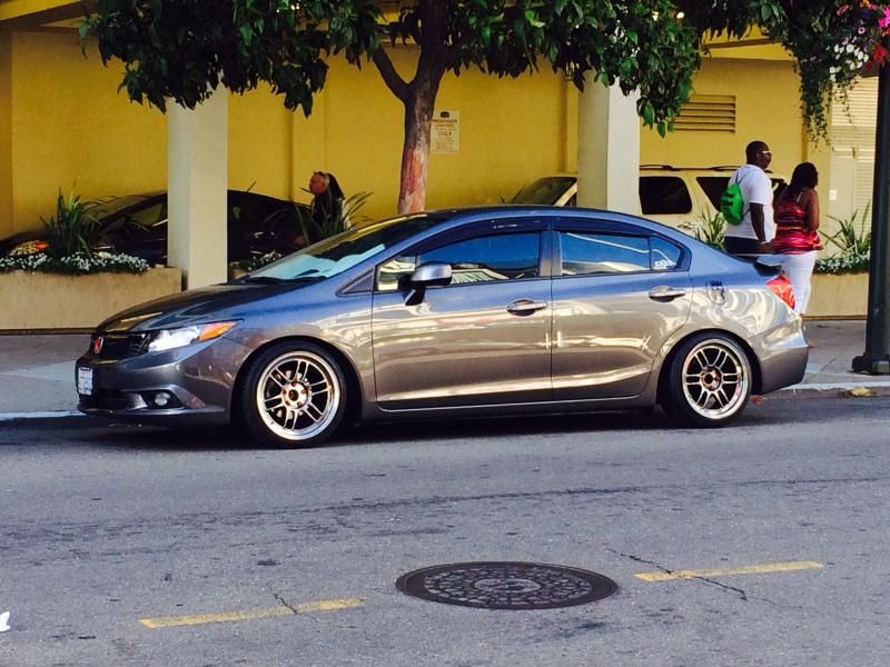

I like them. The low price is mostly what drew me to them. I figured if i didn't like them I'm not out that much. They feel very similar to the stock springs, with the exception of very rough patches it feels a little bouncy but not too bad. downloadfile.jpg
And you will definitely need to get camber arms for the rear. I would suggest the spc arms on Amazon sold as Dorman (they are like 1/4 of the price)http://www.amazon.com/gp/aw/d/B00GJ...ds=521-872&dpPl=1&dpID=41-0vKOPZHL&ref=plSrch
@littleshak
Wow this looks sweet, and those wheels are 18s correct?
Also, would you recommend these rear camber arms if i wanted to go more negative on the back, like -2?
Yes they are 18s and yes the arms have 6° of adjustment +3 to -3

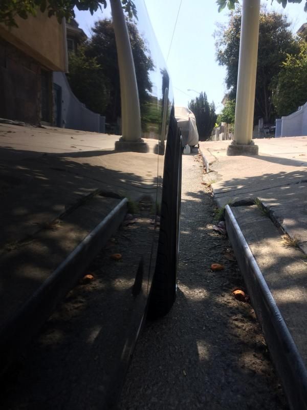

This was when i first put the camber arms on i cranked them all the way in to see what it looked like20151008_173043.jpg
@littleshak
Holy dude that's nice I will probably be running them like that for a little
you think if you were to put some spacers in the back the top of the wheel can align with the fenders without any rubbing problems or anything else?
You've been so much help man I will most probably be buying these things tomorrow, thanks a whole lot
I'm not sure i only set them like that to see what it looked like. I'm not big into the stance thing. You would probably want to talk to someone that is. I had an alignment done about 10 minutes after they were put on. I'm running at -0.75°.
