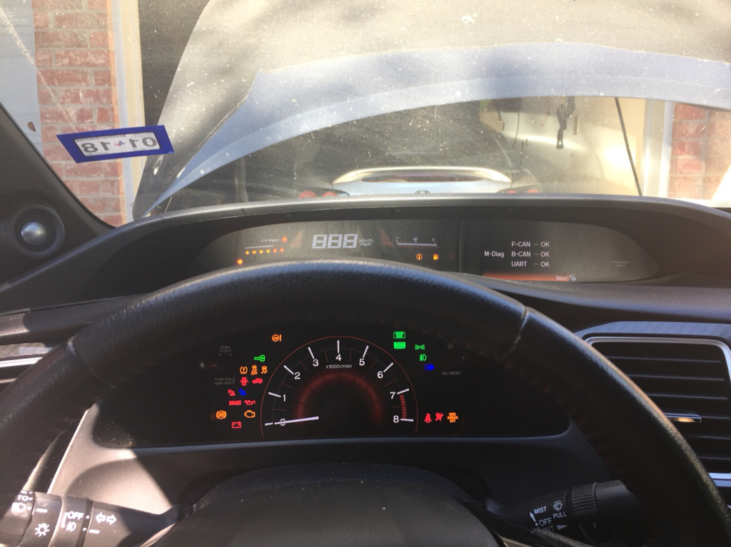

    I have a 2013 Honda Civic si I used to own but sold it to my parents.
    When I had it, it was fbo, flashpro, and rbc swap. I put all the stock parts back and reset the ecu back to stock. It was doing fine for like the longest time till one day the ps light, check engine light, and tpms light came on. When I drove it, it doesn't even mark how fast I'm going and I also notice that it will not go over 4500rpm and won't engage vtec. Any input why it's doing this???

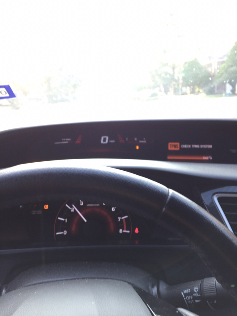

    I disconnected the battery for 30 min. Check engine light went away and I can now go over 4500rpm/engage vtec however it still doesn't mark how fast I'm going and tpms light/ ps light still shows.

    When you say it doesn't say how fast you are going, are you saying the speedometer reading is blank when driving? Or it's just showing "0"mph when you're driving around?
  8. SimplicityFB6
    SimplicityFB6 Well-Known Member
    Messages:
    101
    Location:
    Houston, Tx
    Vehicle Model:
    Civic
    Body Style:
    Si
    Yes, it just says 0mph
