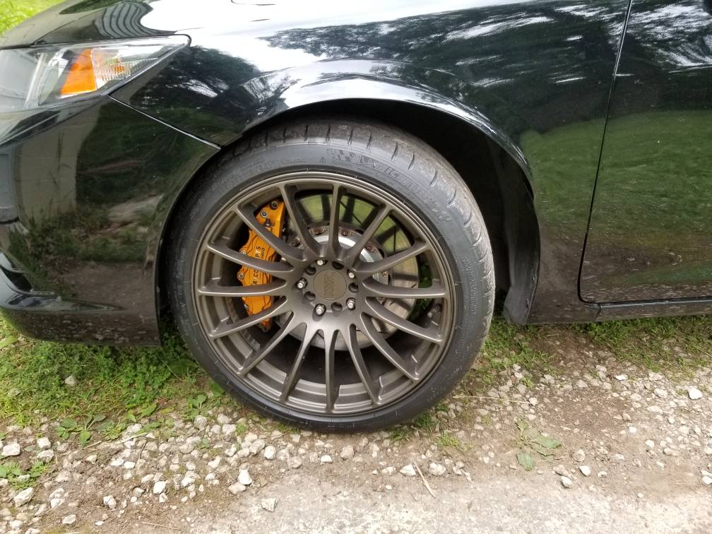

    I personally have fit a 12.8" rotor (325mm) rotor inside a 17" wheel using an AP Racing CP8350 caliper and a custom bracket. You can probably squeeze up to 13" but that's about it (unless you go to something super-exotic). Most brake manufacturers will recommend a minimum 3mm clearance all around the caliper (caliper to the inside of the rim barrel, and from the outside of the caliper to the inside of the wheel spokes). Check the picture below - it's not a straight-on shot, but you get the idea. It's pretty darn close, especially when you see how close the stuck-on wheel weights can get.
    Aftermarket BBK manufacturers will generally provide a brake template which will allow you to check for proper clearance inside your wheels before ordering their brakes.[​IMG]

    Surprised nobody mentioned me.[​IMG]
    Sent from my SM-N950U using Tapatalk

    You have 18" wheels though, right?
    OP has 17" wheels.

    My setup was the biggest thing I could run on 18s, but the company I went with offers customs kits in every size.
