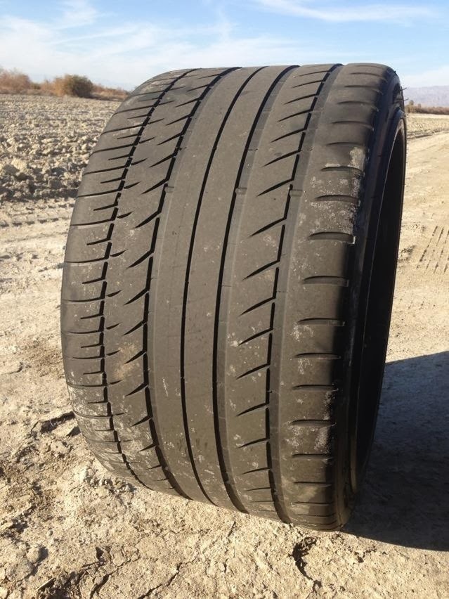

235/40/17 tires (really meant for 17x8) will fit just fine on 17x7 or 17x7.5.

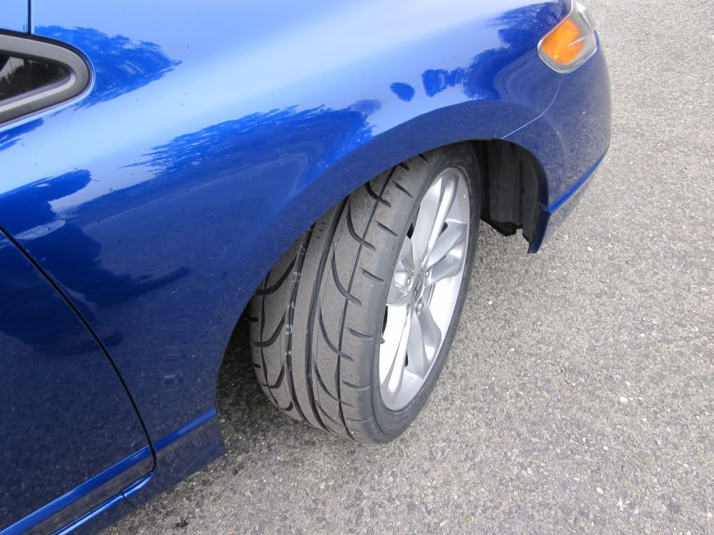

Here's a pic of a stock FA5 with 235/40/17 Dunlop SS.

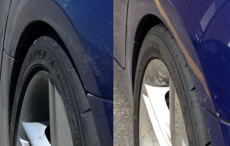

Tires can run wider than stated as well. For comparison both sets of tires are Dunlop Direzzas in a 255 width.
The LEFT stack is the new Z2 which replaces the RIGHT stack of Z1 Star Specs. Both tires are the same width. Major difference even from the same company. Although the Direzza has long been known as a "cheater" tire since it runs significantly wider than stated.
On the Dunlop Japan site they listed Direzzas with most sizes running 2 to 7 mm wider than indicated. For example, 265/35/18 is listed as 272 mm wide, which makes it a definite cheater tire! Looking at the stack of fours in the picture and the fit below makes it very likely that they Direzza ZIIs even wider than that.
