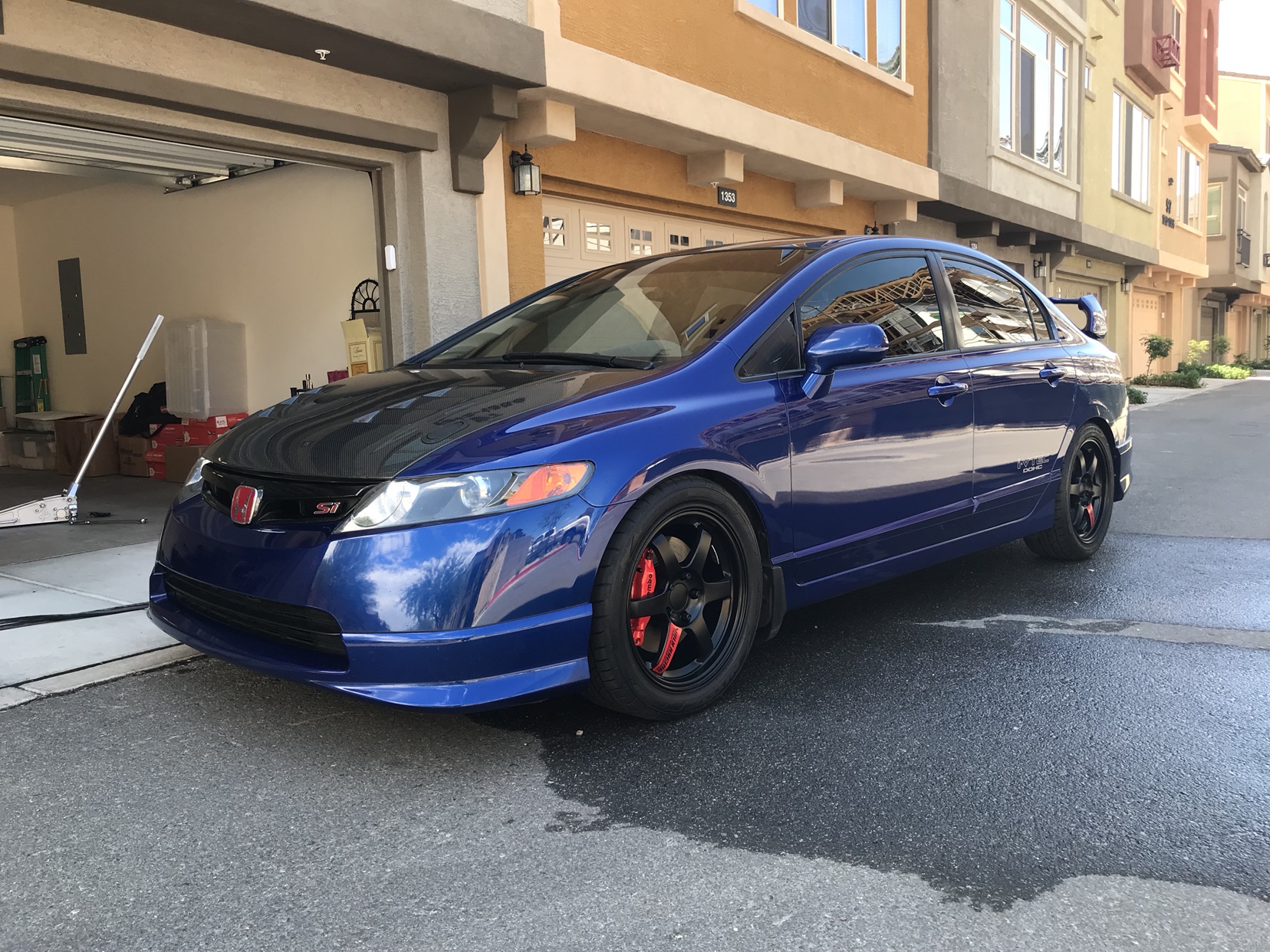

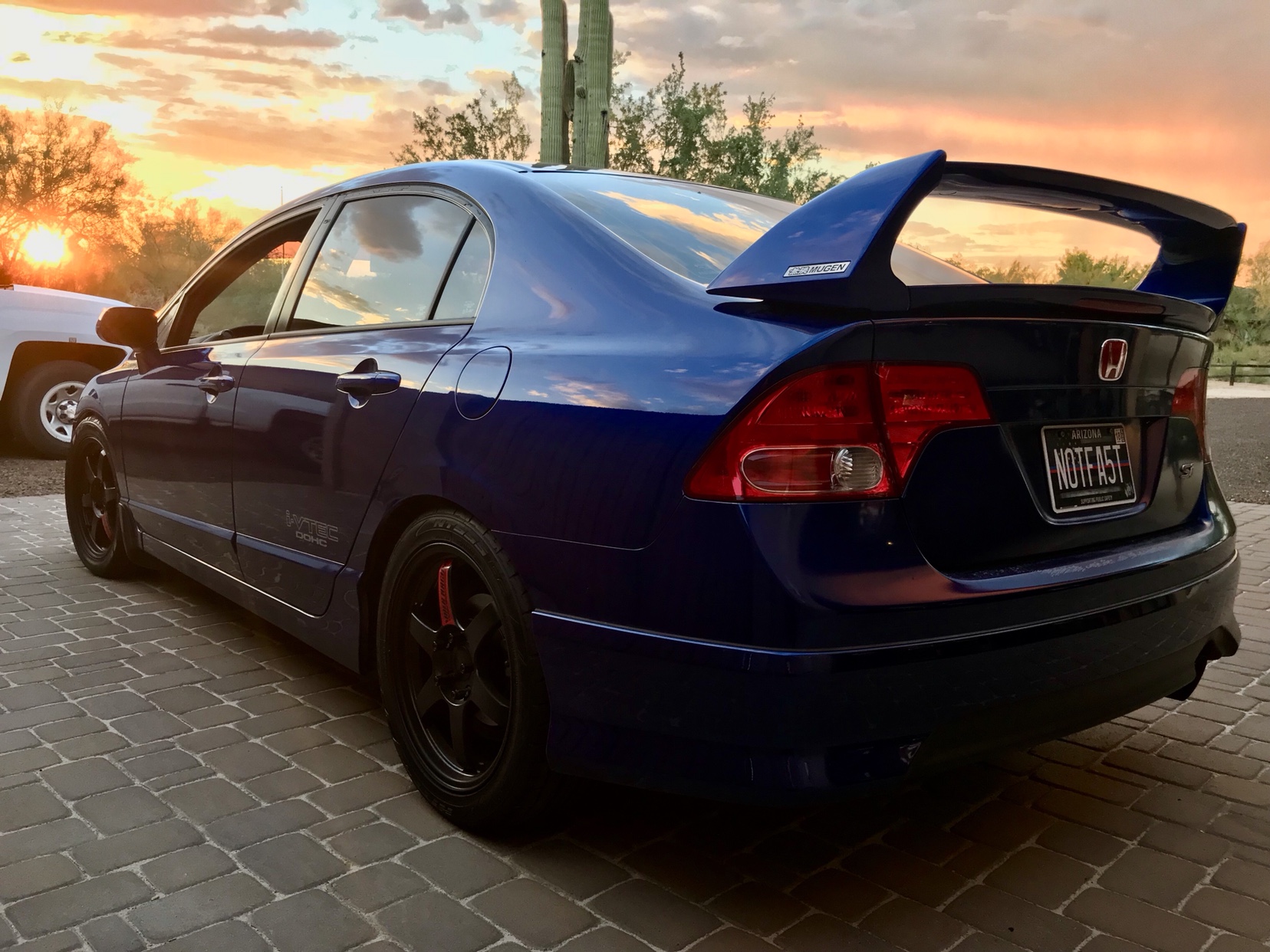

Put on my OEM Mugen wing and detailed the car

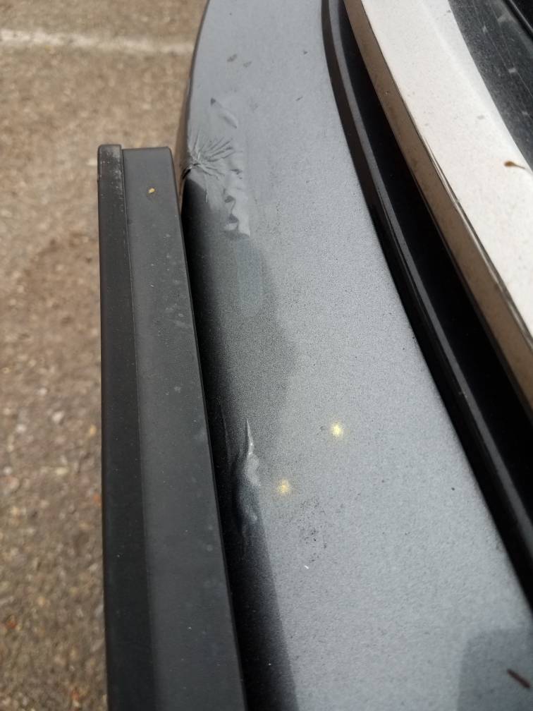

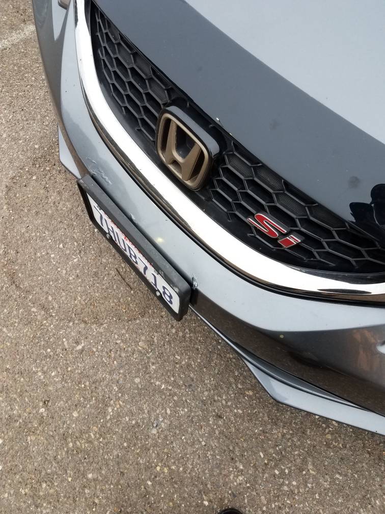

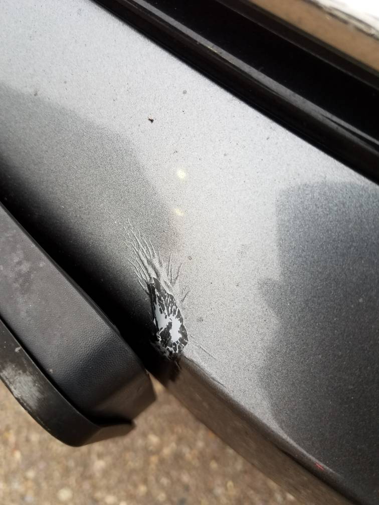

Person parked in front of me backed into me I guess..I'm sad..should I leave it?

Wow, that really separated the bond between the paint and the bumper. The bubbled paint will chip off sooner or later. I'd say it's up to you if you really want to get the professional paint work done on it.

Anything I can do?..should I pop it, sand it, and make some sort of plastidip/gloss paint job to make it look sort of Tuner? Idk..im still sad

It doesn't look like there's anything to pop out. A DIY will be tough to do especially on that plastic bumper. You'll need different grit sandpapers, a body filler that sticks to abs, adhesion promoter (which is basically a plastic/abs primer), paint, clear. Touch-up paint will not mask the damage too well.

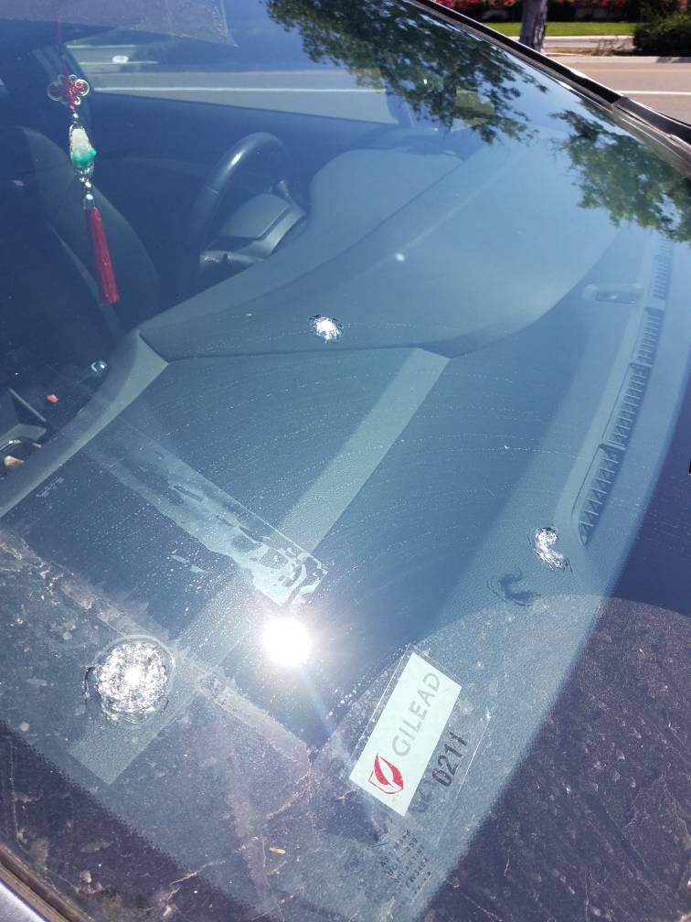

Worst freaking day. 3 cracks when I got off work

Dude. Someday shooting bb's at ur car?!?! The hell man?!?! Bad week for u huh?
