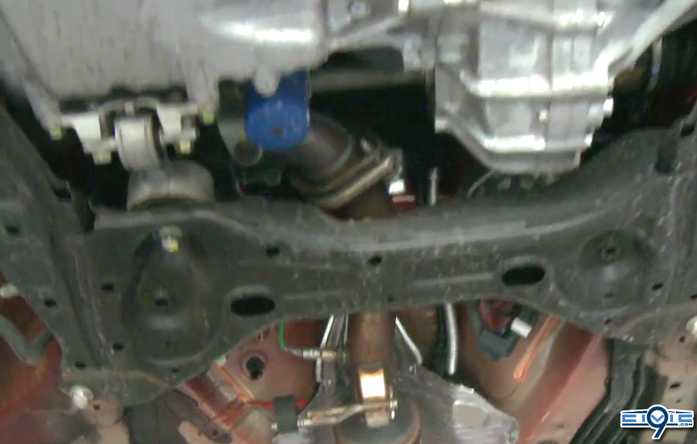

from a vid - showing subframe design you can see the filter?

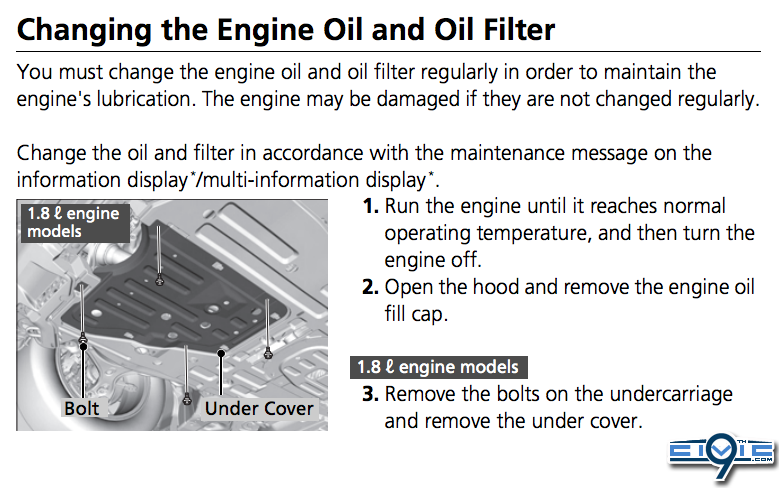

My dealer offered my first oil change for free, so I asked if I could watch and that's when I saw the tech had to remove an under carrage cover plate (four screws) in order to access the oil filter. I probably should have asked him if this was really needed, but assumed a Honda tech would always say yes it's there for a reason.
Couldn’t find a pic ... did grab this excerpt from another 9thgen forum regarding the oil change: Step 4 references the cover.

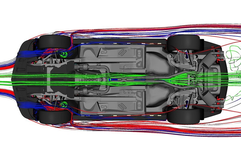

I just realized you have the r18 engine. I was showing pics of the SI engine above. The r18 engine is a different situation. It has a panel over the oil filter area as you mentioned. It's my understanding that it's used to improve gas milage. Essentially it's used for smoothing out the air flow under the car by having the panel in place.
ahhh .... very interesting ....improved gas mileage .... thanks again Webby!!
My BMW has one of those too....mine is missing, lol
It' really isn't that difficult to remove. You need a large phillips-head screwdriver (#4), and it slides in/out. webby is prbly correct it must help with aerodynamics.
