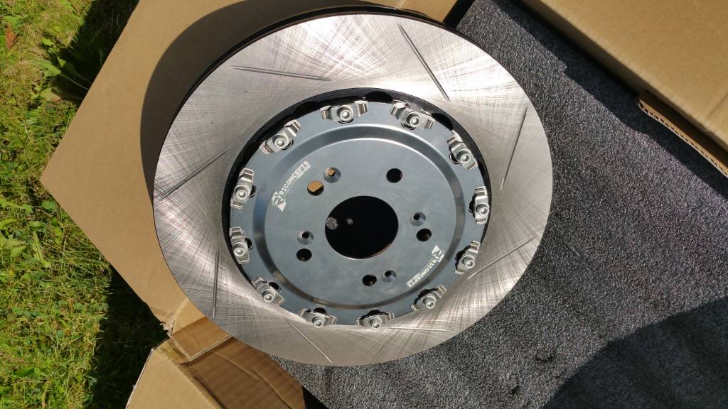

    My calipers are... a little different. The only way they could seize like that would be if they stayed clamped after I stepped on the pedal, which in this occurrence I made sure not to do at all so that couldn't be a possibility.
    The only thing it could be on my brakes are if the floating ties holding the two piece rotors together are coming loose, and that doesn't seem to be the case (not to mention the manufacturer basically said that doesn't happen due to how tight they are fastened when they produce them). 20160920_155926.jpg
    Sent from my SM-N950U using Tapatalk
