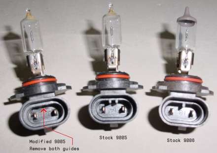

OK so I got my PIAA 9006 bulbs in the mail today. Excited. Went out to me Civic, popped the hood and removed the easy bulb first (passenger side). Took one of the PIAA's out and went to install it. Not fitting. Tried again. Not going in. Hmm am I doing something wrong? Nope inside the fitting of the original bulb there are 2 slots that line up with the housing. On the PIAA's there is only one. Now I read somewhere that someone just switched bulbs in the housing. I gently pulled to see if it would move and no can do. I'm not risking breaking one of these bulbs. My only solution is to file down the center piece of the PIAA bulbs and then it would allow to fit. I have attached photos describing what I have been rambling about. Any other suggestions?http://www.***************/forum/attachments/appearance-body-modifications/5319d1335551641-piaa-headlight-hb4-9006-piaa-ion-crystal-fogs-h11-img_0035%5B1%5D.jpg

That looks like a 9005. I know cuz I retrofitted my 9006 silverstar to fit a 9005 plug. Lol. Check the back label of the bulb and it will tell you what type it is.
High beams or Low beams? Did you see if it fits in the other beam slot? Maybe they just sent the wrong one?
High beams are 9005
Low are 9006
Correct me if Im wrong.
which bulbs are you trying to change? the lowbeams are 9006, but the high beams are 9005. the bulb and connector your pulled out are for the high beams, which is why the new bulbs don't fit.

as they've said ^^ the 9005 is the high beam bulb. You need the low beam
headlight:
Low:HB4 which is 9006
High:HB3 which is 9005
I will look today. That does make sense. I just grabbed the first one I saw. Lol. I appreciate all the help. Keep you posted if I'm a total tool.
So I did have a chance to go home and take another look under the hood. It didn't even dawn on me to look for a second bulb. I did find the low beam ones (9006) and was able to replace them. My hands are now sore as hell. It was not fun. Definetly took some contortionism on my part. When I get out to break tonight, I will see how they look in the dark for the first time. I'm hoping nice. Thanks for all the feedback, it really helped.
