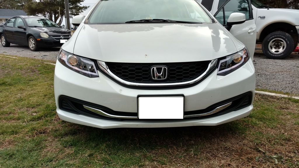

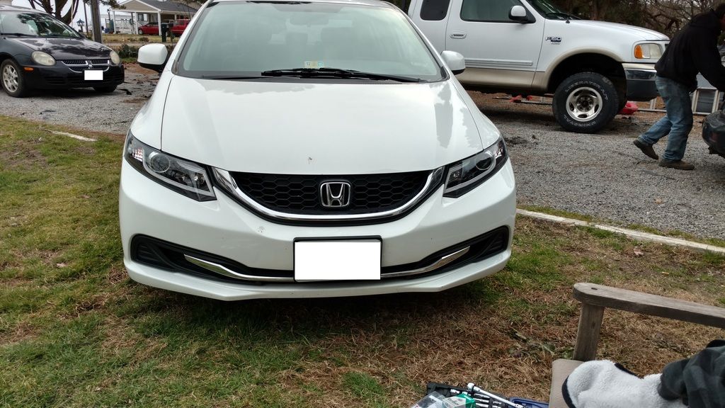

OK they are in the car. I know the car is kind of dirty, sorry. I'm in the country at the second and it became target for birds. Do the lights seem kind of dim or is it just because I'm in the daylight? I'm talking about the LED strip. First picture is with the lights off.
They look really nice! Not really sure how bright they are suppose to get. Did you wire them up to the drls or to an accessory fuse?
DRLs. Just not sure if I should of went before the harness. I spliced them in right behind the headlight housing into the light itself. Should I of gone before the harness, further away from the light? I'm thinking of rerunning them to be on full time anyhow. I saw on the forums someone said you could do "add a circuit" adapters and connect to fuse box that way.
Since I don't have these lights I can't speak form experience. From what I have read about them is that if they are wired up to the drls they will not receive the proper amount of power since the drls are also the high beams. Therefore the drls run at half power and if you wired the leds into them then they are only receiving half the power necessary to run them. I do plan on getting them and, using an adapter, wiring them into an accessory circuit.
I'll probably switch my to an accessory circuit as well. I would rather have it ran that way anyhow. This was just a quick wire. The anticipation was killing me. Any suggestions on which accessory circuit/fuse I should use the add a circuit adapter on? Sorry for all the questions. Just getting into the whole switching out parts thing and want to make sure I get it right. I've done some research but I'm guessing I'm using some of the wrong terminology.
