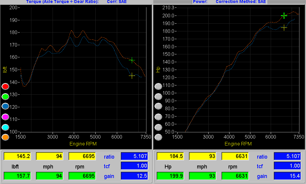

    Does reflash yield any performance benefits on a stock car?

  7. Scuderi

    Thanks web. I'm kind of confused looking at the graphs though. The two lines on each graph... are those just 2 different trials to show consistency? Also, I think its just because I'm not fully understanding the graphs, but Hondata reduces torque at lower RPMs? Thanks a lot!

    The two lines are before/after. Blue is before...red is after reflash. The readings below 2k or so are pretty much bs on most dyno graphs. It gained 12torque and 15hp on their dyno. Left side is torque and the right side is horsepower.
    Scuderi likes this.
