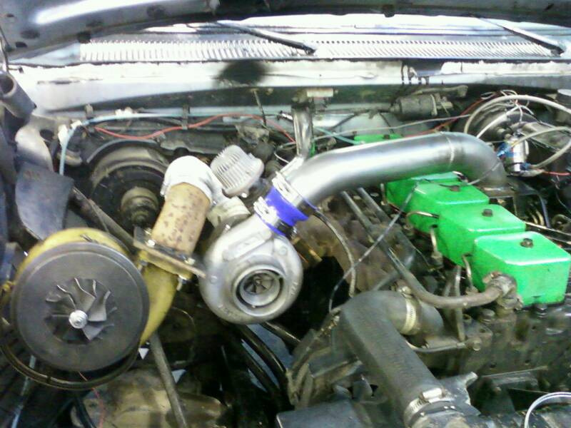

Thanks I'm use to boosting diesels so 20 psi is nothing on them so with 10 psi how much power do u think I could get out of a stock r18

What kit did u use bc thats all I want is some fun out of it she done handles like she is on rails
