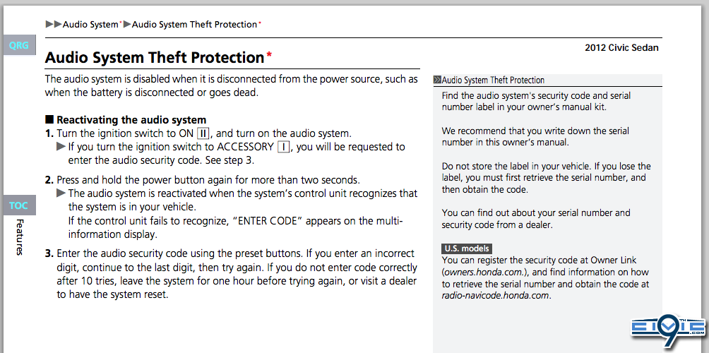

I don't need it right now but don't recall seeing it anywhere in to info packet I was given at the dealer and don't see any sticker in the glove box. I'd like to write it in the owners manual in case/when I need it. Is there anyway to pull the code out of the radio now or do I need to go by the dealer or?

Update: went by the dealer today as I was in the area and asked. The salesman walked me over to the service guy. When he looked at the car he said "that model doesn't use a radio code, they stopped using them on the 2012 civics.". It kinda makes sense given without the imid dash display, it would be a totally useless radio to anyone. Not sure if this only applies to the LX as the manual has a section about the radio code, maybe the DX or EX with Nav still has one?

yeah, I don't know why I didn't just look it up in the manual - it has a code.
All models still have a code - but it is for the most part redundant now. When the battery has been disconnected all that is required is to press and hold the power button on the audio unit for two seconds to restart the unit. To get the code you need the serial number from the audio or navi unit. For the audio unit, with the unit off, press and hold preset buttons 1 & 6 and turn the unit on - it will display an eight digit serial number. Take that number to you dealer with proof of ownership and they can supply you with the code. We don't charge for this, but some dealers may.
