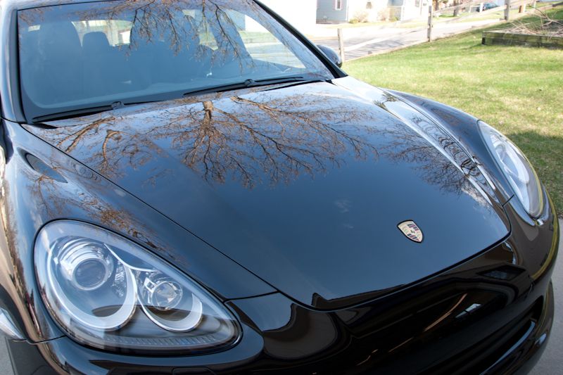

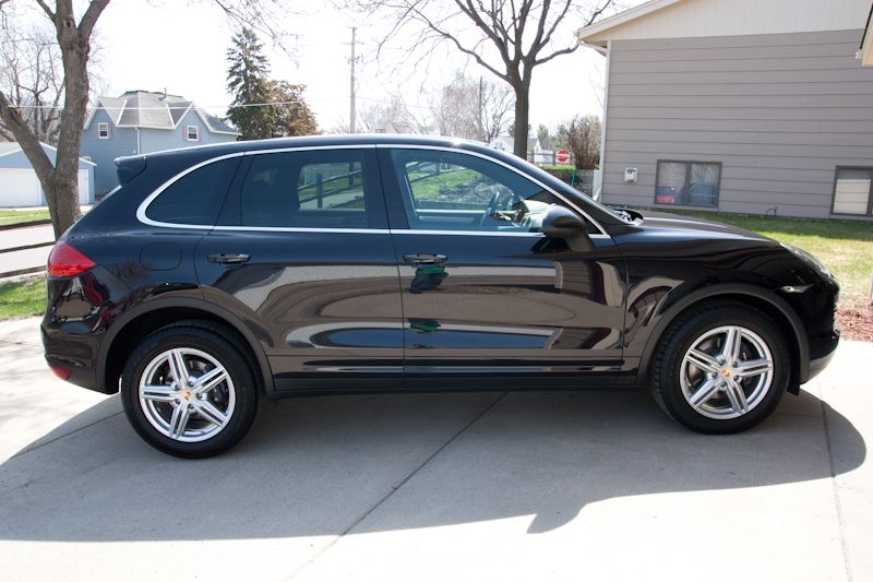

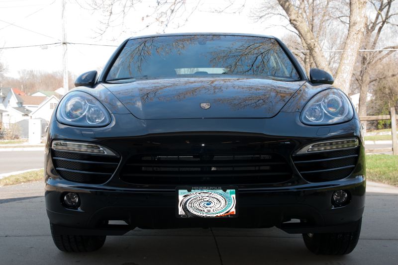

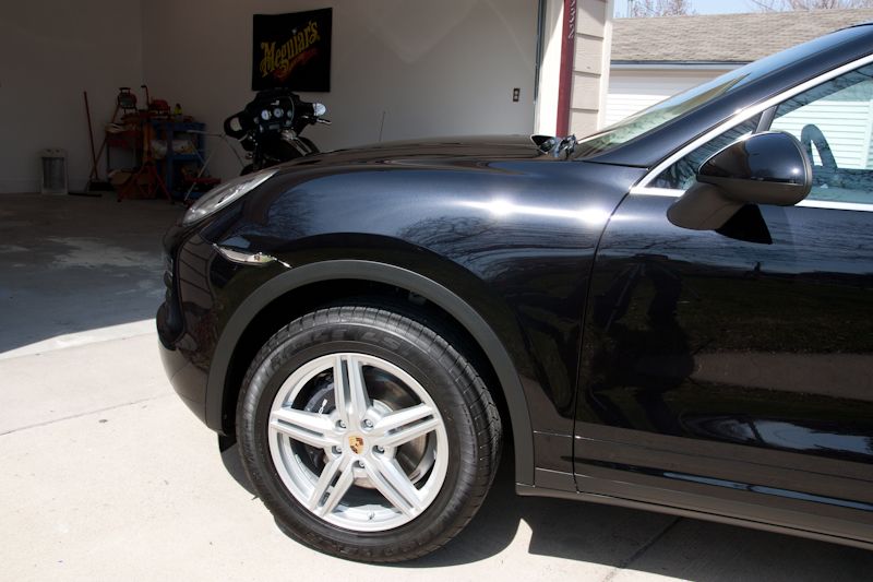

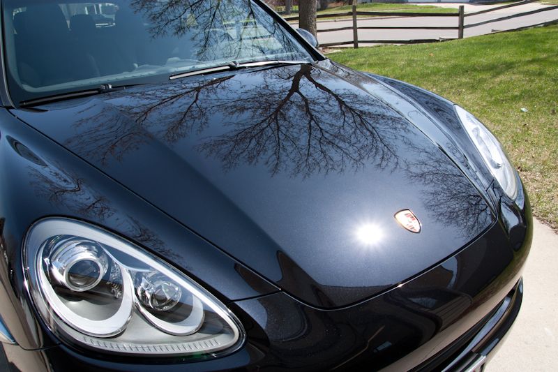

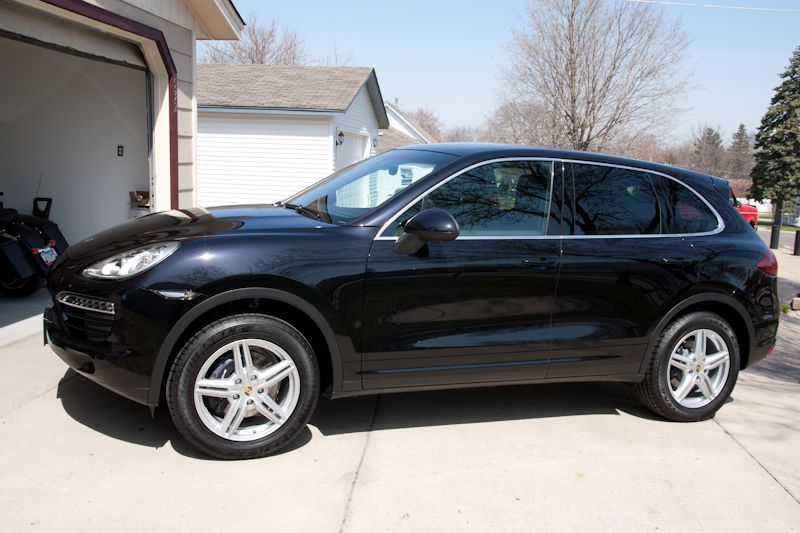

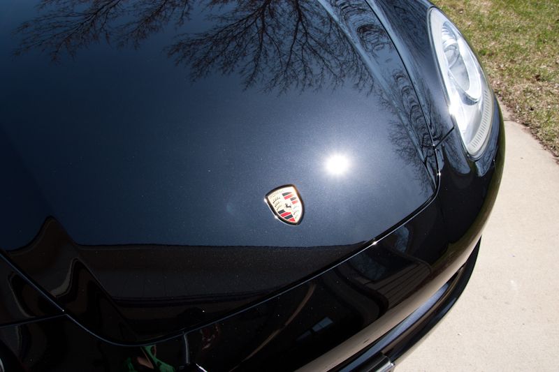

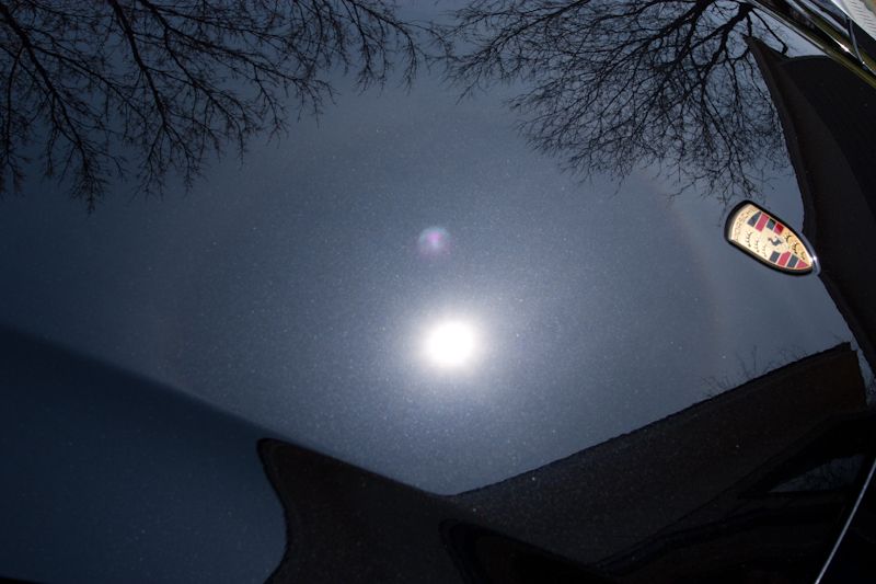

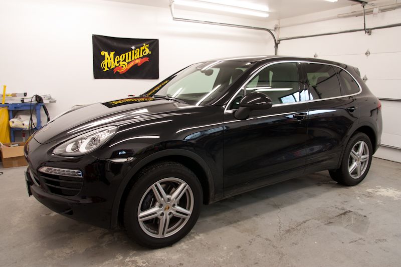

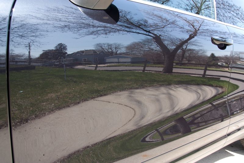

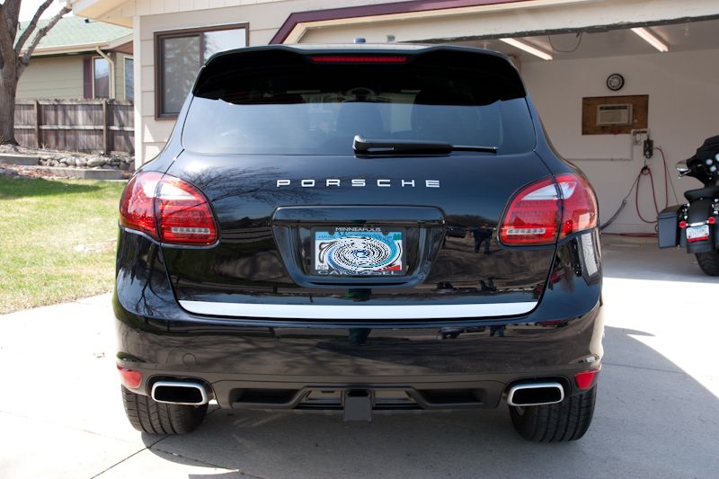

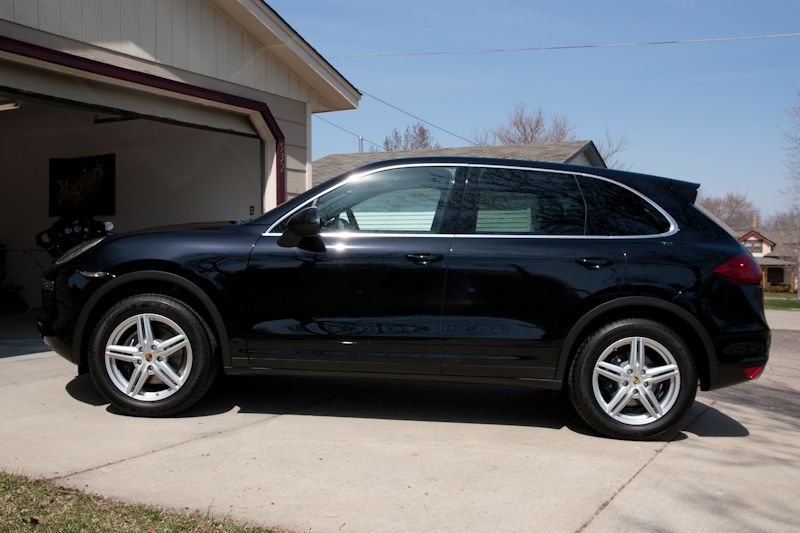

2011 Cayenne, paint correction & Opti-Guard protection
The owner of this vehicle contacted me last winter about getting his new Porsche into the condition it should be. As you can see it had some significant wash induced marring and a few RIDS thanks to the dealers “hand washing”. ;)
Process:
Washing - Foam bath with CGCW at paint prep ration and 2BM wash
Wheels - Sonax Full Effect Wheel cleaner on wheels with various brushes
Claying - Meguiar’s clay and ONR as lube
Paint Correction step 1 - Meguiars M105 via DA and Surbuf pads
Paint Correction step 2 - Meguiars M105 via DA and Meguiar’s MF pads
Paint Correction step 3 - Meguiars M205 via DA and LC tangerine foam pads
Prep for coating – Foam bath with CGCW and Optimum Power Clean followed by an IPA wipe-down
Paint protection – Optimum Opti-Guard, applied with foam applicator. (All paint, trim, and wheel coated)

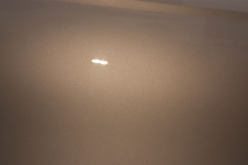

The paint on this Porsche was actually VERY hard, which is not what I’ve typically experienced with Porsche paint and correction was slow going. I had to make several passes with the Surbuf pads/M105 to remove some of the deeper defects. The initial step finished down pretty well but did leave a slight haze and a LOT of dust. My second step with M105 and MF pads was to remove the marring and to chase down any remaining deep scratches…this left the paint pretty much LSP ready and the final finishing step with M205 went pretty quick.

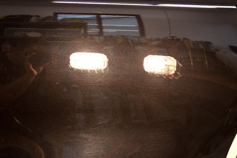

Before pics

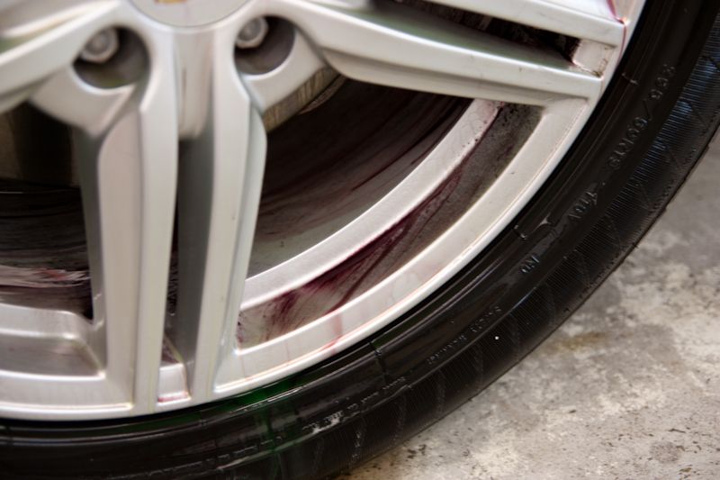

Sonax doing its job.

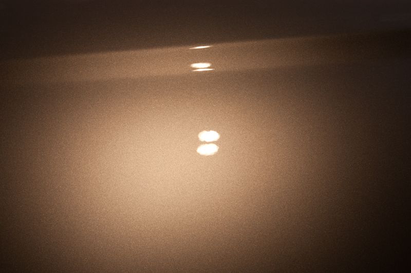

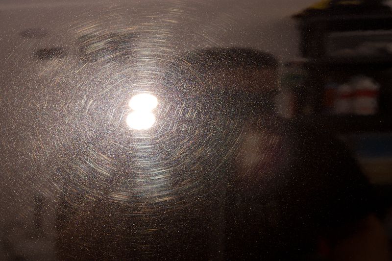

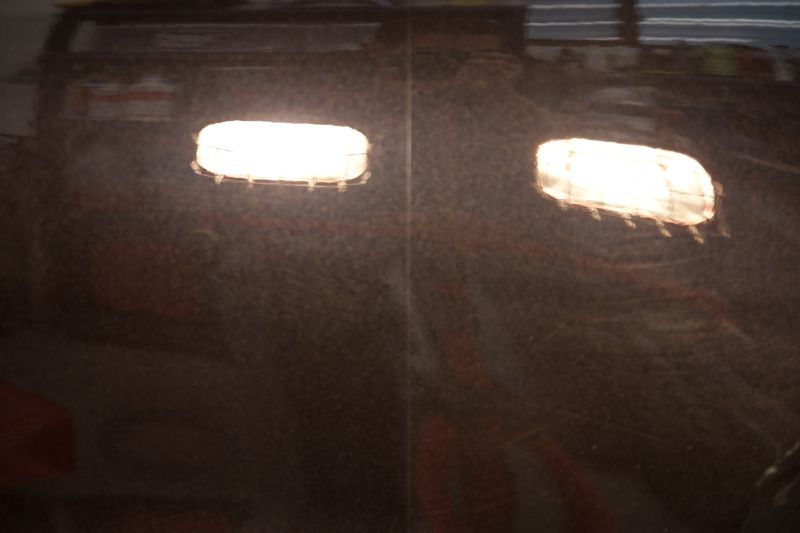

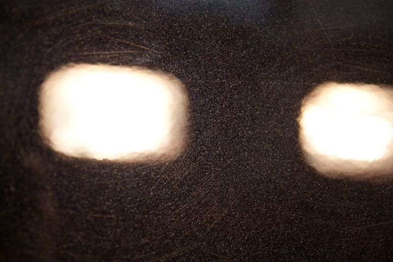

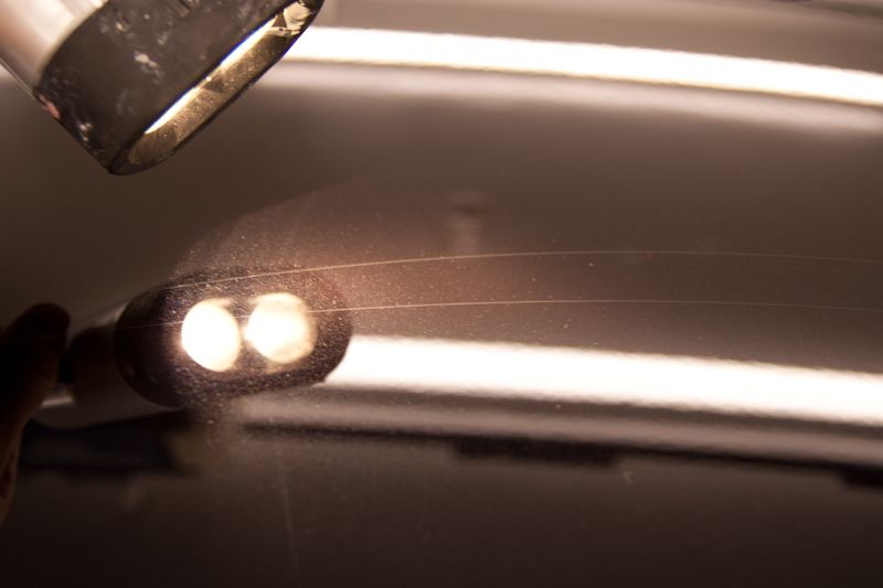

Paint condition
Deep scratches

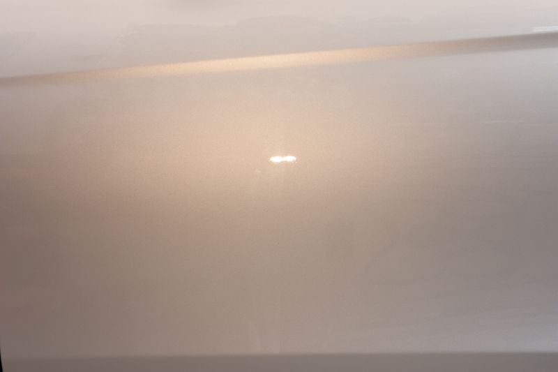

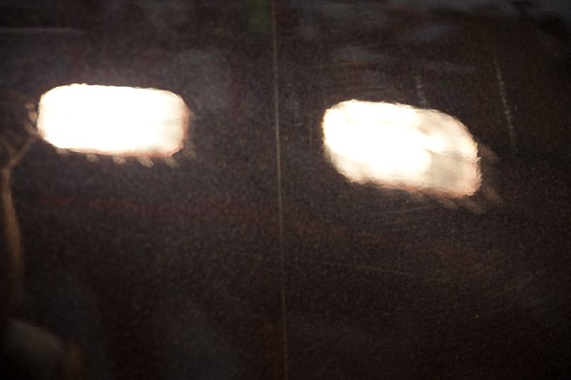

50/50 shots after just the Surbuf….pics didn’t turn out very well. :(

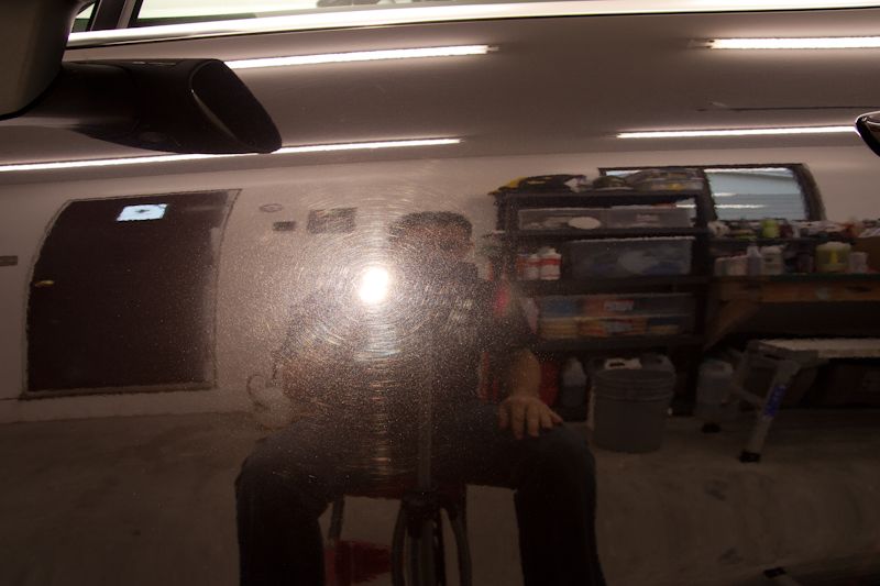

After M105 on the MF pads

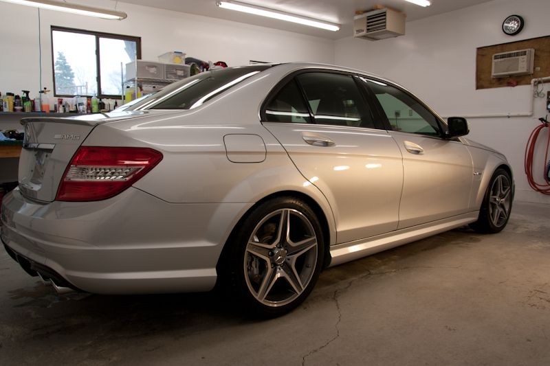

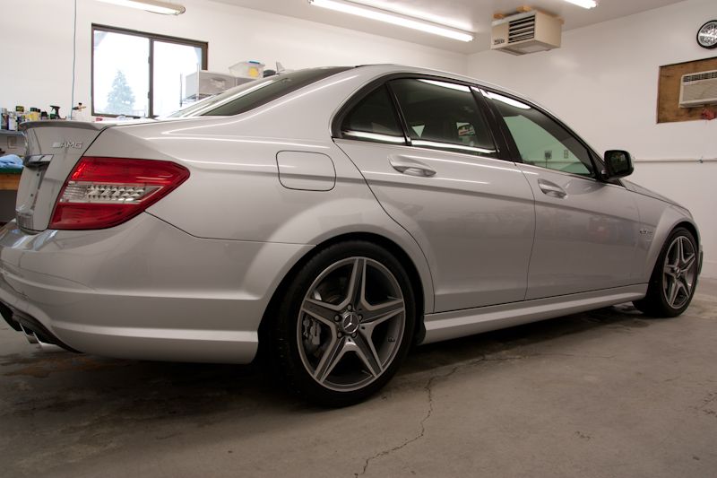

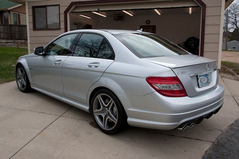

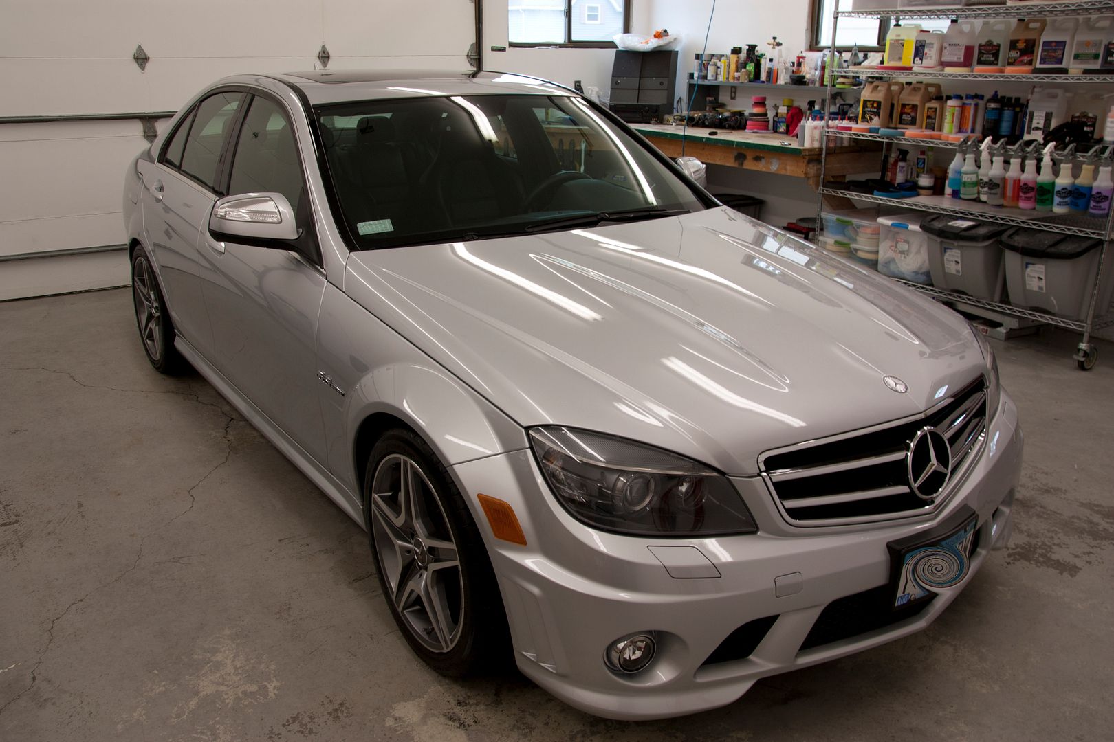

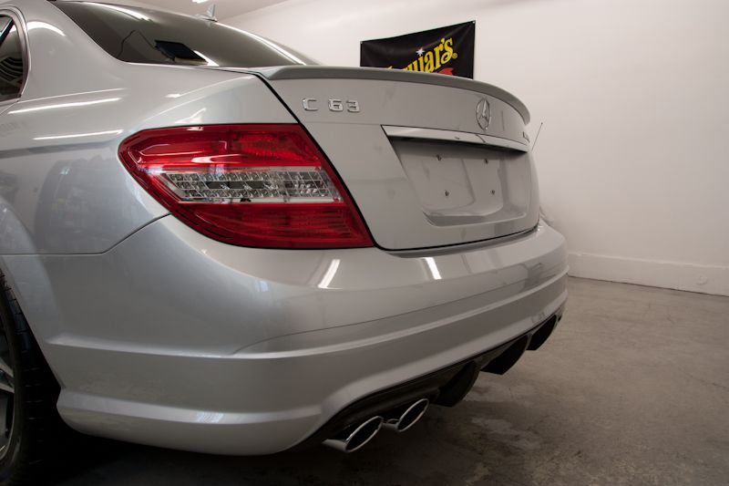

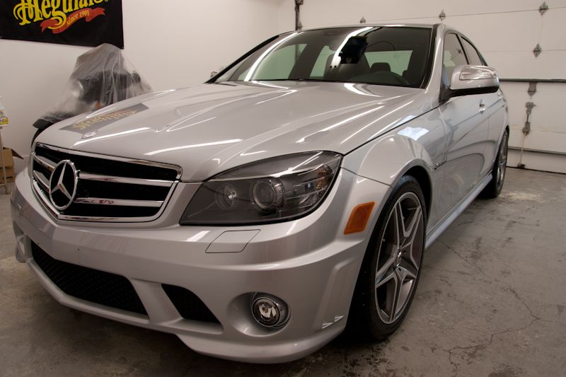

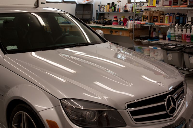

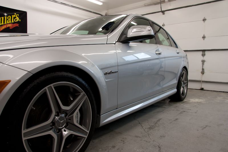

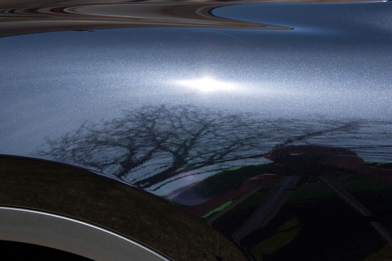

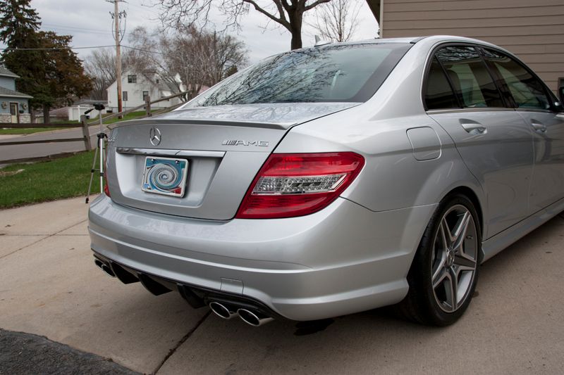

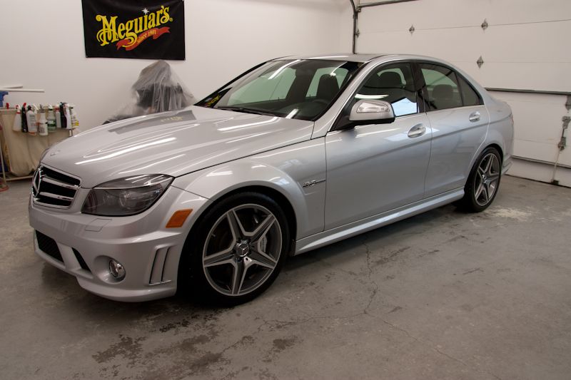

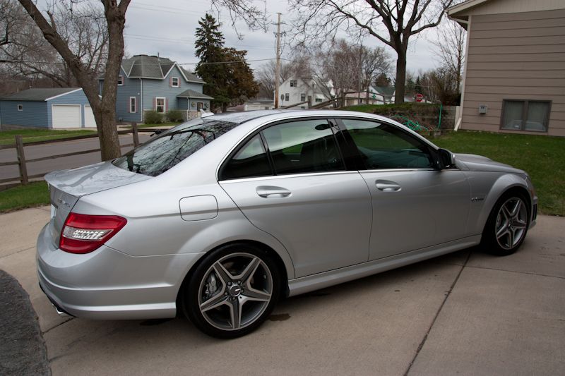

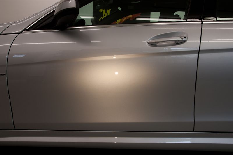

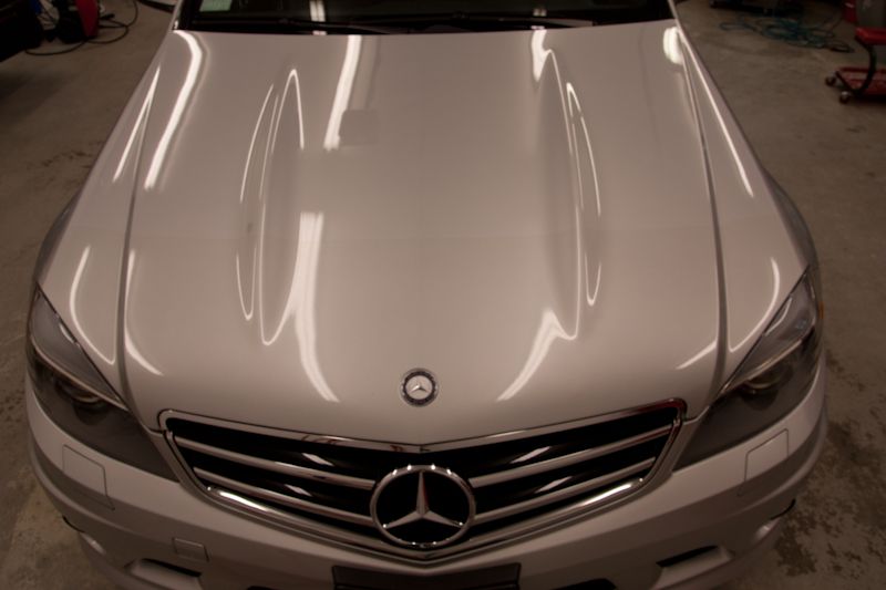

2008 C63 paint correction and clear bra removal

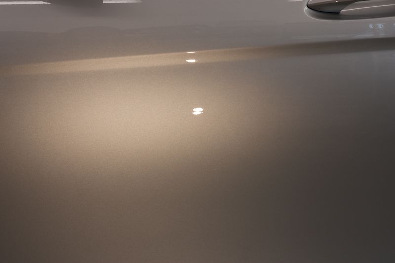

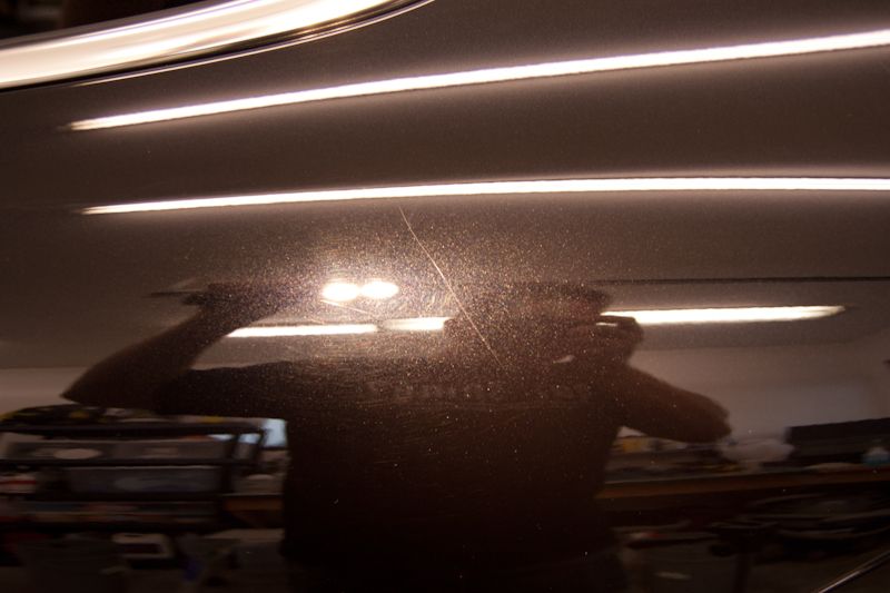

Client recently purchased this car and wanted to get it looking new again. The clear bra was yellowed and detracted from the cars appearance so we decided to remove it as well. The paint was in average condition for the year with moderate swirls and a few RIDS. The color made it very difficult to capture defects so you’ll have to take my word for it on the before condition. ;)
Process:
Wash - Foam bath with Chemical Guys Citrus Wash
Wheels – Sonax Full Effect Wheel Cleaner using various brushes.
Tires – Optimum Power Clean
Chrome tips – Optimum Metal polish and #0000 steel wool
Paint correction step 1 – Meguiar’s M105 via rotary polisher and LC PFW pads
Paint correction step 2 – Meguiars M105 via DA polisher and tangerine LC pads
Paint correction step 3 – Menzerna 106fa via rotary polisher and crimson LC pads
Paint protection – Blackfire Wet Diamond
Tires – Meguiar’s Hyper Dressing at 3:1
Wheels – Sealed with Optimum Opti-Seal
Glass – Meguiar’s D120

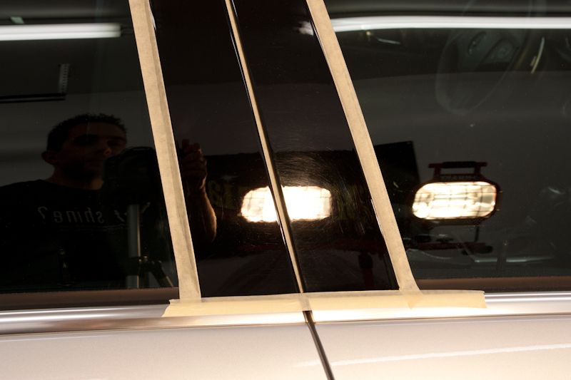

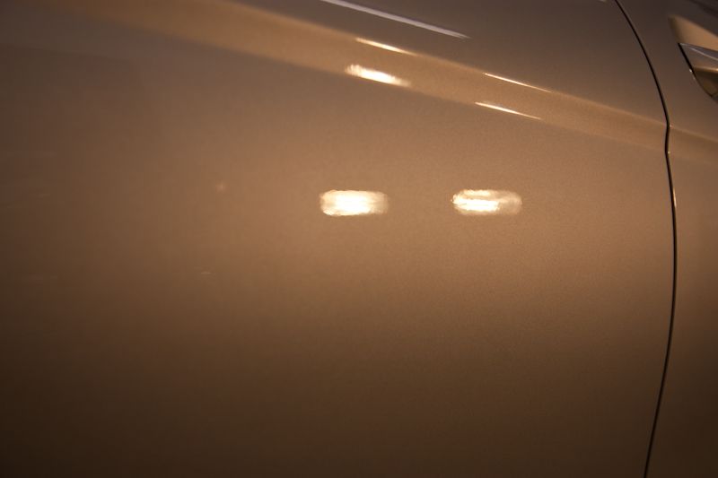

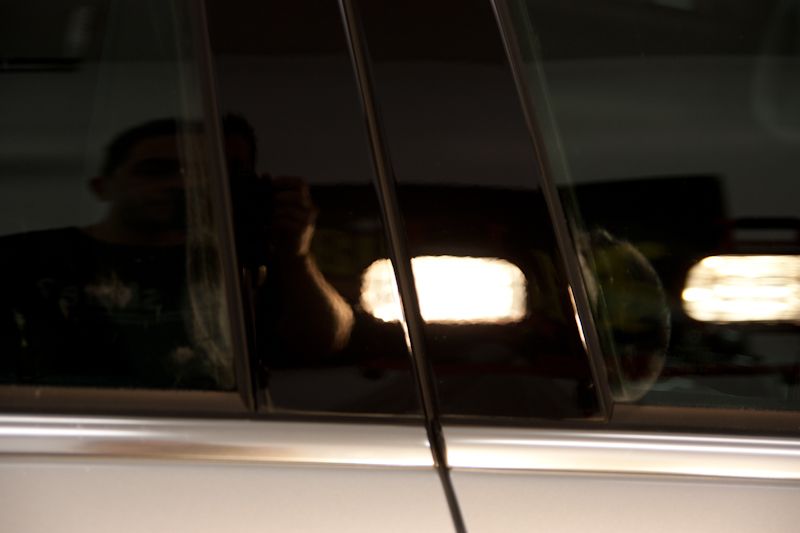

Before pics….(hopefully you can see some of the swirls/marring)

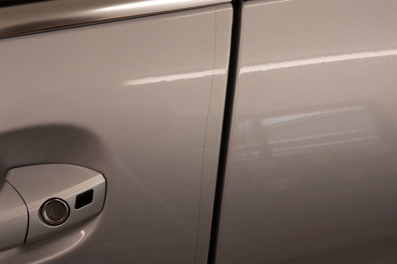

Yellowed Clear Bra
Door edges too….I love clear bra!

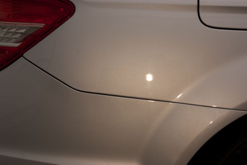

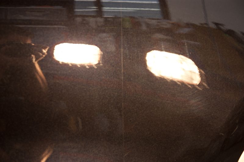

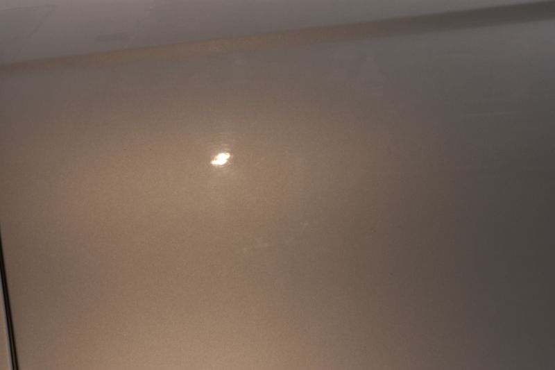

Swirls….

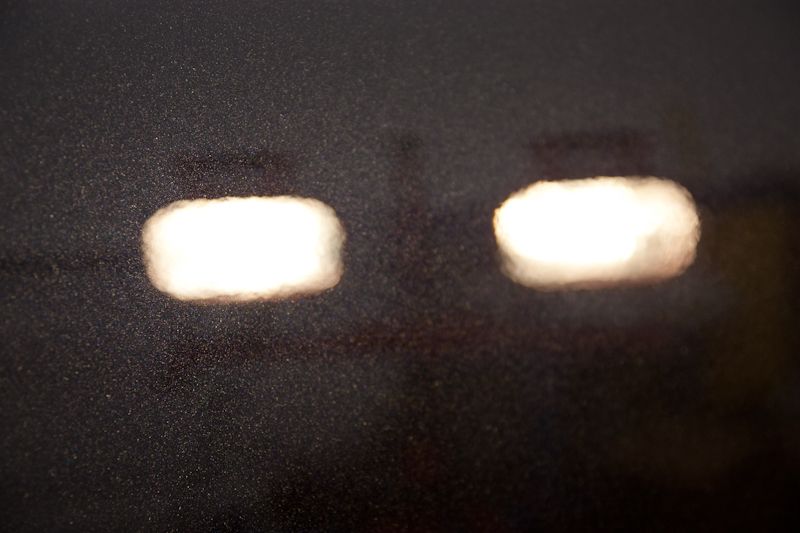

50/50….not that you can see much

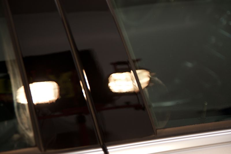

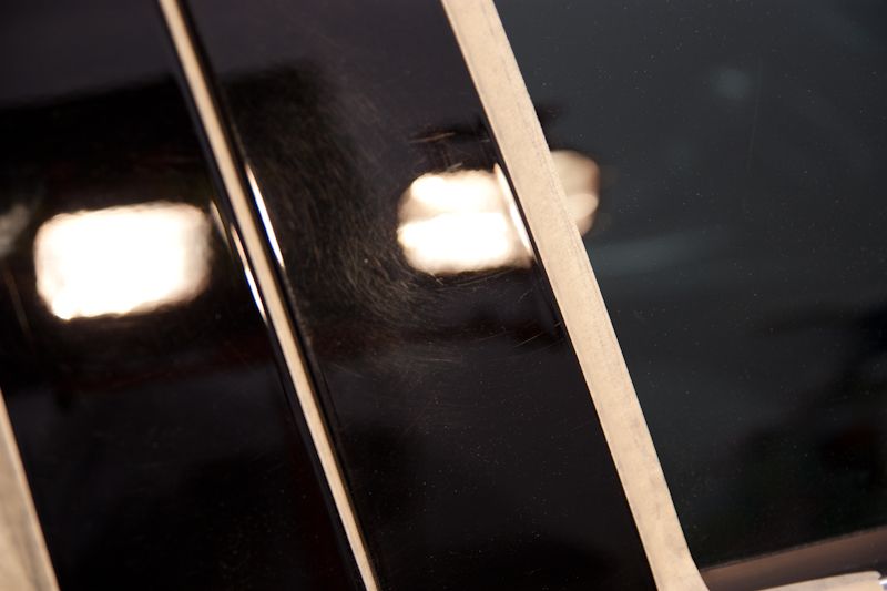

Pillar trim showed the condition better ;)
Trim corrected
