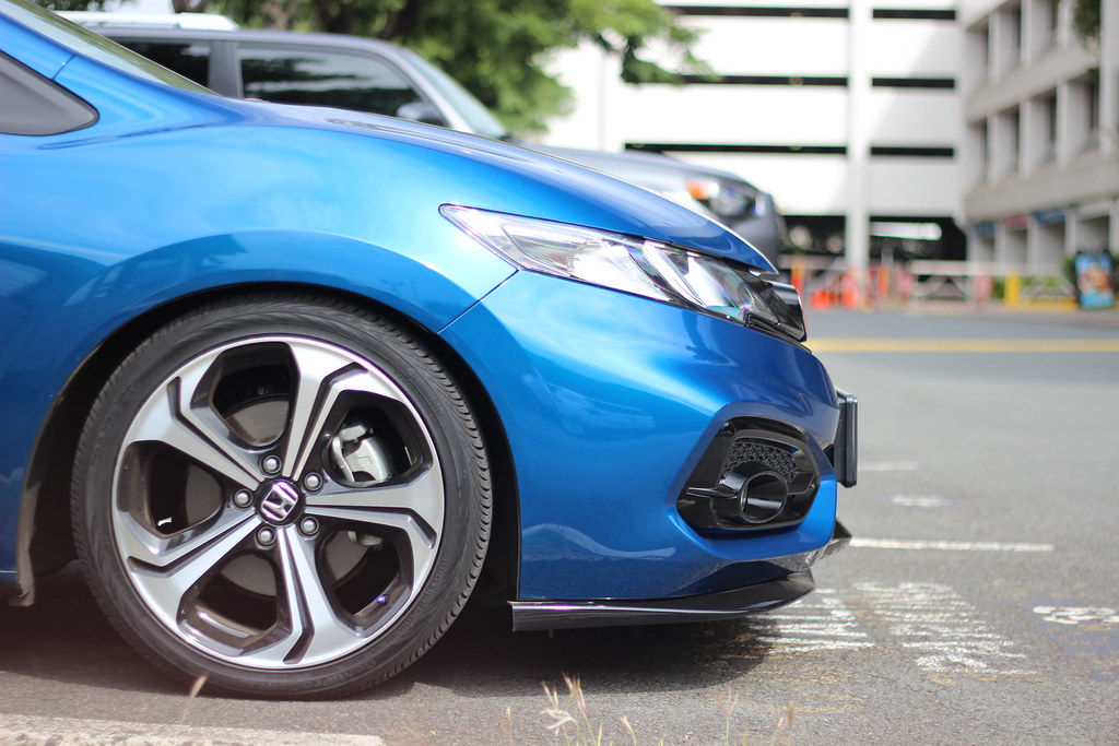

This is the finished product:
My Si by Sebastian Marin, on Flickr
