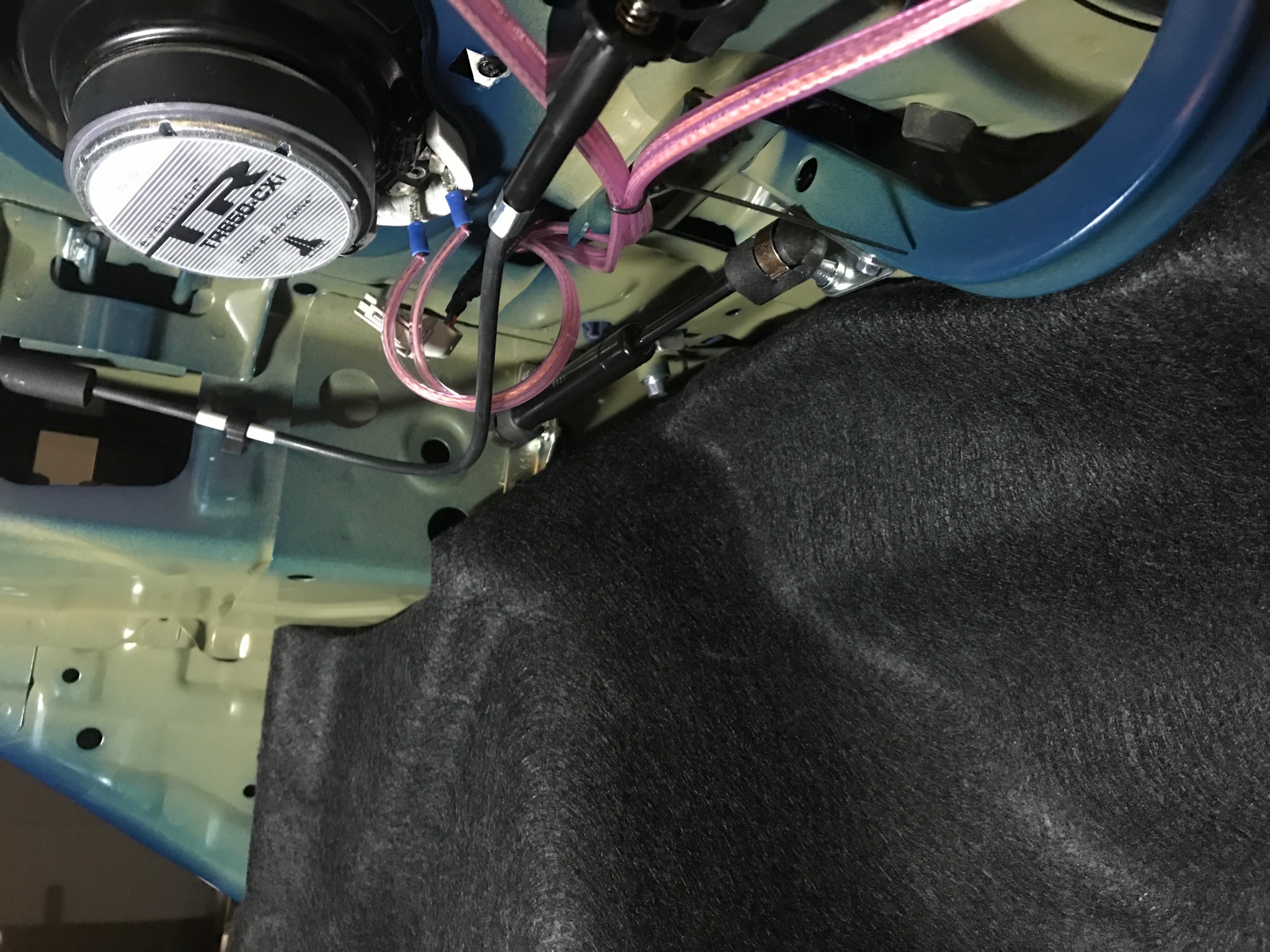

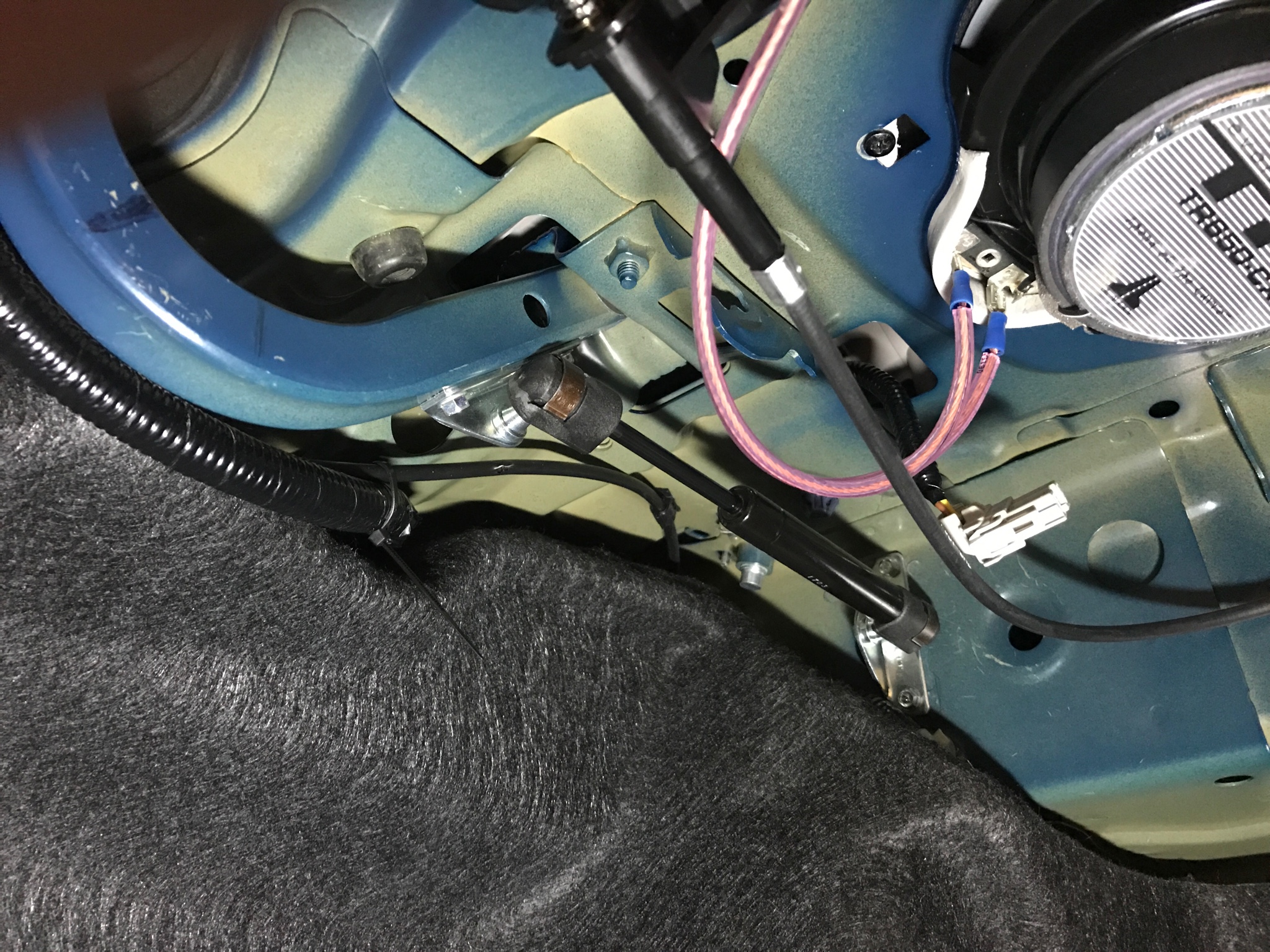

Replaced torsion bars with hood springs

I found some short lift supports at McMaster Carr, they are only 6" long and have 40lbs of force. They don't lift the trunk, but they hold it open and snug right up under the rear deck.
I order some different supports last night, 60 & 80lbs, want to see if they will lift it. I'll give an up date when I get them. I'll also get the part number and add them.
I bet the 80 would work for people using aftermarket spoilers.

It is the same part number for all, just select the size (lbs) you want. I did install two. One each side. And I didn't cut any liner just folded it under.

I just got 60 & 80lbs supports in mail. The 60 hold more firmly, but still let the truck fall if not full open. The 80lb hold the lid open til about half, then it will fall shut. I'm leaving the 80 installed. And yes the torsion bars are hard to get out. I used the handle of my channel locks. There's a lot of tension.
Another nice thing about this, it only cost $36 and took less than an hour.
