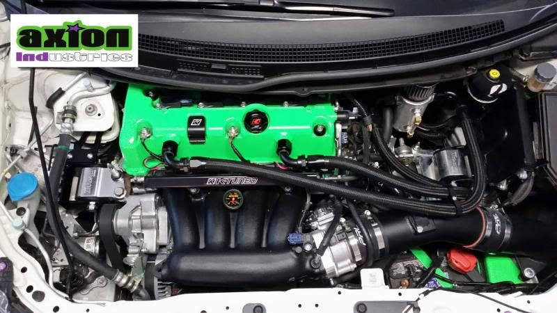

We did it on this motor 3 years ago with our CU2 TSX and had good numbers so swapped it onto our 9th gen. Making 50whp over stock on E85 with great results. Honda however has discontinued selling the RRC manifold but we can do a ported RBC which should give better results. Just waiting on our first manifold back from the machine shop so its all port matched for the larger K24Z head
We will be selling the ported RBC which will allow for the ZDX tb and all runner will be port matched for $460, that is the manifold and all porting.. You would need the adapter kit we sell at $134.95 and need stock injector adapters or injectors... we do it all
