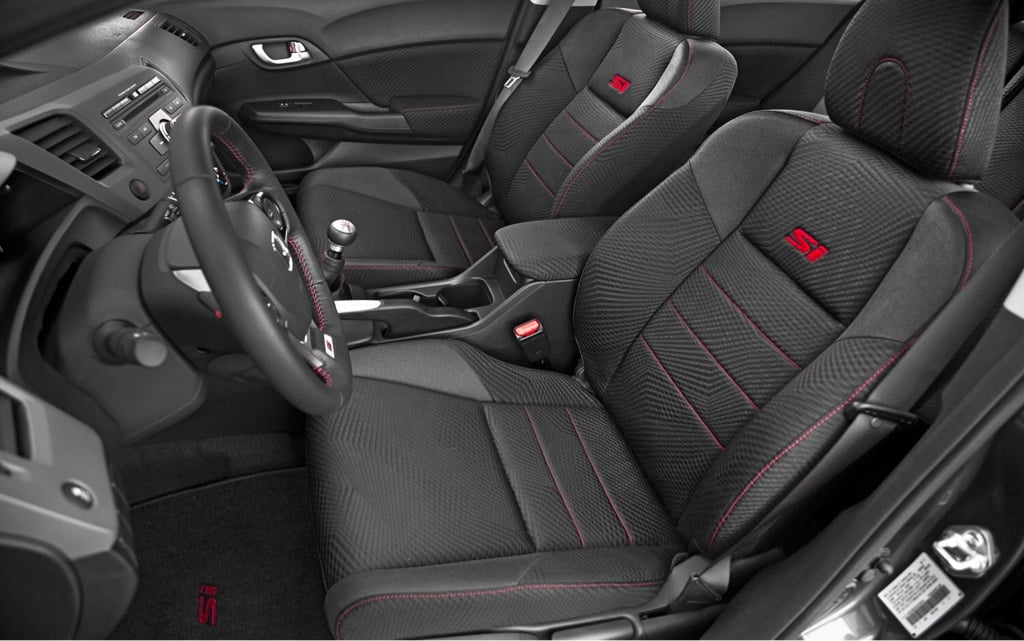

I have a 13 si with black seats and I have a friend that has a 15 si with red/black seats. We are looking into trading seats but I know a airbag light will pop up. I heard you can bypass it, is that true? Also I seen that you can just remove the seat cover itself. I don't want to go through adding resistors if it's that complicated and risking of messing up the system.

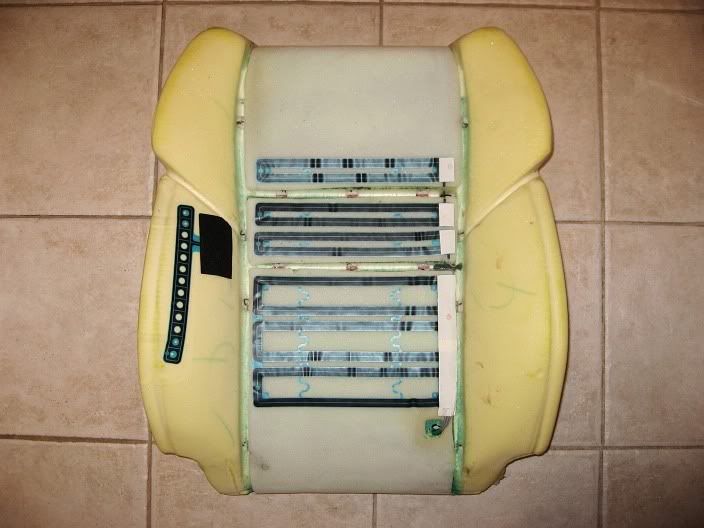

The 06-11 Civic and 04-08 TSX had the same OPDS sensors. You could buy a used seat out of a wrecked car and plug it in to trick/bypass the system but I suspect since the seats are both fairly new you should not have any issues. Here is what the passenger seat has in it:
